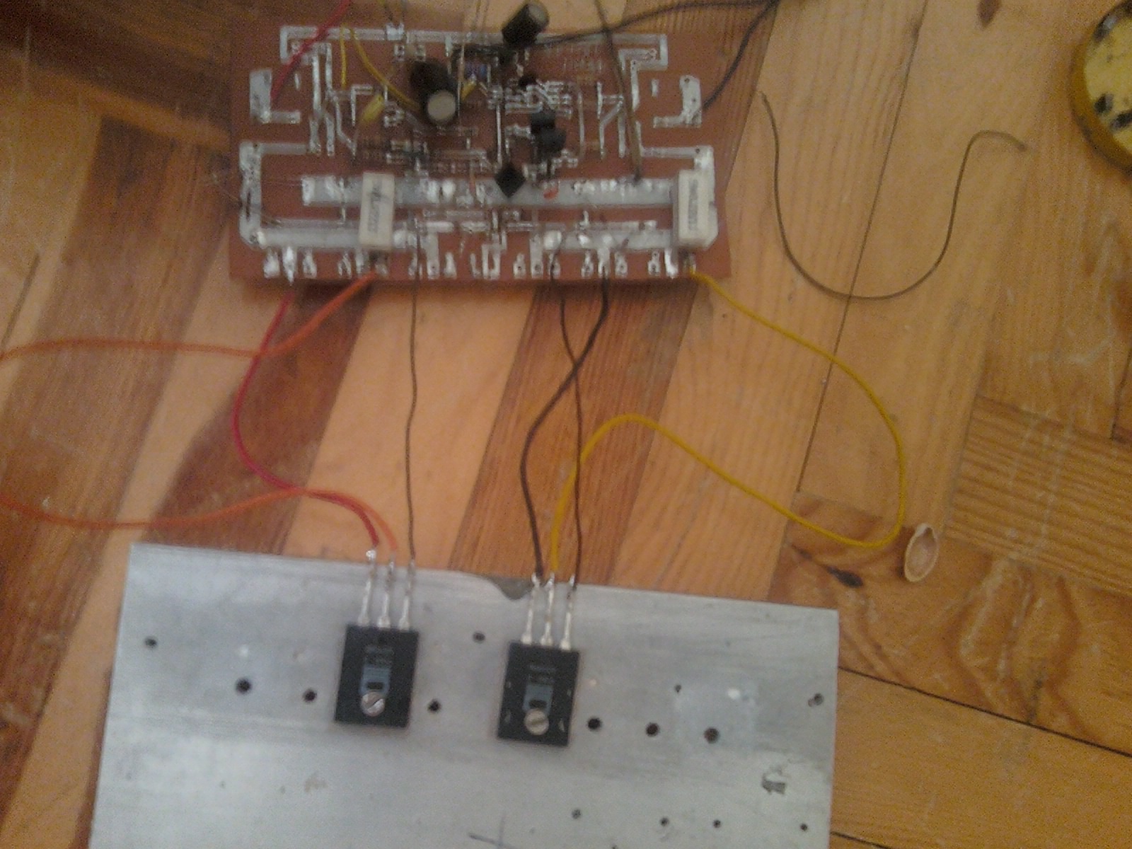

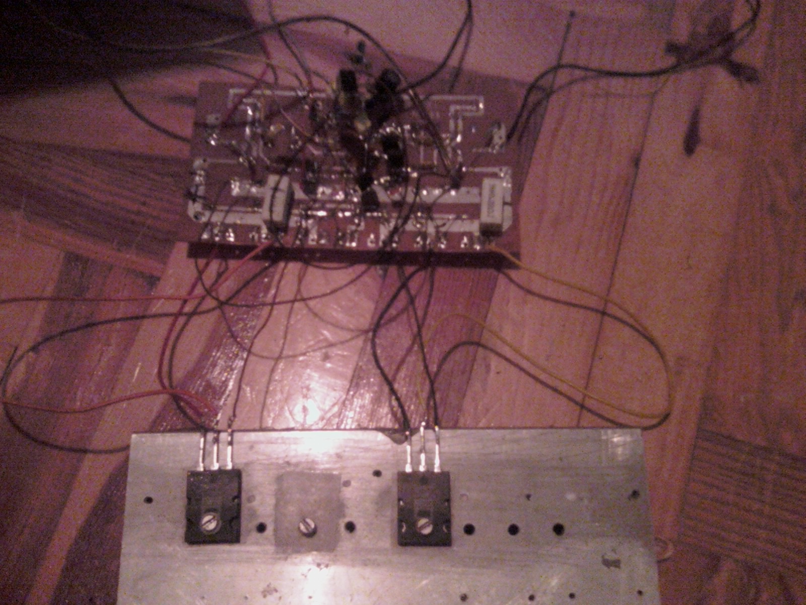

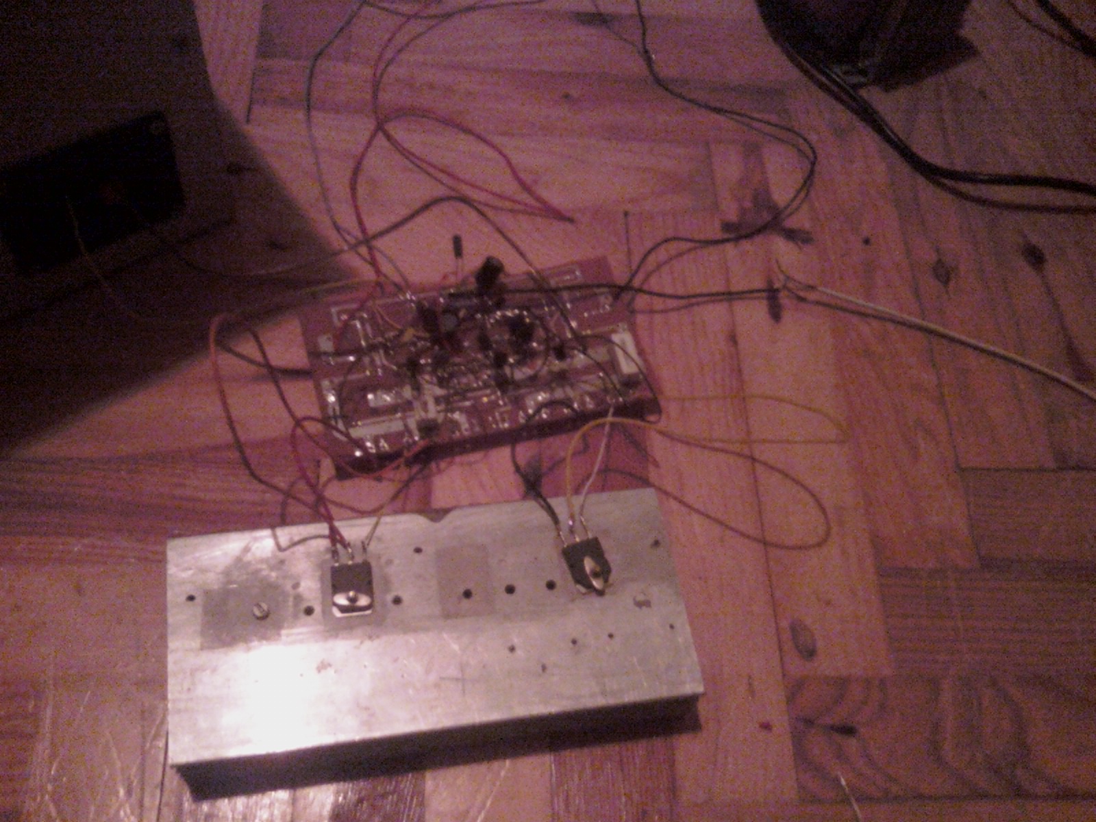

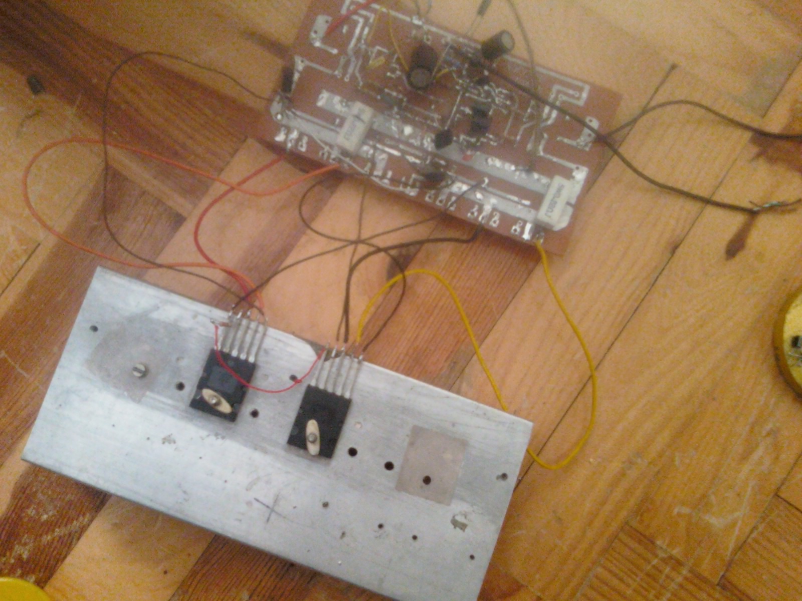

new diy amp

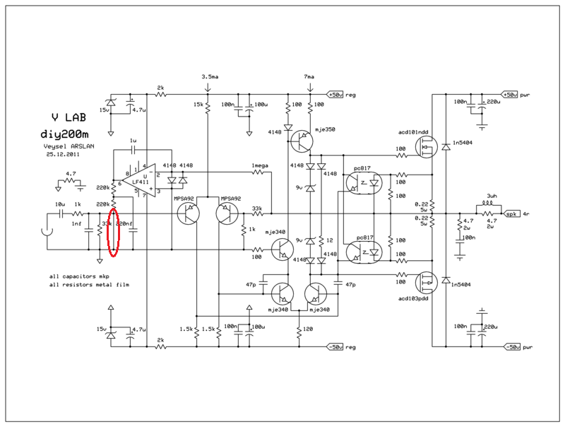

.....realy nothing special , I have seen many times this schematic 🙂 and acording to schematic this amplifier it's mute 😱 se schematic in red ....
Thanks anyway for sharing .
