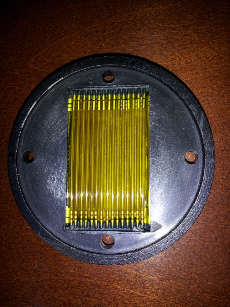

Pulled apart my rt4001's a week ago, looking to see what would be required to make them Dipole. OK simple enough to do, but noticed that they use an adhesive to mount the ribbon at the top and bottom. This looks identical externally to the AMT2-4, slightly different specs. Most certainly is a limitation and raises Fs. This is a shame as the even larger ones would work well a bit lower.
Can think of several better ways to support without causing undue harm to the sound and lowering the low end resonance. Will add that with AMT's this is not nearly as bad as with other ribbon, dome and cone tweeters. Cross mine @2.2k LR4. Best would be about an octave higher. CSD's are fast!!!
Here's a closeup of the adhesive...

Do need to add one comment. Quality Control is a bit lacking. One star off as John Krutke would say.
The ribbon shown is the one with issues. Impedance is off, >10% higher eg 3.2Ω vs 3.71Ω. Sounds good, have more testing todo. Have heard similar reports elsewhere about this issue.

Most possibly caused by a short between two or more folds, but when playing the movement of the diaphragm may cause it to "un-short" intermittent or it can be your ohm meter that puts out a DC voltage so the diaphragm move and creates the short. Try to measure with the opposite polarity - then the diaphragm folds will move the opposite way....
No short. Looks more like an issue with the conductive coating thickness consistency. Have seen a few others post about this Re issue also. Some post on PE forum (i believe) saw where another had similar issue almost to a tee, wished he had bought 3 or 4 instead, tho sounded fine (to his ear). Mine sound different to me and by measurement. Could have been diaphragms from two different batches, use up all the prototypes, toss in a bin. That's where the old addage "Waste not, Want not" comes into direct contradiction with given specifications and profitability > pssst the DIY crowd won't notice if we pawn off some crap.Most possibly caused by a short between two or more folds, but when playing the movement of the diaphragm may cause it to "un-short" intermittent or it can be your ohm meter that puts out a DC voltage so the diaphragm move and creates the short. Try to measure with the opposite polarity - then the diaphragm folds will move the opposite way....

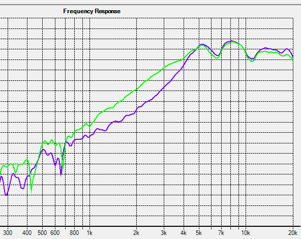

RE: Mini 8? Yes: FR looks pretty rough...
I think that's 5 db per box...
