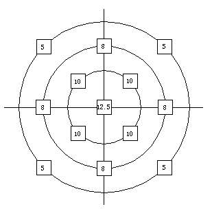

One reason is the lens map diagram which is something like this and shows the strenth of the lens according to the object being projected on the screen.I know that you will say that this is fixed long time ago with the new lenses but not with the ones we use!!
The second reason is the power output which is bigger in the middle just because the diastance compared to the sides is shorter.I know we can not get a 15" triplet 🙂 but thats how hotspots and staff would be eliminated.

When a 65mm objective is analyzing a 15" panel with 390mm FL combining with the right fresnel,the image will be without geometrical distorsions,it will be focused well but it will not be 100% because of 2 reasons.
