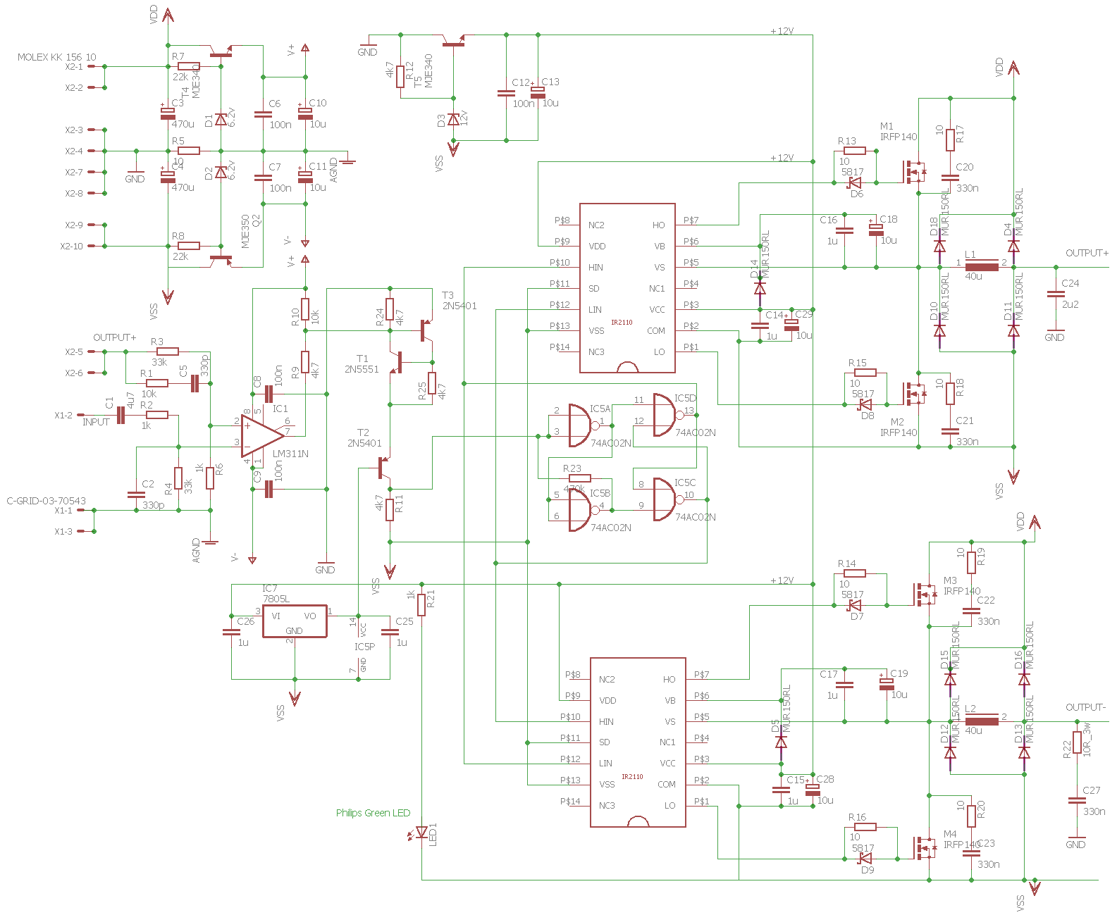

I can see ways to sidestep the Philips UCD patent. It's a narrow patent. It does not cover bridged amps, for example. It does not cover using a comparator instead of an amplifier at input. You could say they are an obvious extension, but then I could say the Philips patent is obvious too. Just a silly oscillator with AM modulation thrown in. Any radio amateur could have built it years ago.
I of course would never take on a giant Philips, but a big player could using variations like I listed. Full employment for lawyers, that's the outcome.
For instance, does the following bridged design infringe? It uses a bridged output, the and the opposite phase is not in the feedback loop. Those are major differences. This design is hereby in public domain, haha.
In contrary, it is a very broad patent. The logic behind patent claims: The less feature is specified the more case it covers. No need for mentioning bridge or any specific parts over the extreme minimum. Every derivatives are included in the main claims. Additive protection can be achieved by specifying sub-claims, but it is not really neccessary.
The main claims covers any self-oscillating ClassD amp that contains post-filter feedback, and (essentially) free of hysteresis. No specialisation, combination or additional circuitry can discard the infringement if the main claims are fulfilled.
Comparator is a differential amplifier. No need for mentioning this in a patent.
Nothing is obvious unless it is written somewhere, or there is any other way to convince the court when you attack the patent... Extension is not exclusion.
Saying silly doesnt tell anything about UcD.
Did they? Show documents!
But it is absolutely not an AM modulator. If you think there is any relevant common feature with an AM modulator, then you don't understand anything about UcD.
You shouldnt search for difference from the schematic, which is only an intentionally simplified example. You must search for differences from the claims. If the claims are not fulfiled, then no infringement. Otherwise yes.
