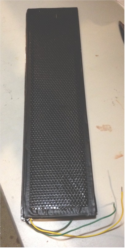

Nearfield Desktop ESL's is right up my ally!!!
I have been designing these type of ESL's on and off for the last 10 years.
Here are a few threads on my designs and the latest one (using TIG rod) is setup for electrical segmentation although I have not tested it yet.
My First set used a very simple and cheap method using plain ole' window screen and it impressed me so much that I have stuck with this design since I started in this hobby in 1994.
http://www.esldiy.com/index.php?topic=11.msg30#msg30
http://www.esldiy.com/index.php?topic=95.msg169#msg169
I have yet to build a large ESL but it is on my things to do soon.
I plan on starting a new tutorial on my method of using window screen soon as I have refined that method since the very first models I made back in 1994.

The width of the panel for a non-segmented stator determines the horizontal dispersion as I explain in the segmented version thread.
The diaphragm width of my ESL's is typically about 3".
This gives me approximately 15 to 30 degrees of dispersion from off each side of the center.
This is enough for nearfield and works great in the Farfield axis as you can imagine too.
Much Much better than my original 8" X 22" panels did.
Although the wider panel did give a nicer low end extension, The beaming was atrocious compared to the little panels.
This was okay since I was planning for a hybrid system anyhow.

Displacement is the key to low end performance as mentioned by Syborg increasing the Excursion and/or increasing the surface area.
The D/S I used on my first builds was about .075" or so and it worked well.
My new build is set at 1.85 and I will be experimenting with that once I get around to testing it.
Therefore a D/S spacing of 1.5mm to 2 mm is a good starting point for frequency's that low using a narrow panel.
If you want a wider panel such as 8" or so then be prepared to go as high as 3/32" (.090" or 2mm to 3.5mm), YMMV !! 😉
As you halve the frequency the Diaphragm requires 4 times the excursion to maintain the same SPL.
The larger the D/S is you need to compensate this by using higher voltages.
Every thing is a compromise!!

I use heat to tension my diaphragms and it works well for the smaller widths but can be a bit difficult to get enough tension if you plan on a wider panel, but it is possible.
It is the only method I use at the moment.
I can get a consistent resonance of about 70Hz to 90hz when I replace a diaphragm.

The second set of panels I ever built were a small 4" x 18" size, perf metal, flat set (see photo). The resonant frequency of the panel was 127Hz, so I crossed it over at 360Hz to good effect. With a d/s of 0.063 and a bias of 2.7KV it worked well for a small monitor set, but wasn't quite what I wanted for a main set. I'm not as adventurous as Jer with the bias voltages, but ran this one up to about 4.5KV before seeing some corona discharge.
In your case, for a desktop set, they would be great. Charlie's page has everything you need to know to make a perf metal panel like this.

The mesh route is interesting, alot cheaper too. Perhaps though it would need some form of bracing as the mesh is very flexible.
Syborg, I really like you're design. Especially because it can be made without the help of the more advanced crafting tools that are usually needed and still maintain high build precision.
I am just wondering about the insulation of the TIG rods. I understand you only coat them with spray paint?
I am thinking about a design similar as yours, but I would prefer a voltage bias of the diafragm of up to 7500 V, and insulation the TIG rods by wrapping them with PTFE tape. What do you think about that?

If you are going to use the mesh design, the egg crate stuff works great for the smaller widths.
I too had bowing issues with my larger 8" wide versions and SyBorg worked that out very nicely using 1/8" steel rod, I never though of that I was going use wood or some thick plastic.
This is the main reason why I never pursued using it for the 12" wide panels I wanted to build and went with the TIG process for my larger panels.
Plus the dispersion issue what had kept me using the narrower panels as well and I just recently learned the how and why's it works so well.
The difference was night and day between the 3" wide panel and the 8" wide one.
I also had them set at the exact same distance and spread away from me.
Because they were much smaller (1/4 the size)surface area was working against me, so, I spent the last 4 years figuring out how to get the absolute most efficiency out of them.
Then I will apply what I have learned to a larger set for when I really want to annoy the neighbors!! He,he,he
