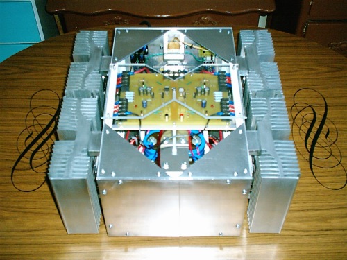

new born aleph 3 need help Dr. Pass
hi
supply = +-25
irfp140n +irf9610 +mpsa18
my new aleph 3 is under test all dc voltage are ok just
change 2 things:
1-my aleph current source was unstable but with 1nF
on mpsa18 base and collector it s rock stable now
2-my bias was 1.7A change R113 for 47.5k + 30k and
now my bias is 2.1A cold and 2.05A hot
first good news 🙂
- very good 200khz @ -3db maybe because my input
stage is 25ma not 20ma ccs
- 10khz square wave test is good just a very small overshoot
bad news :-(
I m lost to check aleph current modulation
-test no 1 :
F=1khz
Vout=45v peak to peak
load = 8ohm power resistor
my scope is on one .47ohm (upper aleph source resistor)
with vout=0 volt on .47 = .5v
with vout=45vpp the voltage swing between .05v and .92v
.92 / .47 = 1.95A x 2 for aleph 3 =3.91A peak
is it normal or normal is 3A or 3.5A or ???
-test no 2:
F=1khz
Vout=45vpp
scope on AC position
650mVPP on rout .1175 (4 x .47)
870mVPP on one upper aleph .47 source resistor
450mVPP on one lower irfp140 .47 source resistor
but no idea what to do for check my 50% modulation
with these voltages
thanks

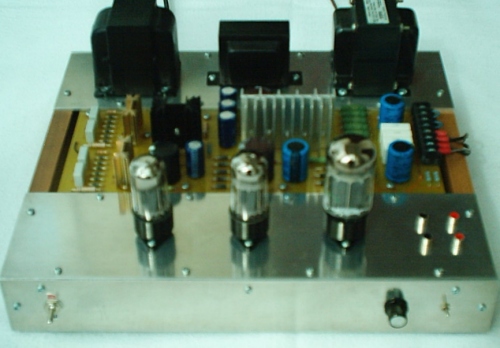

my next step will be to update my tube preamp to lower gain
but do you have a opinion on tube preamp for aleph 3
and for you what is the best preamp , tube or boz or boboz or aleph P or ?

BTW -which tube preamp you use?
--------6SN7 supply=300v bias=5ma transistor ccs load
+6AS7 supply=150v cathode follower for zout=100ohm but i
need to remove the first 6SN7 because the gain is too high
for aleph but the problem with my design is fc -3db is
only 50 khz maybe a boz project for next winter 🙂
