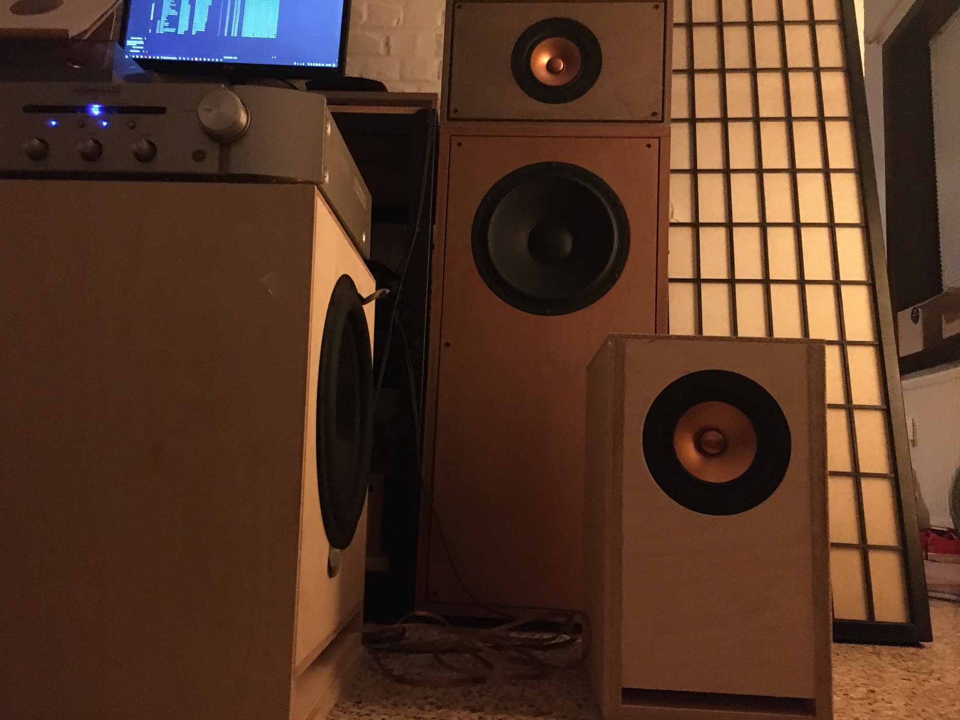

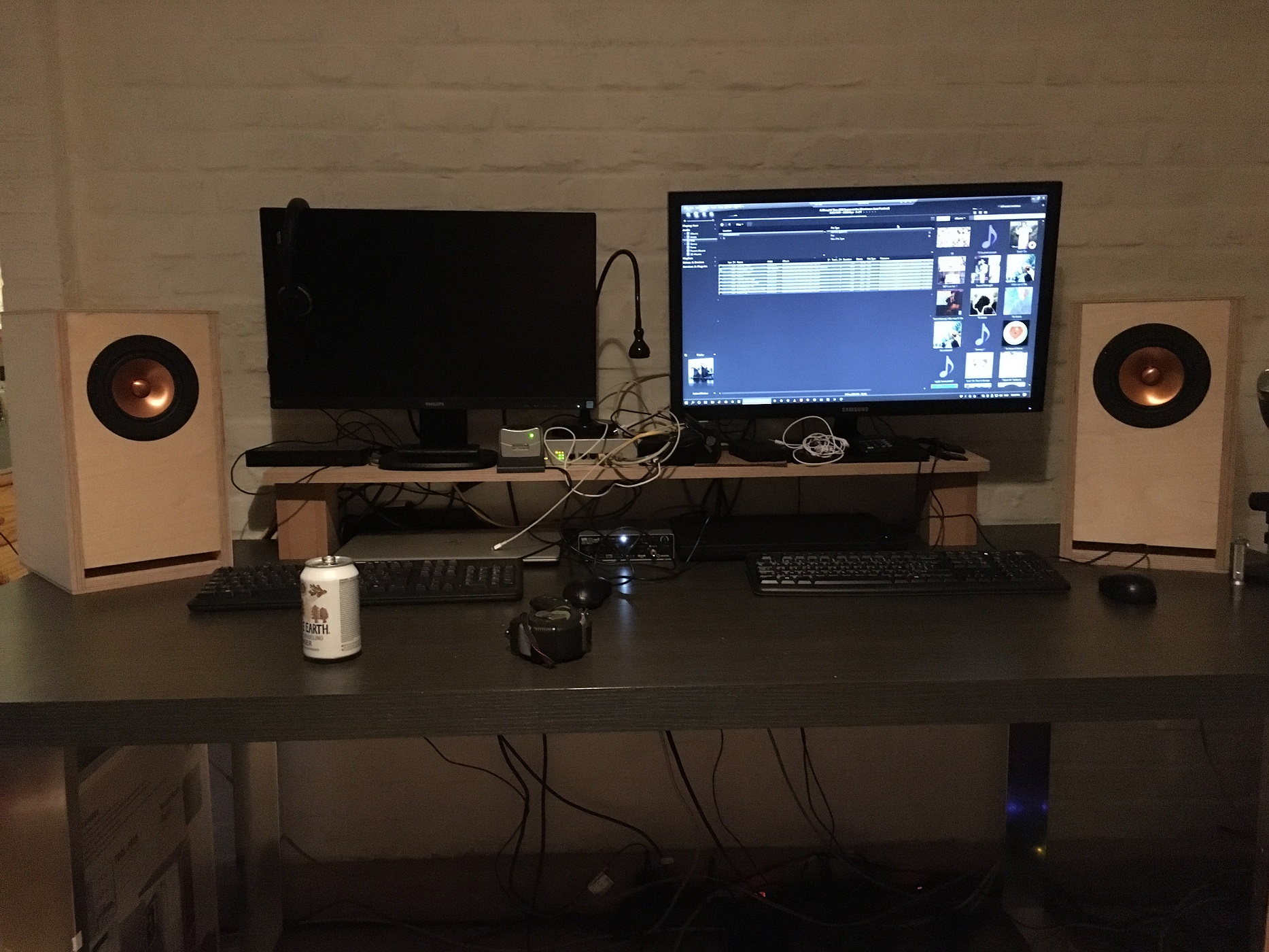

I've moved houses and needed new bookshelfs for my office. I started it as Covid-19 project but got stuck on the lack of wood (also at my suppliers), but finally they are finished... I used Mark Audio Alpair 10M drivers out of an older project that i disregarded (my first build with Mark Audio) as i never listened to them anymore and putted them in a 17.9L ported box tuned to 45Hz and added a little LCR notch filter to flatten the sound in the treble.
I'm very happy with the build that happened this weekend with the help of a friend known here as humbledeer. We did also build a subwoofer at the same time for her setup. She is working on the final cad files of my builds, wich i will publish freely here with all the details. But here is the first picture of my build, still in a raw testing state. Sanding and finishing will happen later after i installed myself fully in this new house because it's still a mess of cardboard boxes...

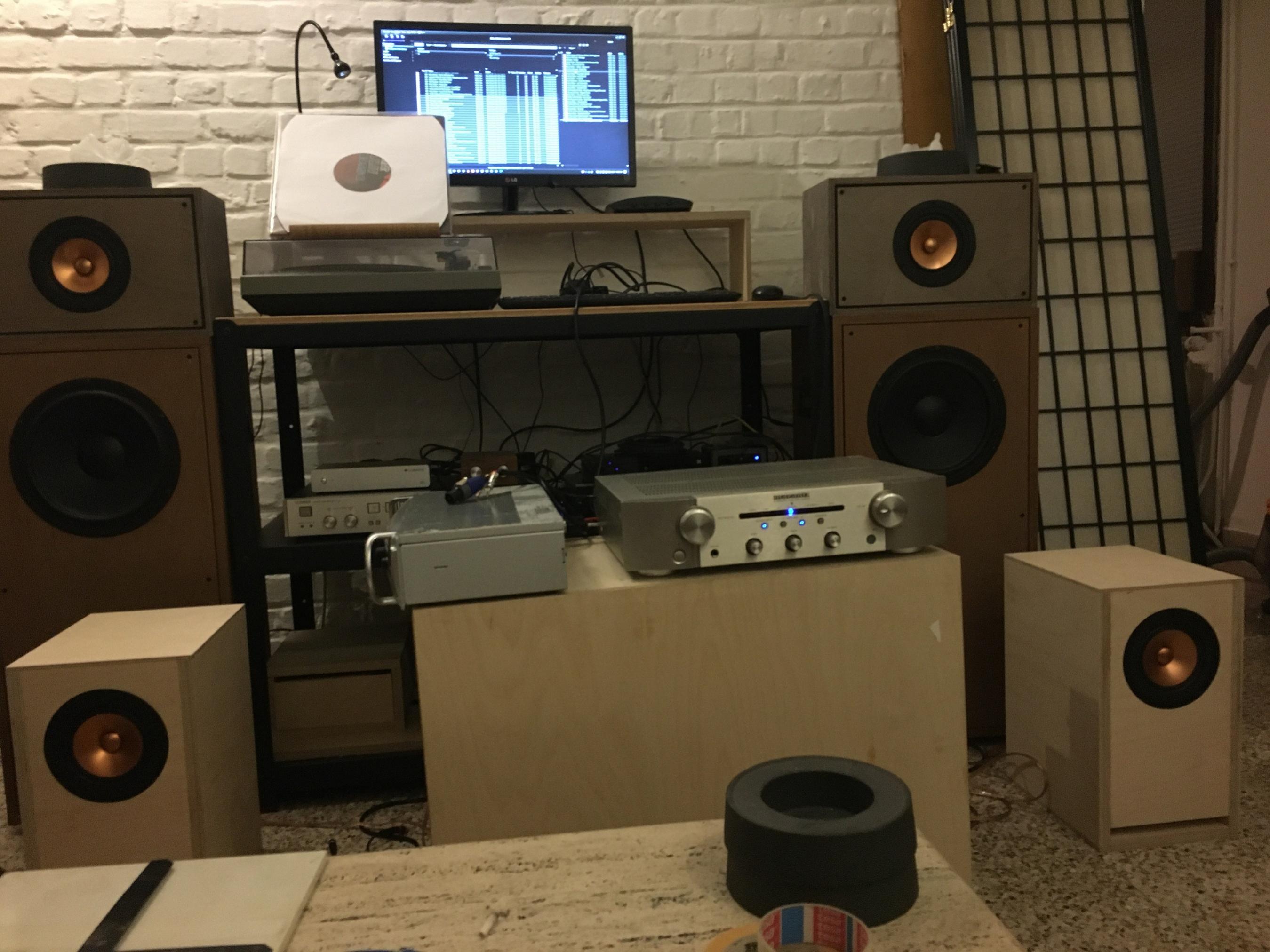

Here are some pretty pictures too.
