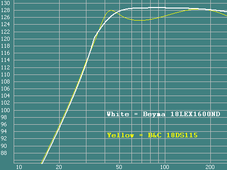

Beyma 18LEX1600ND v B&C 18DS115
Reflex box = 150L - fb = 42Hz - 24dB LR HPF @ 25HZ - Xmax not exceeded
Swings & roundabouts, as usual 😉 Both seem good though ! Price will probably win 😀

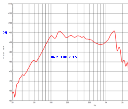

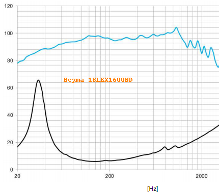

Quoted sensitivities
Beyma 18LEX1600ND - 97 dB - B&C 18DS115 - 98.0 dB - See published graphs though !

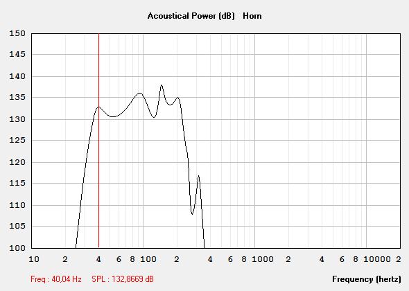

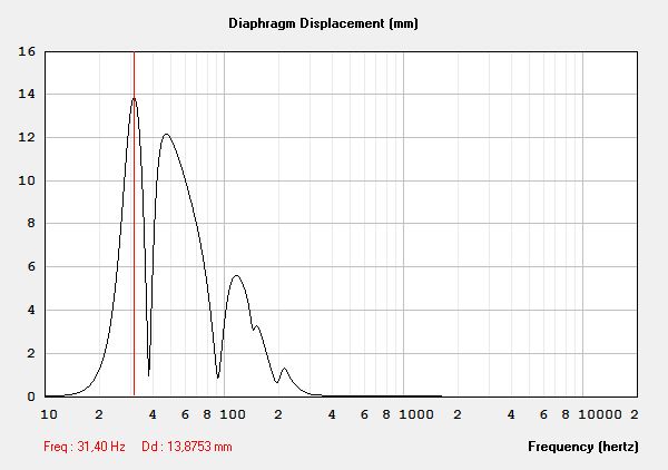

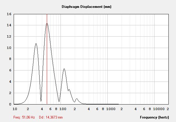

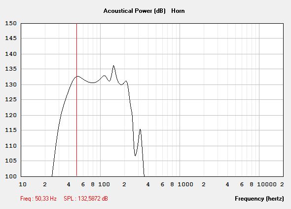

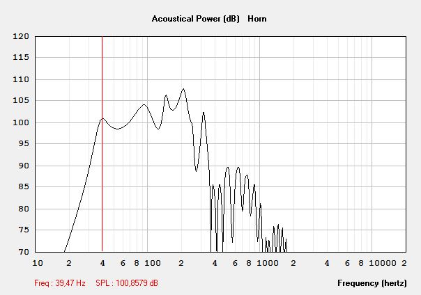

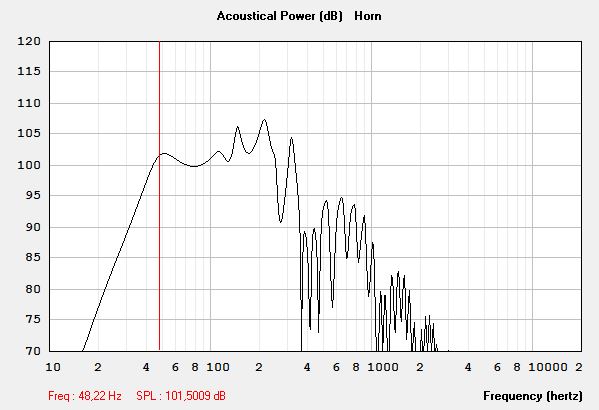

I simmed both drivers in the Xoc th18, Note that I used a 30hz 48db/BW HP and a 180hz 24db/LP on the high power measurements. Also note that I used the full 1700w nominal power handling on the B&C without reaching the xmax of 16.5mm. Is the B&C a good driver for the the Xoc TH18, no. But with a good TH design for the B&C it can be a hell of a horn.
B&C:
1w1m:
1700w @14mm xmax:
1700w diaphragm displacement:
Beyma:
1w1m:
1200w @14.5mm xmax:
1200w diaphragm displacement:
