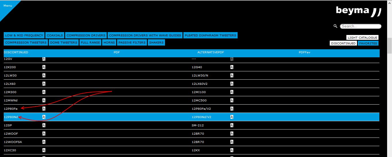

As I continue to look into the 12P80Nd I came across the "new" sign on the Beyma website besides the 12P80Nd/V2. The data sheet notes "preliminary".
The frequency response looks smoother than the V1. The T/S parameters also change. Mms/Bl is 2.6 for the V2 vs. 2.4 for the V1. Maybe a slower driver, but with a more even frequency response?
Anybody knows if this is already available?

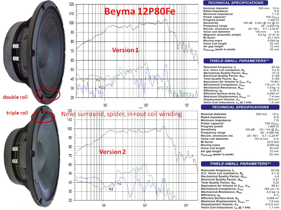

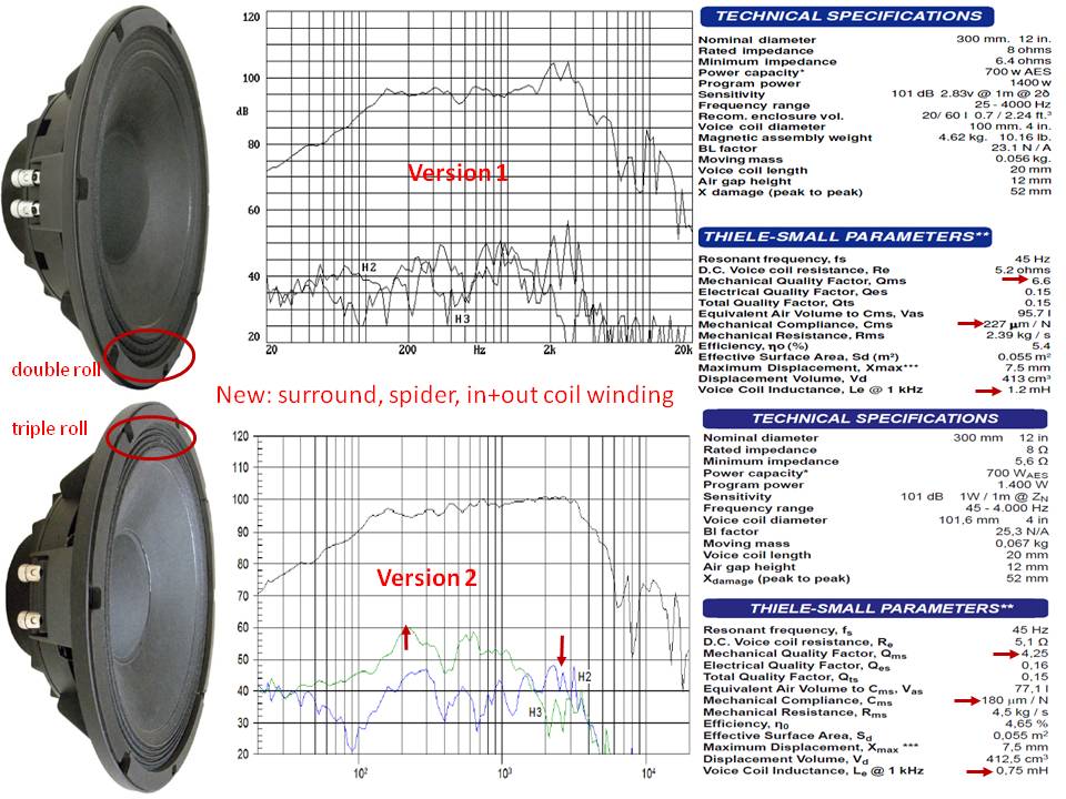

GUESS at: Beyma 12P80Nd changes between version1 vs. version2
New cone surround. Best way to tell V1 vs. V2
1) cone surround: old = double roll(M-roll); new = triple roll
New stiffer suspension spider.
2) Mechanical Compliance(surround + spider): old Cms = 227 um/N; new Cms = 180 um/N
New inside+outside windings on voice coil former
3) Le inductance: old = 1.2mH; new = 0.75mH
4) Bl: old = 23.1; new = 25.3
---V1 cone breakup between 1.6KHz - 3KHz has been removed in V2
---V2 looks like excellent partner for the TPL-150H with LR4@1.6Khz
---V2 has higher distortion 200Hz-500Hz, but lower distortion 2KHz-3KHz

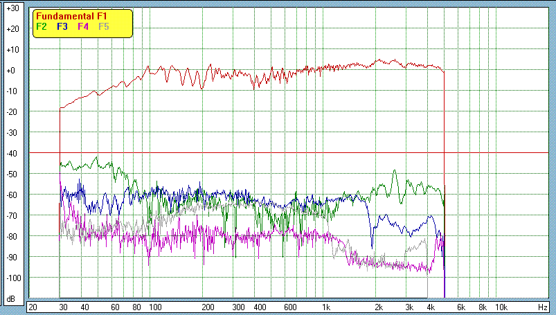

Harmonic distortion below 40db is considered inaudible.
Harmonic distortion above 20db is considered audible.
From the 12P80Nd V2 datasheet, harmonic distortion stays below 35db for the normal usage frequency range.
Audible concerns for harmonic distortion between 20db-40db depend partly on golden-ears and partly on design execution. In the 200-300Hz range a typical 3-way will have a crossover to the woofers and a baffle step compensation circuit which both significantly shape distortion and timbre accuracy. Exceptional crossovers will decide a Gold, Silver, Bronze medal design more than the harmonic distortion bumps.
The Lambda TD12M is often mentioned as having the lowest harmonic distortion for a 12" midbass. The attached measurement data shows at least -50db over the normal usage frequencies.

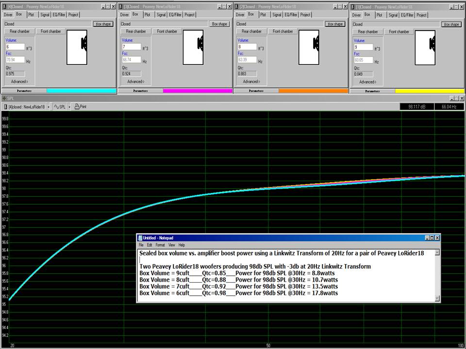

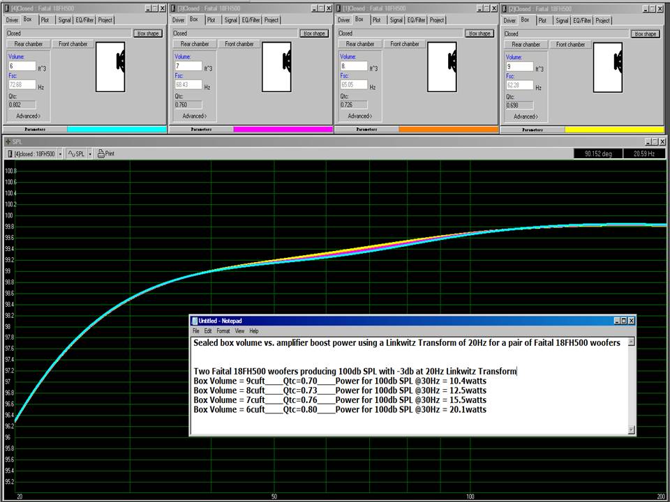

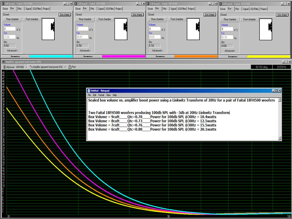

There are very good BMF-1 construction photos on the Tweek Geek website. I still favor using a side-side pair of 18" woofers because of the dynamics and 100db/watt efficiency. The attached table illustrates how the cabinet volume can be changed if higher amplifier power is acceptable. Two 18" side-side woofers can produce 100db SPL 30Hz bass with just 10 watts of power in an 8cuft cabinet. Two 18" side-side woofers can produce 100db SPL 30Hz bass with just 20 watts of power in a more modest 6cuft cabinet. The TPL-150H and Beyma 12P80Nd are designed for high efficiency and dynamics, which requires two 18" woofers to keep up!
Sealed box volume vs. amplifier boost power using a Linkwitz Transform of 20Hz for a pair of Faital 18FH500
Two Peavey Faital 18FH500 woofers producing 100db SPL with -3db at 20Hz Linkwitz Transform
Box Volume = 9cuft____Qtc=0.70___Power for 100db SPL @30Hz = 10.4watts
Box Volume = 8cuft____Qtc=0.73___Power for 100db SPL @30Hz = 12.5watts
Box Volume = 7cuft____Qtc=0.76___Power for 100db SPL @30Hz = 15.5watts
Box Volume = 6cuft____Qtc=0.80___Power for 100db SPL @30Hz = 20.18watts

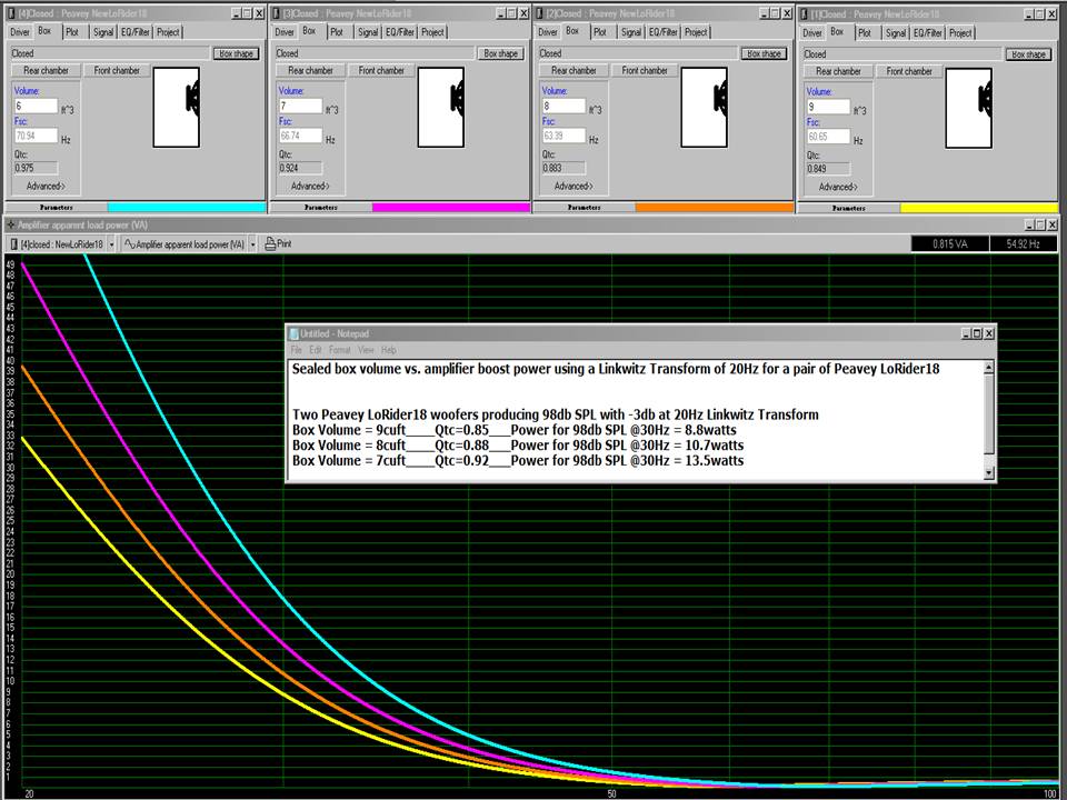

Sealed box volume vs. amplifier boost power using a Linkwitz Transform of 20Hz for a pair of Peavey LoRider18
Two Peavey LoRider18 woofers producing 98db SPL with -3db at 20Hz Linkwitz Transform
Box Volume = 9cuft____Qtc=0.85___Power for 98db SPL @30Hz = 8.8watts
Box Volume = 8cuft____Qtc=0.88___Power for 98db SPL @30Hz = 10.7watts
Box Volume = 7cuft____Qtc=0.92___Power for 98db SPL @30Hz = 13.5watts
Box Volume = 6cuft____Qtc=0.98___Power for 98db SPL @30Hz = 17.8watts

Beyma also released a version2 of the 12P80Fe driver which appears to now have the same new cone, surround, suspension, and voice coil as the version2 of the 12P80Nd driver.
According to the Beyma datasheets, the Nd version has a stronger motor, lower Le voice coil and lower Fs, lower Qts.... The Nd verions also appears to have smoother SPL over the 1kHz-3kHz frequency range which is often important for marriage to a horn-compression_driver or Beyma TPL-150H
A designer will want to simulate both drivers to select the best performance and cost/benefit.
