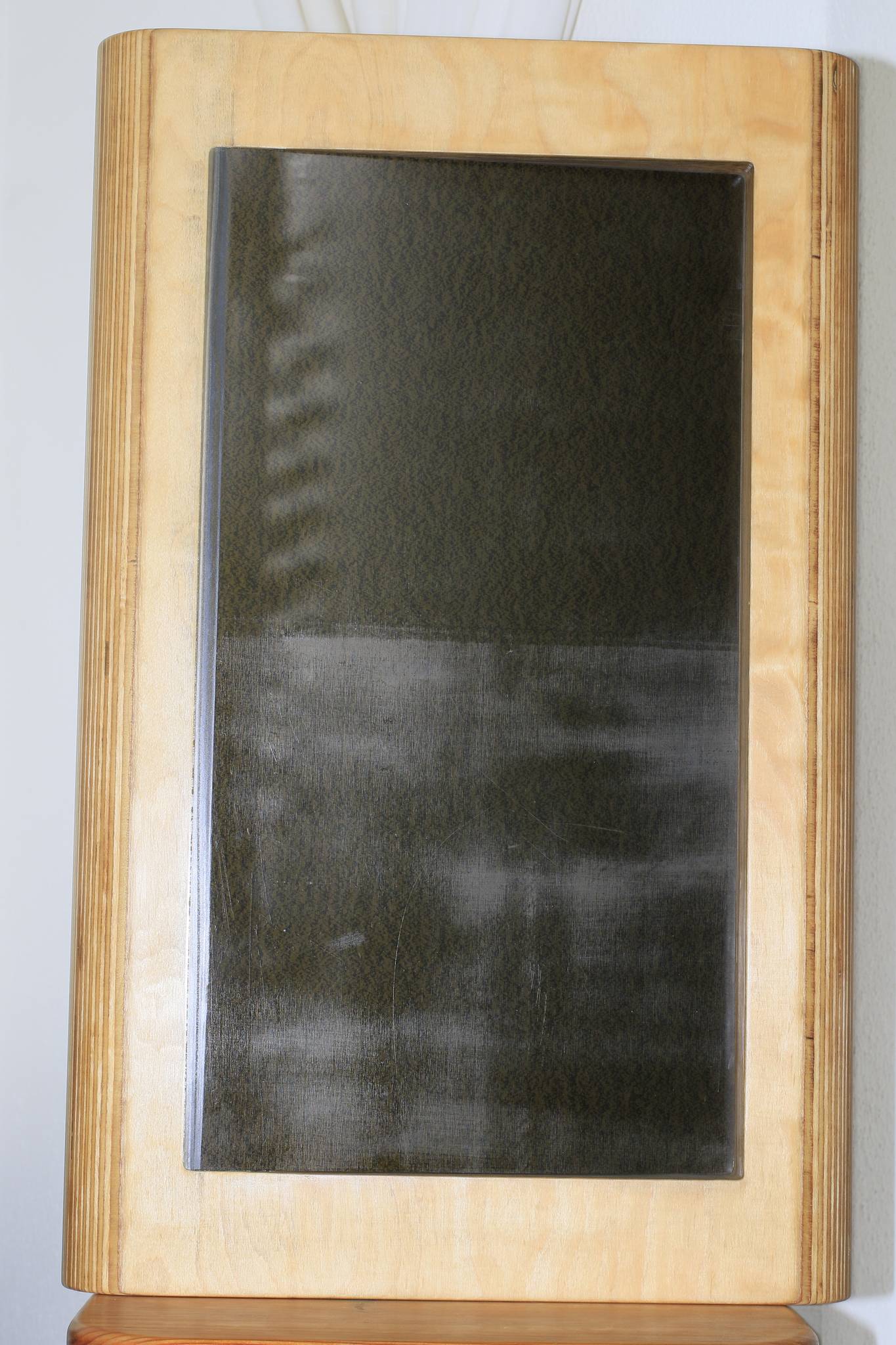

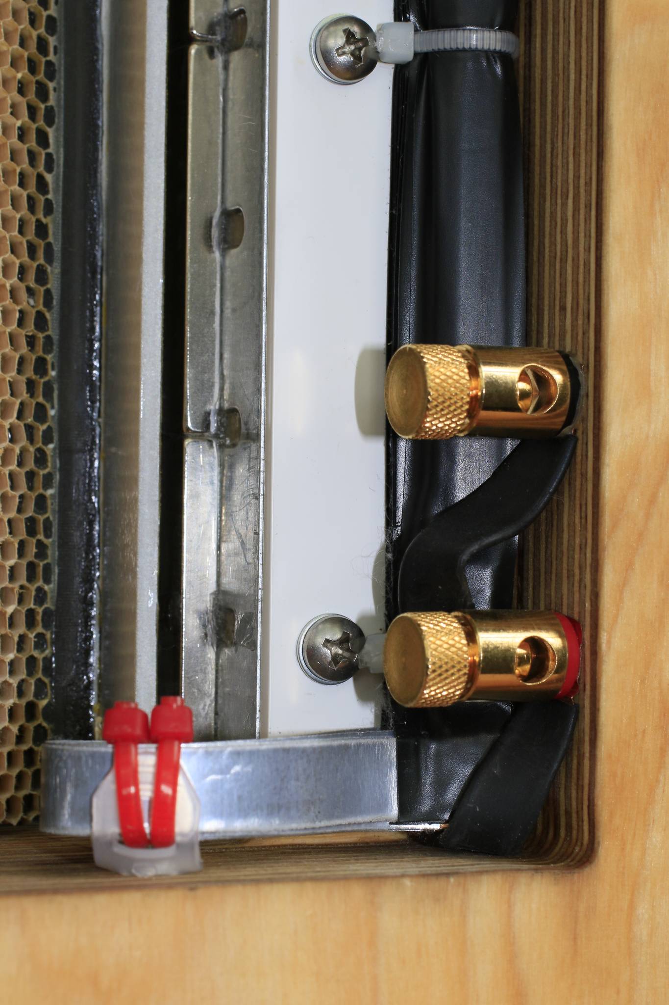

I show here my idea of a flat fullrange bendingwave driver.
I do not follow this path any further since I failed to find a company willingly producing this speaker. This tells something…
I know that a lot of skilled people will reading this. I invite you to discuss about it here, but I am out of power by now. I present my idea “as it is” that others may finding this useful to some extend, or even will continue my work. All text attachments will be only in German, sorry about that.
This voicecoil can be used in other loudspeaker design as well. Voicecoil priority DE 10 2017 004 832.0 is ending 18 May 2018, and a German patent on this loudspeaker will falling by midsummer, so I am not in the way to new implementations. It use the same physics like in piston speakers, but whole design is new and advanced, some will say over the top?

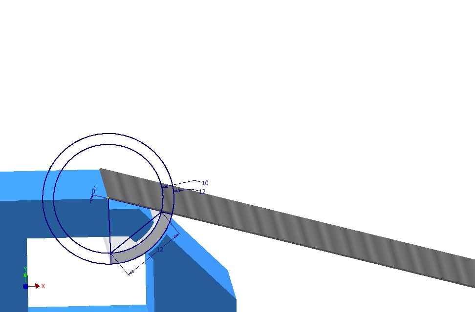

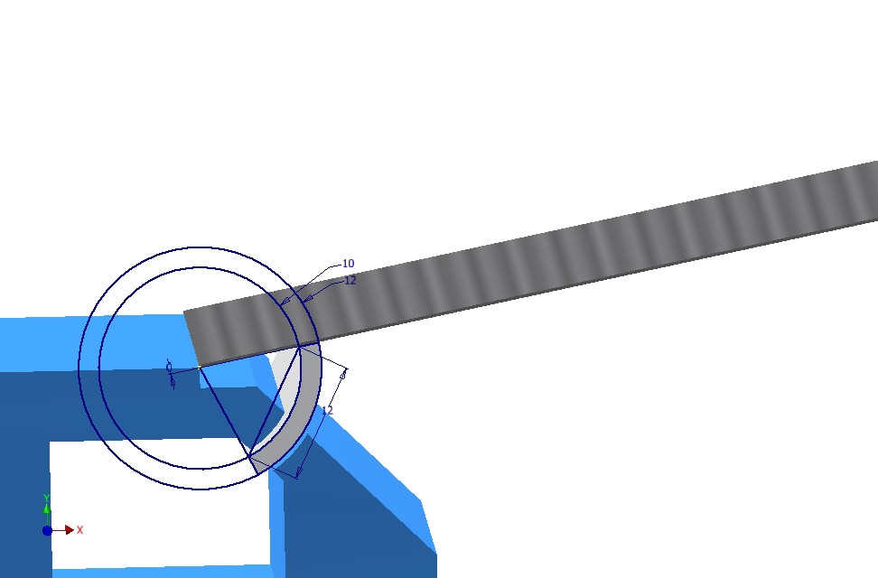

Voicecoil is overhung type, with little to mediocre excursions that will be amplified by membrane lever to big excursions. Voicecoil connection to membrane can be made better, with lots of little cuts to give better adhesion to membrane and prevent currant flow out of magnetic gap. Glue excess has to be removed since dead weight reduces HF response (as in my prototype) Finally, as last trick, additional capacitors lift the upper end above 20kHz.
Here is what I’ve got to contribute:
- design: flat planar speaker, low coincidence frequency
- type of operation: 1-dimensional wave guide, bendingwave and piston like
piston underneath coincidence-frequency, over non reflective bending modes - acoustic properties: linesource, coherent cylindrical wave front
room filling dispersion over 180 degrees horizontal - motor: magnetodynamic actuator, linear voicecoil, flux modulation canceling back currant
opportunity for impedance compensation by capacitors - membrane: ud-CFC laminate sandwich, Nomex honeycomb or polymer-foam,
no surround – as big excursions are expected at low frequency - thermal expansion coefficient: ud-CFC ≈ [FONT=Albany, sans-serif]Al[/FONT]

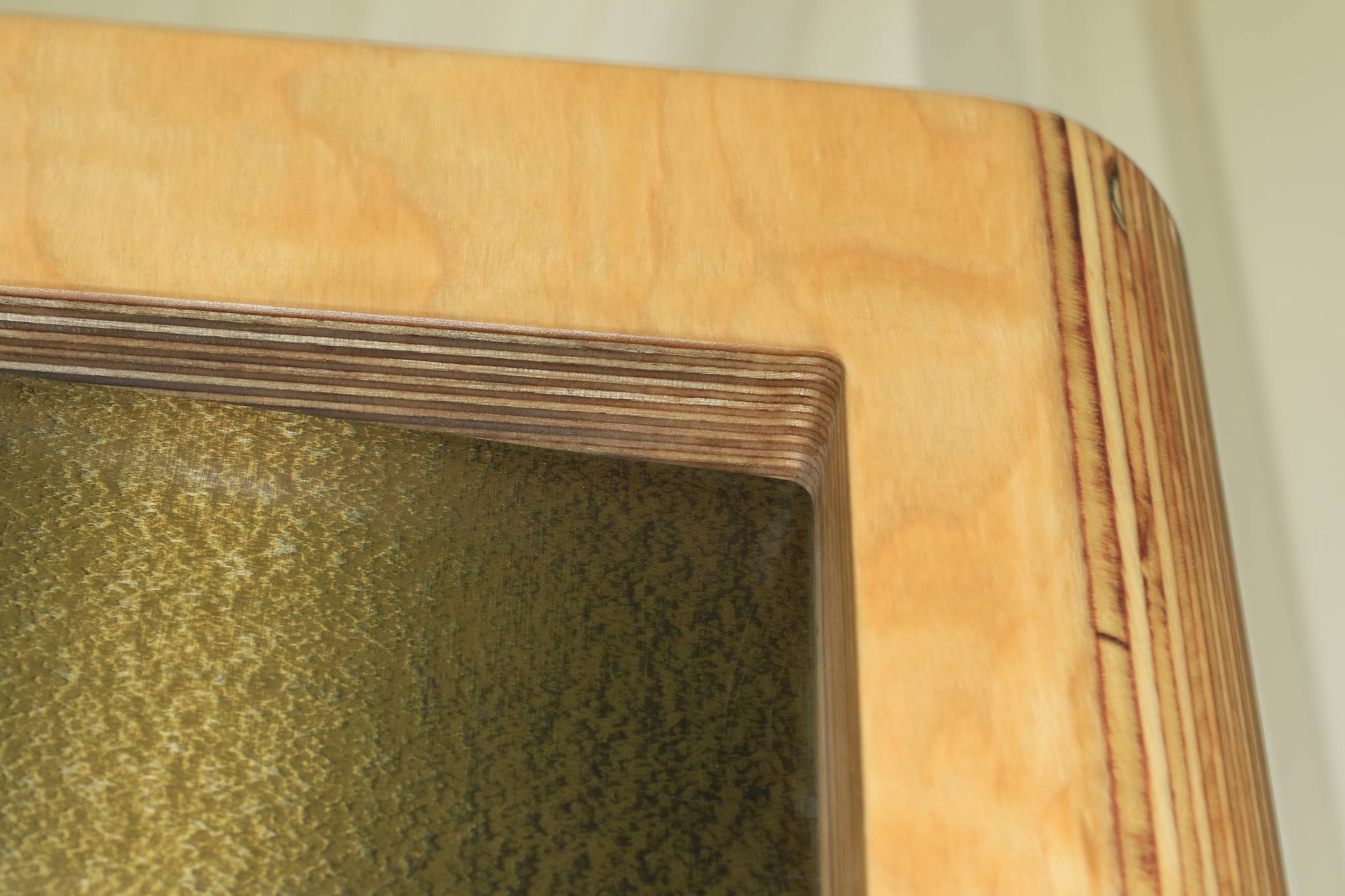

The panel is at frontside to listening room total flat, inside/backwards thickness varies to give stability and to achieve desired FR. The frame got some curves, but not necessarily.

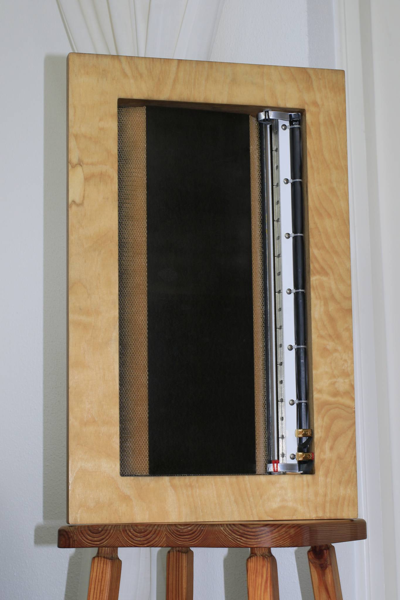

I'm not sure I understand how the motor works?
Looking at the black membrane, it surly looks "curved" given the shadows...? At least at the sides?
Efficiency?

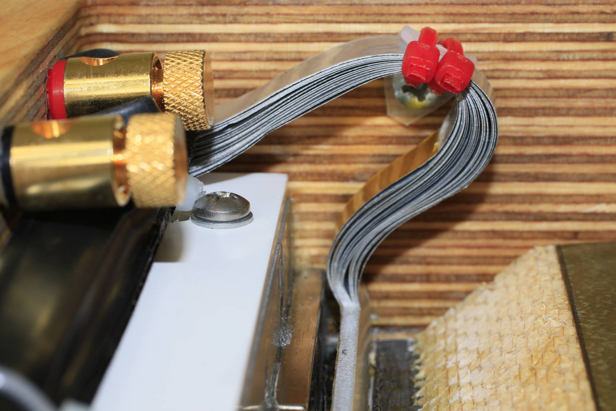

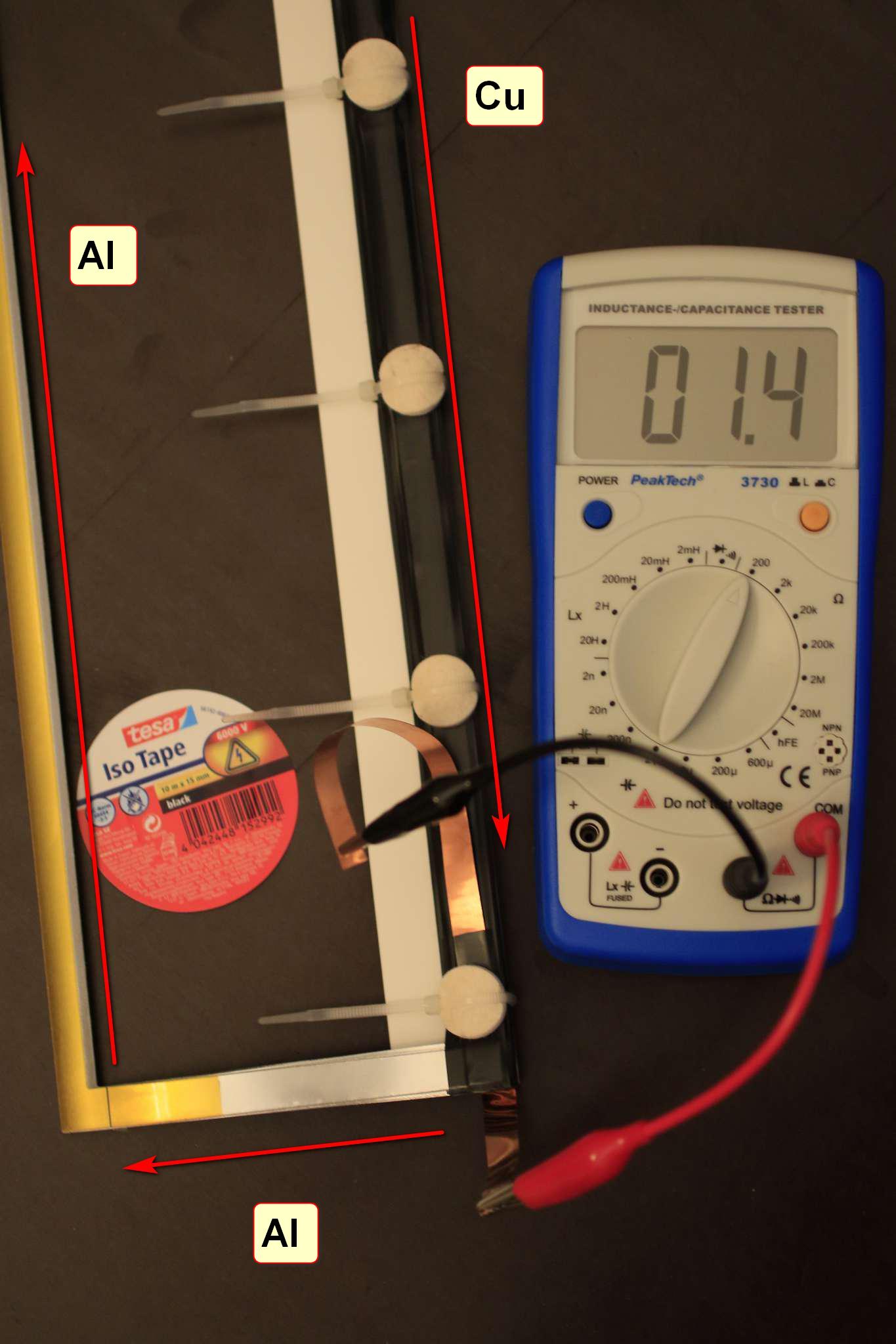

At Steinert they were also extremely helpful in welding Aluminum foil to the copper back wire. There is no current loss 60 connections in series! This connections can be used, since they are already there, to compensate voicecoil inductance. Schematic found on my Linearspule page 5.
I think it is possible to built this membrane much lighter, voicecoil is already reaching it’s physical limits. Best weight to conductance ratio and gap filling volume, no need for a coil former.

I don’t have any measurements yet, and probably never will. The voicecoil has a Rdc 1,5 Ohm. I made my pressing tool unfortunately before Steinert told me they can only deliver 0.058 mm foil. Therefore I ended up with this smallish 1,5[FONT=Liberation Serif, serif]Ω[/FONT][FONT=Liberation Serif, serif]. [/FONT]Laserinterferometrie would be extremely interesting, to see how this membrane actually oscillating. Scanning Vibrometer System (SCN)
1st Fundamental mode of this speaker is like a swinging door
This speaker motor is no exception to the rule F = B [FONT=Liberation Serif, serif]∙ [/FONT]I [FONT=Liberation Serif, serif]∙ [/FONT]l
Since I am using stray field magnet I would expect high efficiency with proper magnet system. (in schematic 1 and 2: the blue is magnet circuit, voicecoil is gray) Last picture of today shows current path. Underneath black isolation is back-conductor copper flat cable.

What type of voicecoil did you employ 20 years ago? In this speaker the standard round concentric voicecoil does not work, as membrane is oscillating around a fixed edge, like swinging door. It is a rotary actuator in this case.
If you take a piece of paper and try to bend it over a round opening it starts to wrinkle up. When you bend it in a straight line it bends easy, staying uncreased. That’s why I think NXT bender is not so good for high amplitudes and Manger MSW using soft membrane material.
Yes, this voicecoil inductance is far to low, with thinner foil and or other geometry you will getting perfect 4[FONT=Liberation Serif, serif]Ω.[/FONT]
