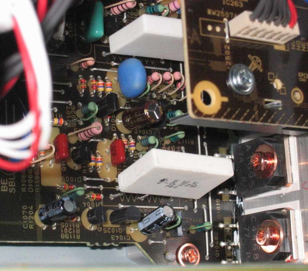

Just bought a new AV amp from Yamaha but the sound is too controlled, its killing the expressive musical quality of the music.
Now i got it for the surround channels and figured i will just use my own amps for the fronts if the sound is not what i expected.
But the other channels should be expressive as well.
Now for the price i got it i dont really want to send it back and get something else. I'm hoping i can revive some of its qualities by reducing the feedback on the outputs. This is how it sounds to me. I have experiance buiding a few gainclones and willing to dive into the interior of my NEW
amp but i'm hoping i can get some pointers here as what could be the cause of the too clean sound. Its has plenty of detail but lacks the free flowing quality i much seek.
Now please be gentle as this is just a hobby for me..
If i decrease the feedback then i will have more gain and this will need to be compensated by lowering the incomming signal right?
First i'll need to find out what exactly is powering the amp 🙂
the specs say the amp has a damping factor of 120. Its also still breaking in but i doubt very much it will improve to the point i want.
I will post pictures later today.
Thanks, Collin

PROBLEM SOLVED !! Back EMF
Hey guys it actually IS the damping factor.
Now I've got very lightweight cones so this could be the reason its so audible but using the resistor really works !
But dont use it in series ! It improved the low end but not much more than that. Use it Parallel. My reasoning is it gives the back emf (motion from the cone without applied signal) from the drivers a chance damp in the resistor as the amps resistance is too high to be of any good.
Now while it is a good solution sound wise i still dont like it..
What can be done to the amp itself to lessen the damping factor??
There are indeed ams with adjustable damping factors, that would be nice but not practical for this amp..
Picture of the output stage coming next . Looks pretty standard to me but i know very little 🙂
Can someone point me to information ?
Thanks, Collin

a damping factor of 120 sounds quite normal.
What impedance is that into?
How does it vary with frequency?
Adding half an ohm in series with the speaker cable will reduce the damping factor to lower than just about any SS amp on the market.
But it will also alter the Q of the speaker and may sound a bit boomy after adding the resistor.
Have you read the ESP site yet?

It was actually 6,8 Ohm !
in series. Ive gor 15 ohm in Parralel now.
A long time ago, going to check it again...

Yes the sony amp sounded boomy with a different bass driver..
This experience i speak of are with pro drivers, light weight and heavy motors, low Qes.
I guess every extra Hz you can get out a driver with a high Fs has a big impact. Still, it worked for the midrange driver as well, also very light cone.
!!!!! So could this be the heavenly match between tube amps and high eff. drivers !!!!!
Gr, Collin
Coolin, you said it improved when you put 15 ohms in parallel. That actually increases the damping seen by the speakers, though not by much. My guess is the amp is now supplying more current (you have to drive both the resistor and the speakers) and maybe the amp isn't very good at low power levels- it just likes working a bit harder, or it doesn't like the cables, the speakers or something. As long as the combined value isn't too low, I'd just leave the resistor in parallel.
I strongly suspect the notorious Japanese commercial amplifier philosophy of huge open-loop gain an GNF resulting in an extremely clean, lifeless sound without any kind of warmth, spirit and dimension. The musical qualities can thereby be rated as negligible.
