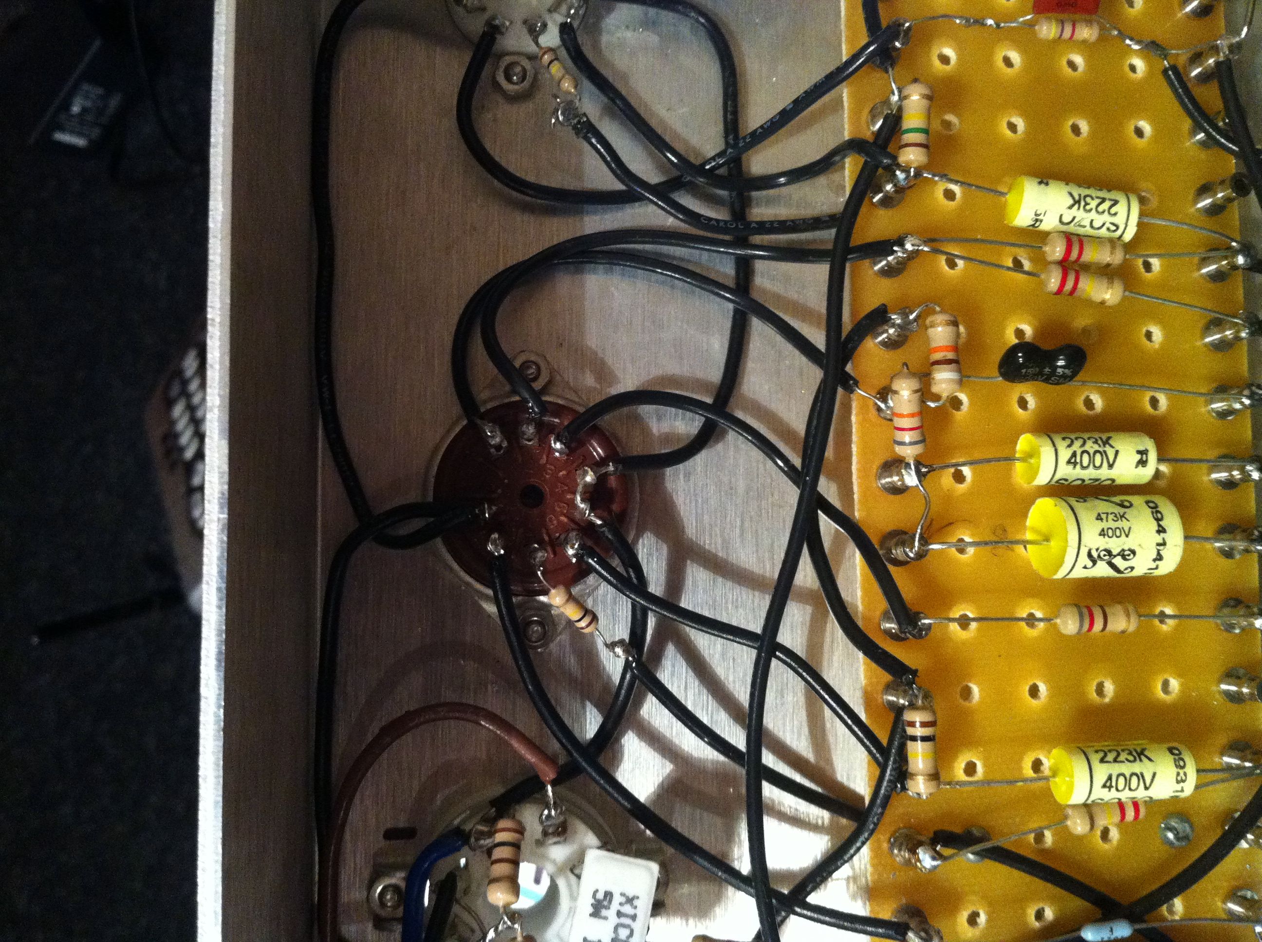

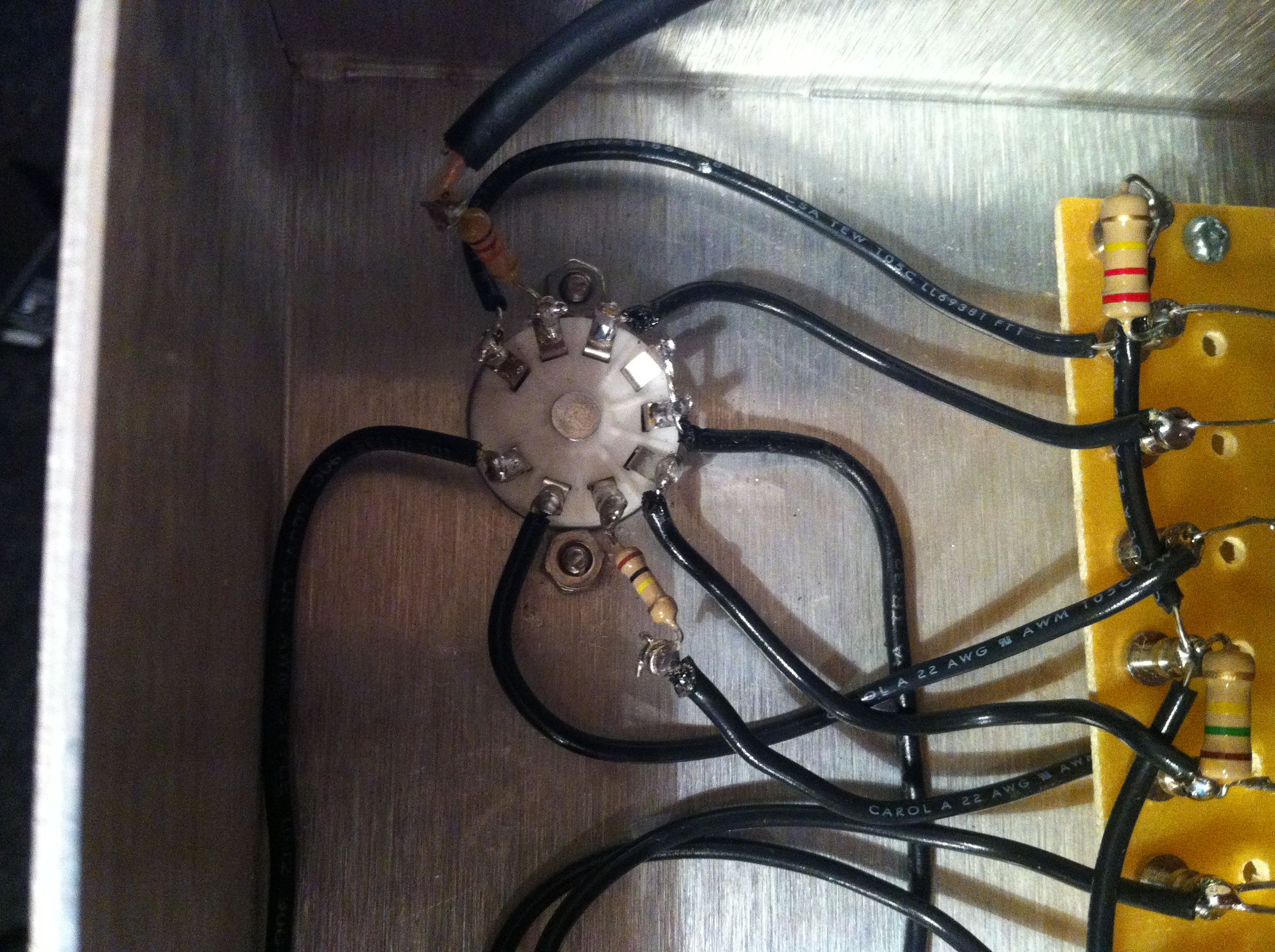

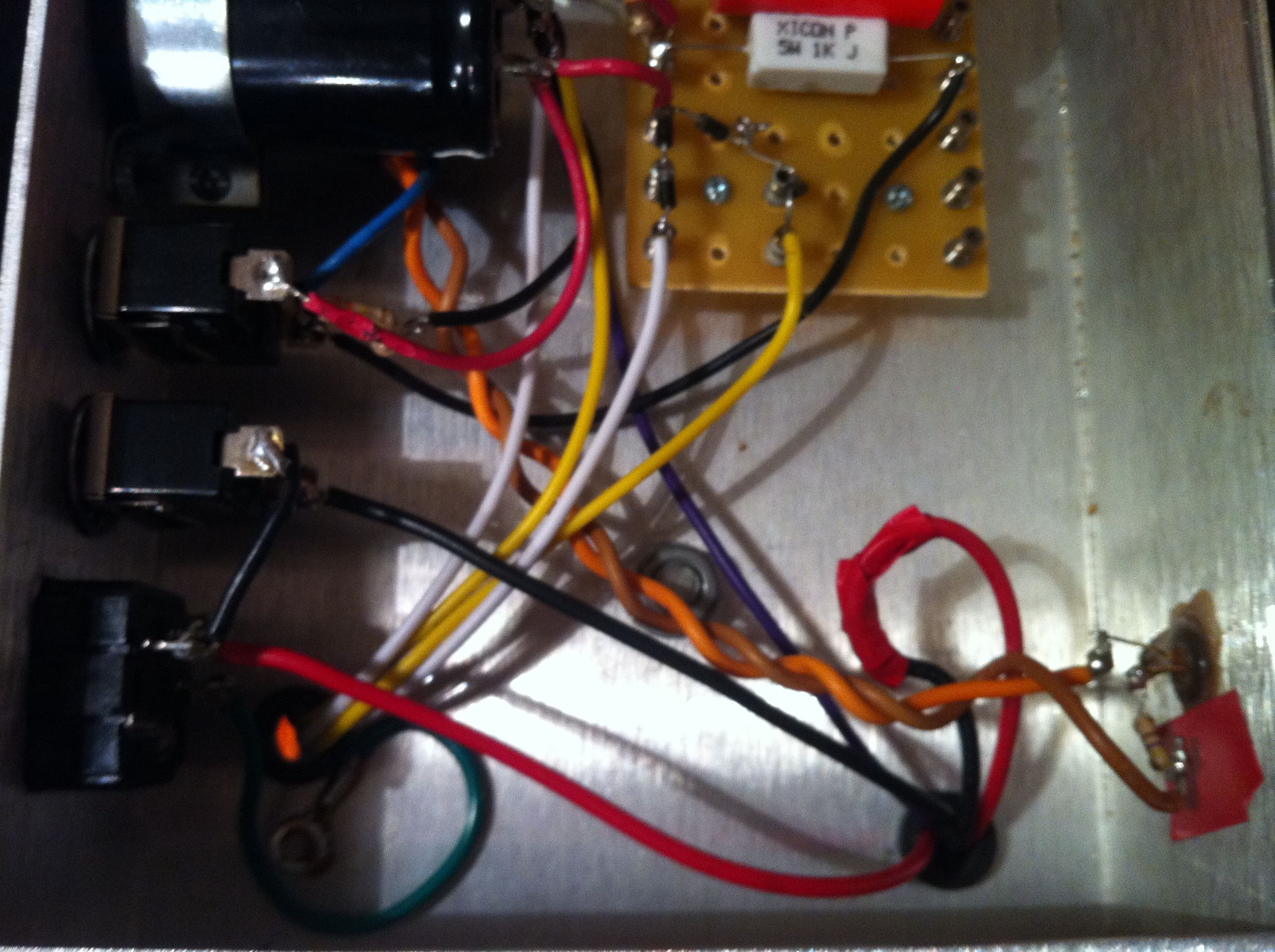

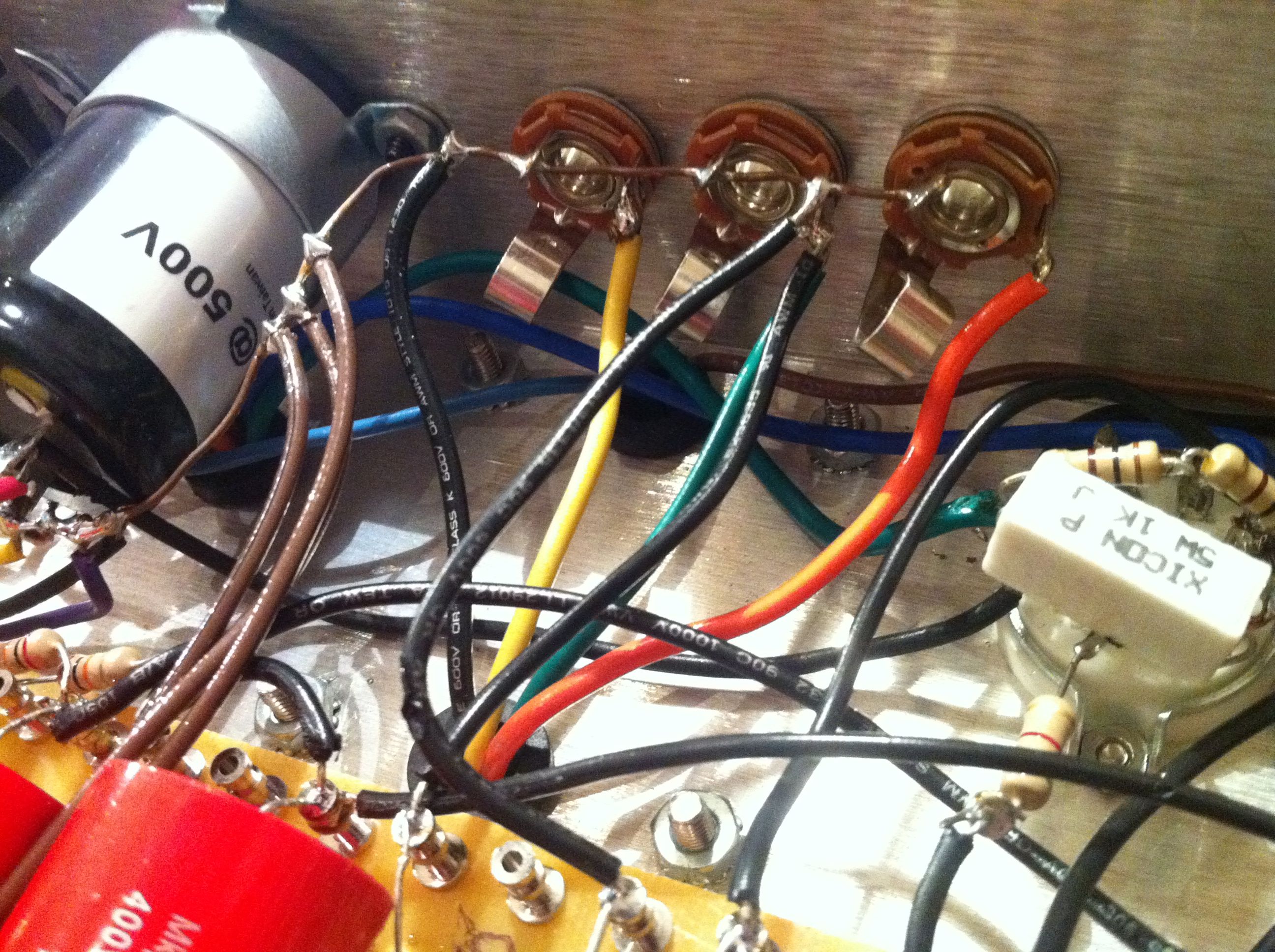

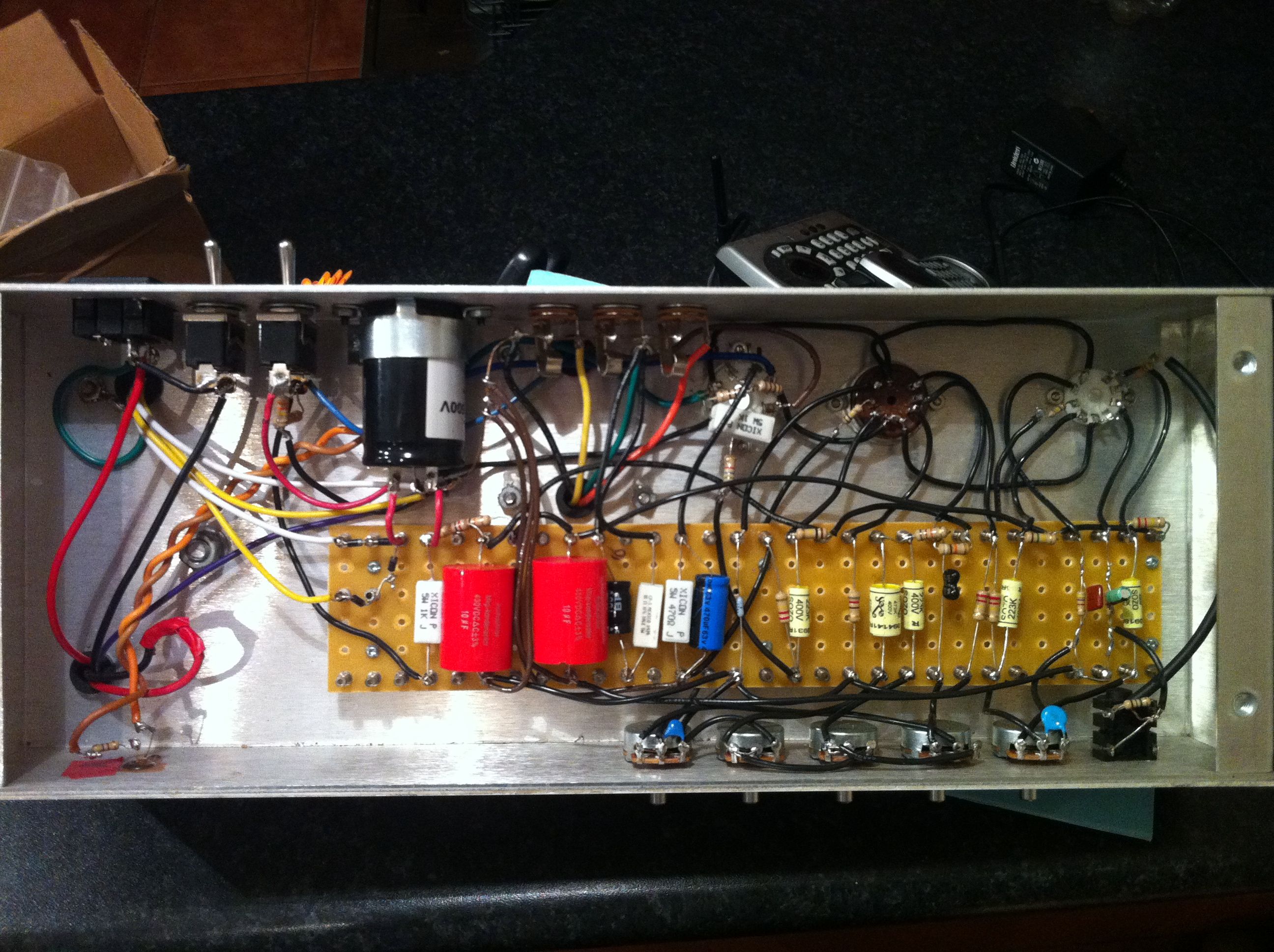

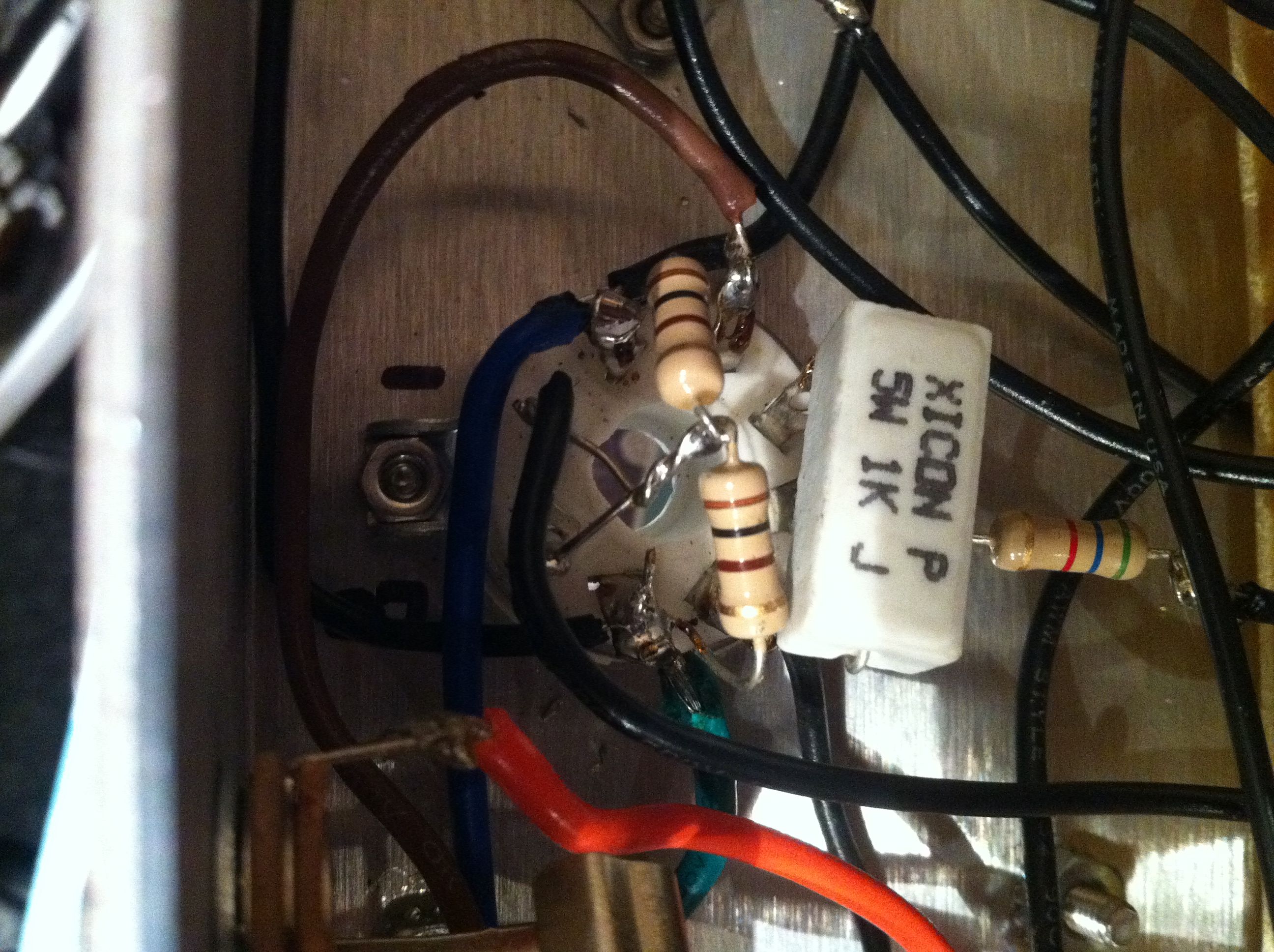

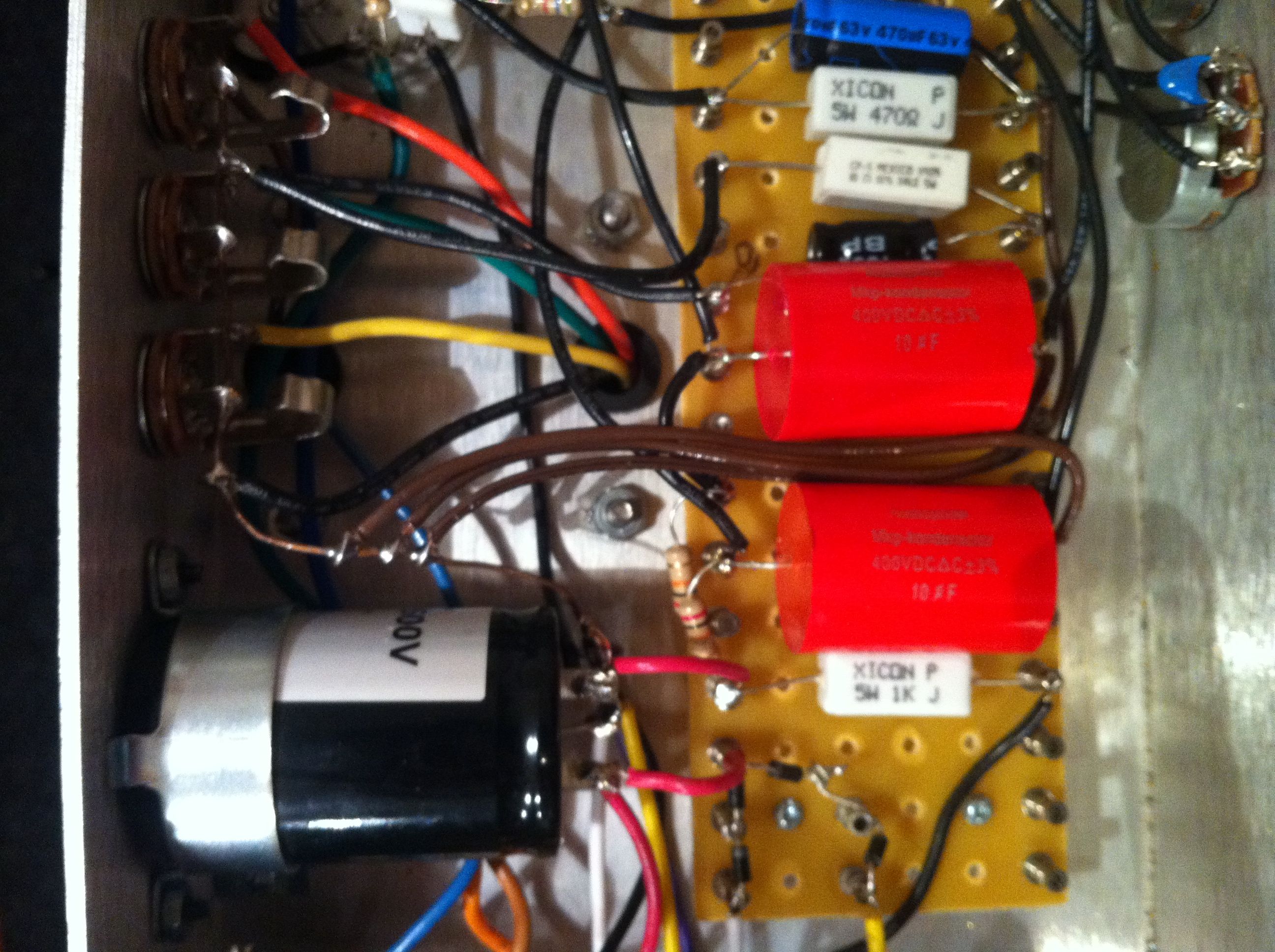

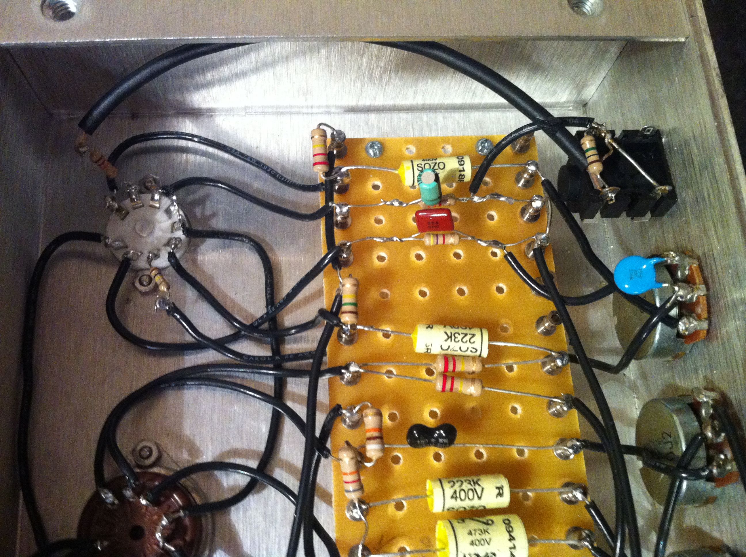

Well, I've been building a tube amp and it worked perfectly for about 10 minutes. After such time i cranked the amp (master, gain, tones all to 10), and it faded out (similar to what an tube amp would sound like if you were to turn it off and strum) and the only thing that remains is a small hum, which is constant (doesnt change if i alter volume etc).
Absolutely shattered.
I cracked it open and WITHOUT power tubes, everything's fine.
With power tubes, the heaters go to a ridiculous 27 volts. !!! I then tested it with a dim bulb tester, and sure enough, a short is detected.
I've done basic checks on the trannies (shorts, open circuits) and all seems to be fine in that department. Oh, and i've tried 4 different output tubes and 2 sets of 2 preamp tubes.
Any suggestions?

Second post lots of clear pictures and a schematic.
There is no way anybody can troubleshoot the problem without SEEING.
Need to give us a lot more detail, a hand drawn and scanned schematic of what you have built would be a good start. (Do not post other people's copyrighted drawings here without their permission)

Don't be shattered. It takes time.
Could just be a bad tube, a short in a tube to the filament is not impossible. Pictures Please?
Now put just the preamp tubes in, whats the filament voltage?
Now put just the output tubes in, whats the filament voltage?

OK I don't have a verified schematic,but a quick check showed the heater voltages are elevated on the output tubes. If they are tied to the cathode of the output tubes you are OK there. A 27 DC offset is probably normal..EnZO is bang on, normal hum reduction. Something else is crapping out, not filaments.
BTW It is a nice clean build from the pics, good thing. You should be able to trace out the voltages easily. I just hope the OT is not toasted..check that.

It's fixed, HOOORAY!
In the end, it was a combination of a couple of dodgy looking solder joints and, the B+ was arcing across to the filament voltage on the output tube.
