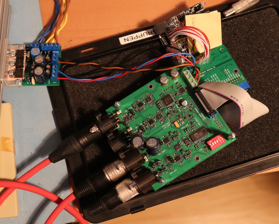

In the meantime I have received samples of both the AK5397 and the AK4490. I expect to start a design using both of them very soon. I have a design with AK5394A and AK4399, which I will modify to use the new converters.
But one does not need the usb streamer right? I want to capture analog streams, process them in the digital domain and send them out on analog again...
Regards
Regards
No, the USBStreamer is not absolutely necessary. The interface is I2S plus a few control signals to select the sample rate (from 44.1 to 192 kHz). There are on-board crystal oscillators to generate the MCLK.

The board shown is the one based on AK5394A and AK4399. So "only" supports up to 192 kHz.
The AK5397 and AK4490 based version still has to be developed. But the basic concept will probably be the same.

The current board has specs, which are in line with the data sheets for the converters used.
It could look about the same. But I also need to add an analog front-end with input signal attenuator and gain as well as DAC output buffers. But I may keep that on a separate board. This will give added flexibility and could be an advantage if one part of the design needs a redesign. It takes quite some time to mount a board like this by hand!

I might sell bare boards if there is an interest in this. With sufficient interest I could of course consider making kits or provide assembled boards. But I won't promise it at the moment.
