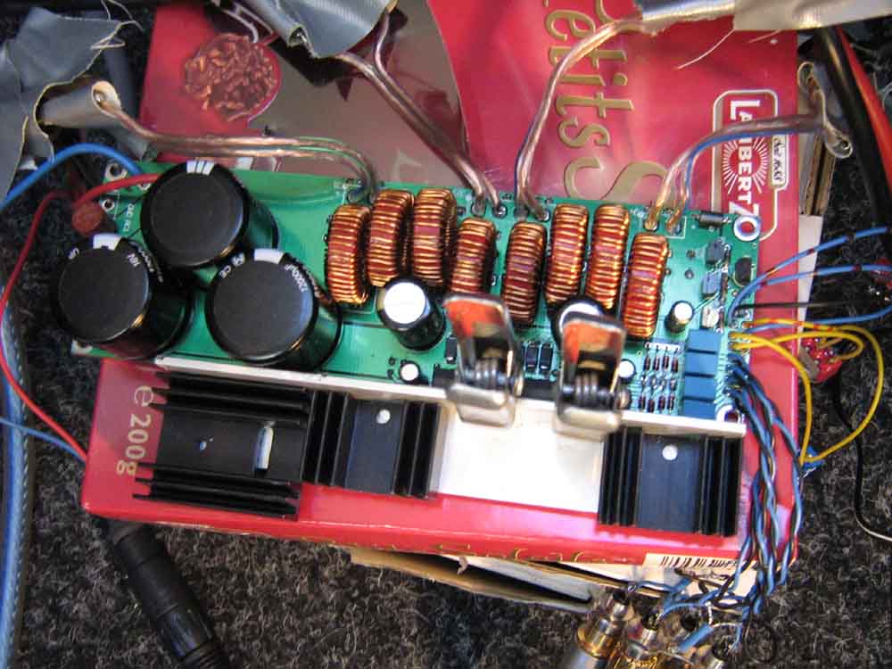

I've just finished building my first AMP9, took me six hours straight... winded the toroids nicely tight.. And dous it sound good? No, it sounds great! Now listening to it for the first hour I realize it sounds quite different from the Audiodigit... Can't really judge how it will sound after a good break-in period but it appears the staging is more precise, the low frequencies seem to extend deeper and mid frequencies seem to have more detail and richness...it's just scary to listen to some tracks with my eyes closed..
I also like the class A/B optional switch, the larger buffer capacity (6x2200uF=13200uF in the Audiodigit where the AMP9 has 3x12000uF=36000uF!!), the wider PCB leads at high current connections, the overload and fault led options and the PCB measures smaller than the Audiodigit. The input caps are also larger, maybe that's why it goes sooo deeeep...
I think these toroids also make a lot of difference, the Audiodigit has aircore coils..AMP9 just sounds more lively and seems like having more power, it sounds like a 'bigger' amp with more control..it's more articulate, but not in any way harsh or sharp edged..rather smooth and easy..
Love it allready, just have to put it in a box..🙂
By the way I measured barely 10uH on my LCR meter with the whole toroid (a single layer) filled, no spaces visible, even pushed every winding on them, 45 windings max. Though the assembly instructions indicate 42 windings to be enough..
Here's a pic of my test configuration (thanks to some of you guys
I've come up with a very effective way of clipping the chip to a piece of aluminum with silicone cloth inbetween...):

the SMD parts are large enough to grab with your fingers, on my AMP9 board the only SMD parts are relatively large diodes....(16 pieces each side...). The hardest part of creating the amp was winding them f....n' toroids, but after making two with my bare hands I used some tools (being very carefull not to crack the ferrite)
As it's very important to get the windings really close to the ferrite I placed the wire under my feet applying tension to the copper and pinching it all 'round with a pair of pliers. Thiw proved to be the only way to get 45 windings (which I consider max.) around the toroid in one layer..(mostly measuring 0.90uH barely peaking at 10uH, but amp works and sounds fine). I would advise to glue the toroids well to the board....
There are always lots of optional components going with each amp from 41hz...I've mounted them all, since (for instance the input protection zeners) I'm going to pass the amp on to somebody else (a collegue) who won't bother being carefull with it anyway...
But the AMP9 has lots of options the Audiodigit doesn't have (the Audiodigit has two led mounting options on the board both with the same function 😕 where the AMP9 has three with different function (power, fault and overload indication)...
The one I use is the 12V "low profile" version by the way with 16V caps, the 'normal' version has 3x15000uF 35V caps, must be a bit more powerfull at 27V..but like the Audiodigit it sounds great from 12V (SMPS)...and can handle the enormous load I connect to it...(ESL loudspeakers you see...)...
