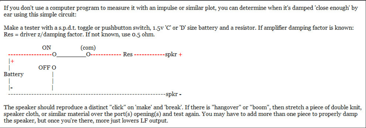

'Tight' bass/audibly low distortion typically requires sealed, (stuffed) TL, or if ported, well damped.

This alignment when critically damped (QL = 2) will technically meet your needs up to the THX 120 Hz XO point/>2nd order, but down this low the room dominates, so may wind up needing the vent stuffed to 'taste'. 😉
