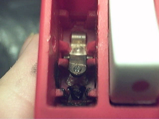

It happened while I was testing my new 3KW PFC frontend with a 1200W electric heater as a load. The two 230V 600W heating elements were connected in series to match the 450V output of the PFC. I wanted to investigate the transient response of the converter, so I decided to turn off the electric heater through its original switch without much thinking...
After five seconds of arcing I got a melted mains switch and a funny smell... Breaking DC currents is not easy at all.

You can use DC and salsa to eat through prison window bars, they showed on mythbusters.. Most switches and relays have a very limited DC capacity.

Interrupting large DC currents with either a mechanical switch or a semiconductor device is a real problem. Every circuit has some inductance and stored energy so you must somehow clamp the voltage and provide a place for the energy to go. Some combination of a snubber and MOVs or transzorbs will take care of the problem; the details depend on the specific situation.

You've let the magic smoke out! 🙄 As a member of the SAE 42V Committee, I have seen, firsthand, the effects of trying to switch large (over 1/2A) DC Currents above 35V. Relay and soleniod contacts trying to switch a few amperes at 42-48VDC usually wear out after about 5-10 cycles (ouch!), and switches have melted in the same amount of time. It was generally agreed that, for anything over 35VDC, conventional switching means would not do.
Two possible solutions were to try and enclose the contact area in some kind of inert gas, like Nitrogen or Argon, to minimize the arcing. The other was to use exotic metals that designed withstand repeated sustained arcing, which has been demonstrated almost 500mS!
Even a new type automotive fuse had to be developed because of the arcing issue. At least you didn't let the magic smoke out of you.

I have see permanent magnets glued near to the contacts of relays...
Apparently the magnetic field forces the ionised air molecules to travel a longer distance, helping to extinguish the electrical arc…

The switching situation isn't so bad for AC, as any arc created gets interrupted each 1/2 cycle and thus has a chance (a chance, mind you) to extinguish. If the arc is severe enough (especially inside a closed space) so that the flame/plasma cloud has no chance to dissipate, even an AC arc can continue until all the nearby consumables are, so to say, consumed...

I have built a 5kW load for voltages up to 600V. for short-circuit testing we use a gigavac Vacuum relay. Works like a dream.
