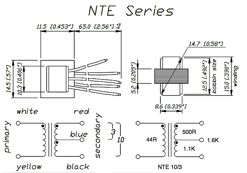

Hi, I have just brought a neutrik nte 10-3 to use in a simple mic pre I want to make.
What I need to know is what to do with the extra wire (the one for 1:3) as you have a choice of 1:10 or 1:3

Thanks i know how to wire an xlr, what i need to understand is the transformer:
NTE10/3 - Neutrik
please have a look at the diagram and help me understand!!

Ok, sorry, now I understand. Use this transformer connection:
Input - white (+) / yellow (-)
Output (x3) - red (+) / blue (-)
Output (x10) - red (+) / black (-)
Thanks rayma, this is how I understood it, so this will leave a spare wire in each case. What I am wondering is what to do with the blue wire? surely leaving it hanging will be a bad idea like an antenna picking up local radio??
There's not much choice, just fold over the end and heat shrink it. Then twist it and tie it up with the other two wires on the way to the pcb.
Preferably, you could have a 3 pin pcb connector for the secondary wires, with the third pin unconnected. This way the extra wire could be
treated the same as the other two, just not used.

The drawing pdf, Post5, shows the wire codes and windings.

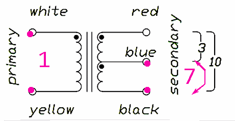

I just got one of these for a microphone OPT. Looking at the wiring diagram, it looks like the high impedance side is tapped at 3:1 and 10:1. There is no mention of 7:1 though this is a common ratio for mic. OPTs. Anybody used it in 7:1 and can comment on the SQ?
If Red-Black is 10, and Red-Blue is 3, then isn't Blue-Black 7?
Sound quality of small transformers will depend on both the driving source impedance and the working signal level. Not sure anecdotal reports are much use without more detail than most users can supply.
Yes - it's pretty clear that Blue-Black gives you 7:1. I guess the only thing to do is try it out and listen to the results. It's a very cheap transformer, but has had good reports from users. I haven't seen any mention of 7:1 in user reports so far, so it's likely that it's being used in 10:1.
