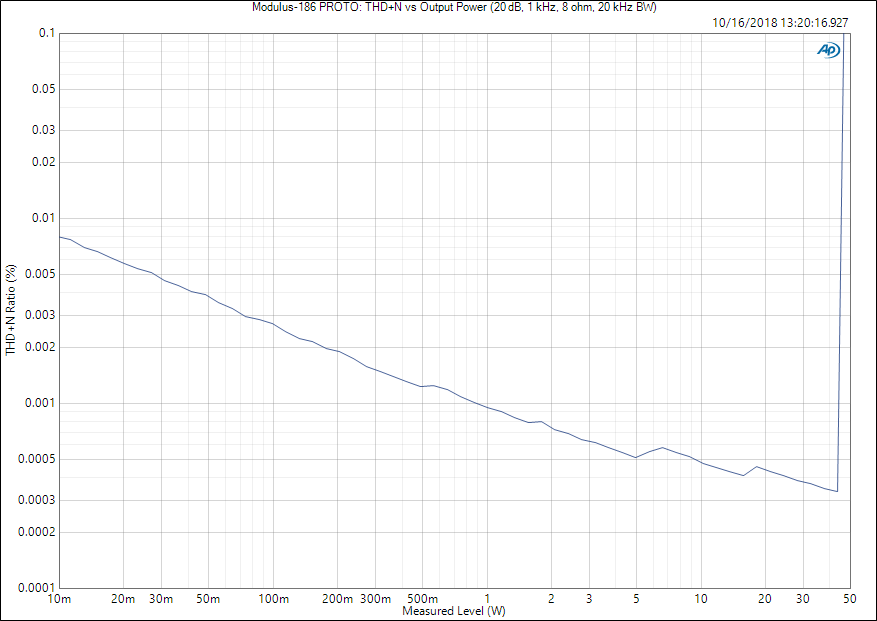

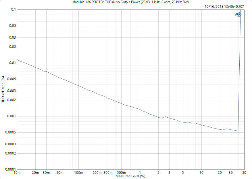

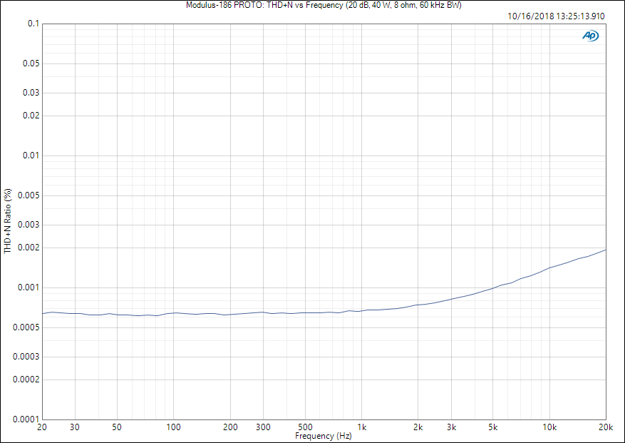

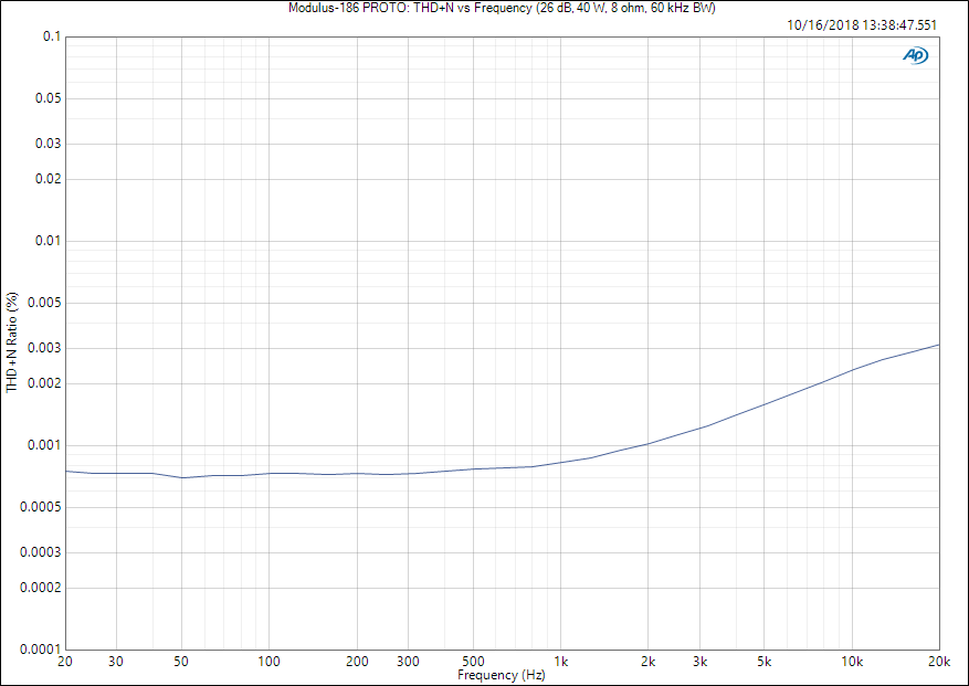

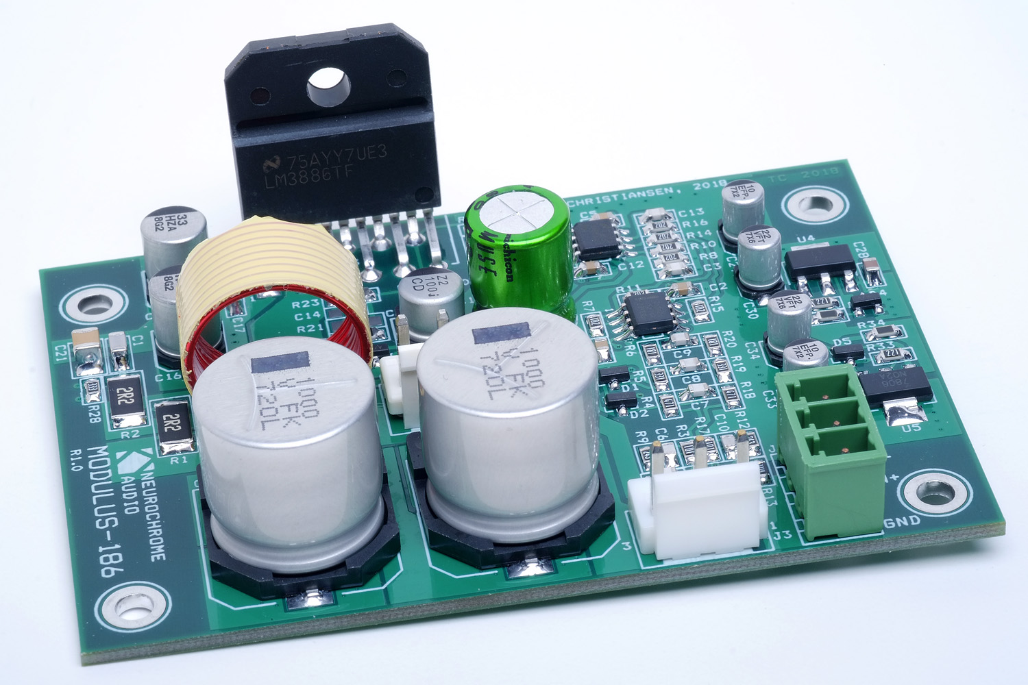

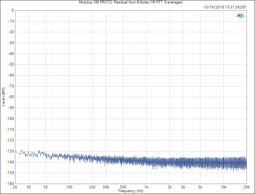

Key features (preliminary):
- Mono construction.
- 40/65 W into 8/4 Ω, respectively @ THD < -120 dBc.
- Tested for stability with reactive loads up to 1.0 µF || 8 Ω.
- Multi-tone IMD residual: < -105 dBV.

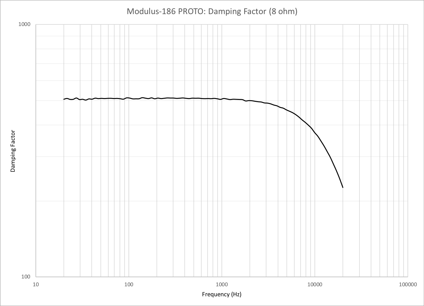

- Damping factor: >500 @ 1 kHz; >225 @ 20 kHz (8 Ω).
- Integrated noise (20 Hz - 20 kHz): 17 µV (A-weighted); 22 µV (unweighted) @ 20 dB gain.
- Integrated noise (20 Hz - 20 kHz): 23 µV (A-weighted); 28 µV (unweighted) @ 26 dB gain.
- Balanced input (can be connected to unbalanced sources as well).
- Default gain: 26 dB for ease of use with other HiFi components. 20 dB available upon request. Higher gain possible by a simple resistor swap.
- Four-layer PCB, fully optimized for the highest performance.
- Designed, manufactured, and assembled in Canada. All components sourced from reputable distributors (Mouser, Digikey, et al.)
- Available for pre-order within the next few days with a significant early adopter discount. Expected in stock by the end of November, 2018, at which point the into sale will end.
Note that attached picture and measurements are of the prototype. I will follow up with a more comprehensive set of measurements once the production version is in.
The production version will be Neurochrome Blue and professionally assembled in Calgary on a gold-plated PCB made in Ontario, Canada. The finished module will include aluminum mounting hardware (also made in Canada), which allows the module to be bolted directly onto a heat sink. This mounting method greatly simplifies the mechanical work for the the DIYer (only two holes needed with ±0.5 mm precision in their location).
Enjoy.
Tom
Modulus-186 PROTO_ THD+N vs Output Power (20 dB, 1 kHz, 8 ohm, 20 kHz BW).PNG41 KB · Views: 1,509
Modulus-186 PROTO_ THD+N vs Frequency (20 dB, 40 W, 8 ohm, 60 kHz BW).PNG34.9 KB · Views: 1,443
Modulus-186 PROTO_ THD+N vs Output Power (26 dB, 1 kHz, 8 ohm, 20 kHz BW).PNG40.6 KB · Views: 1,413
Modulus-186 PROTO_ THD+N vs Frequency (26 dB, 40 W, 8 ohm, 60 kHz BW).PNG35.4 KB · Views: 1,404

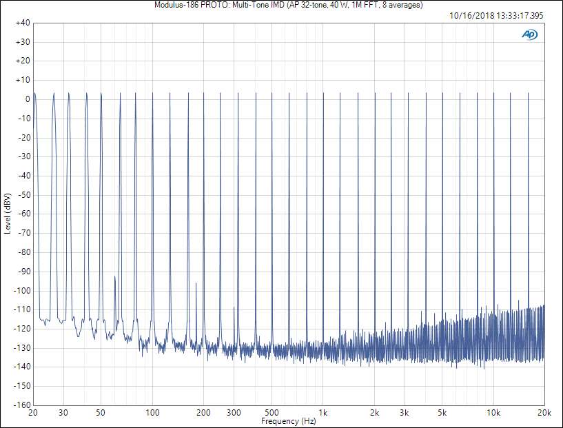

Modulus-186 PROTO_ Multi-Tone IMD (AP 32-tone, 40 W, 1M FFT, 8 averages).PNG64.8 KB · Views: 317
Modulus-186 PROTO_ Residual Hum & Noise (1M FFT, 8 averages).png48.3 KB · Views: 414

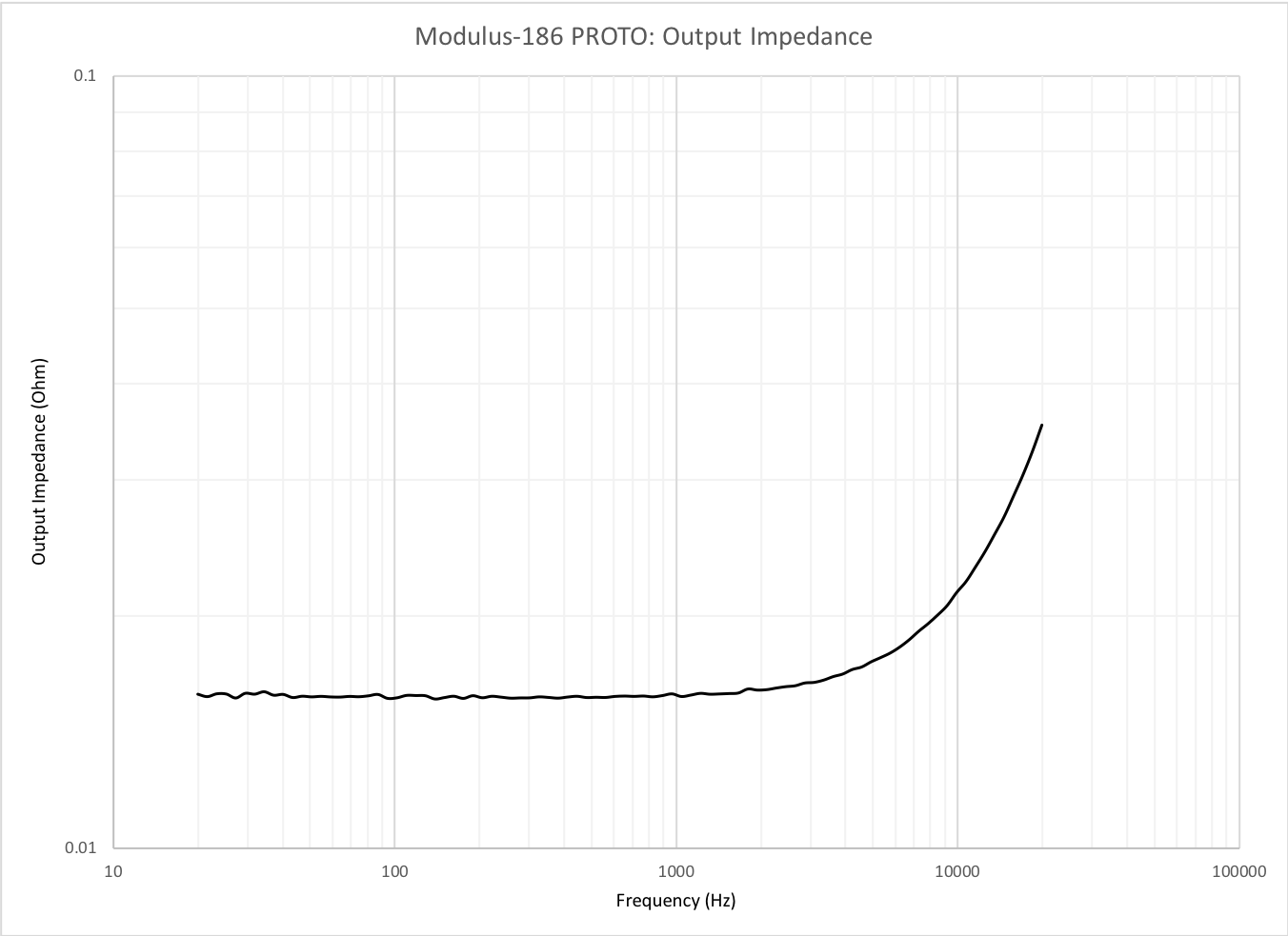

Damping factor and output impedance measurements.
