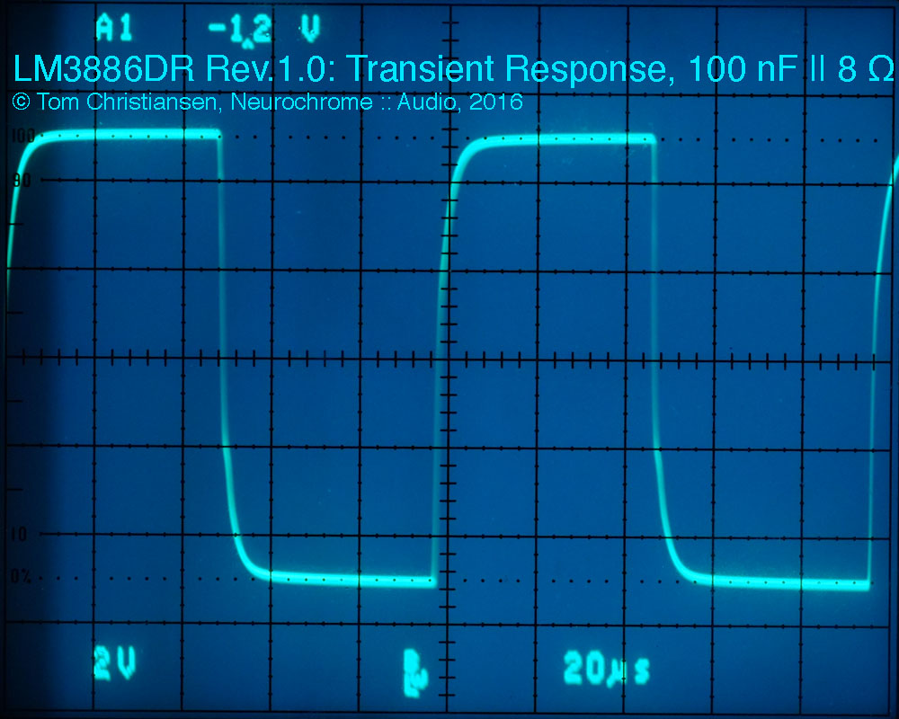

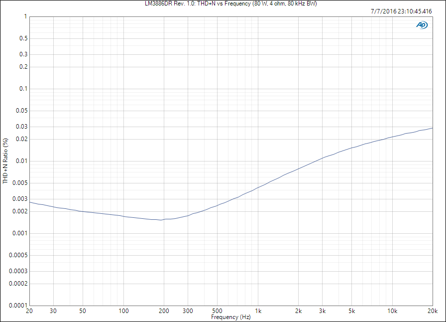

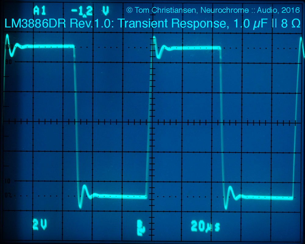

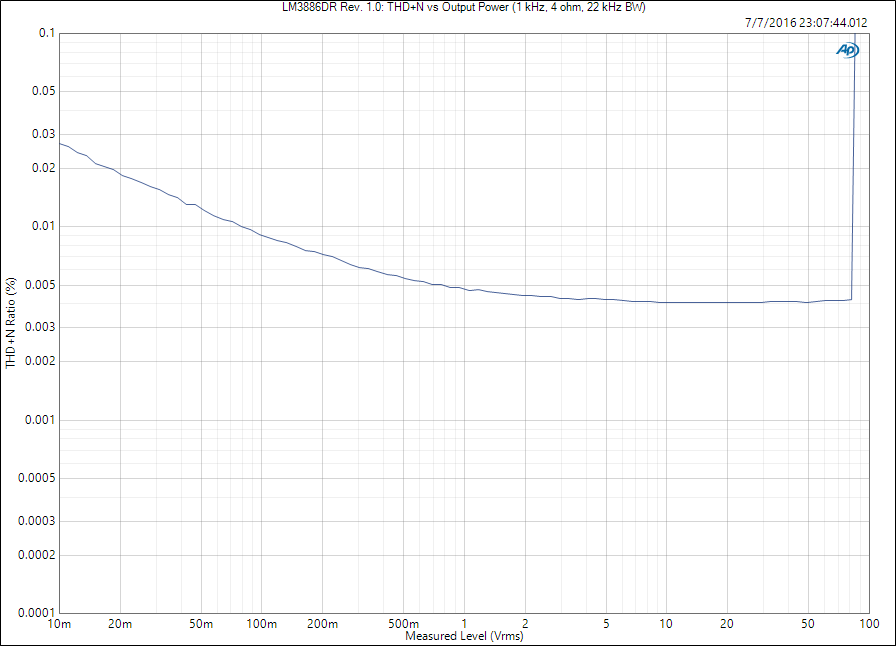

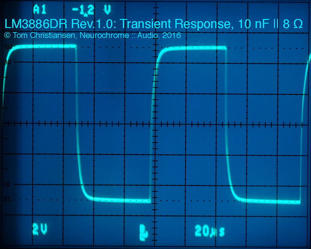

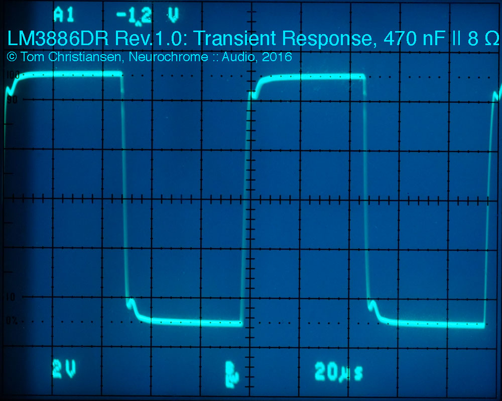

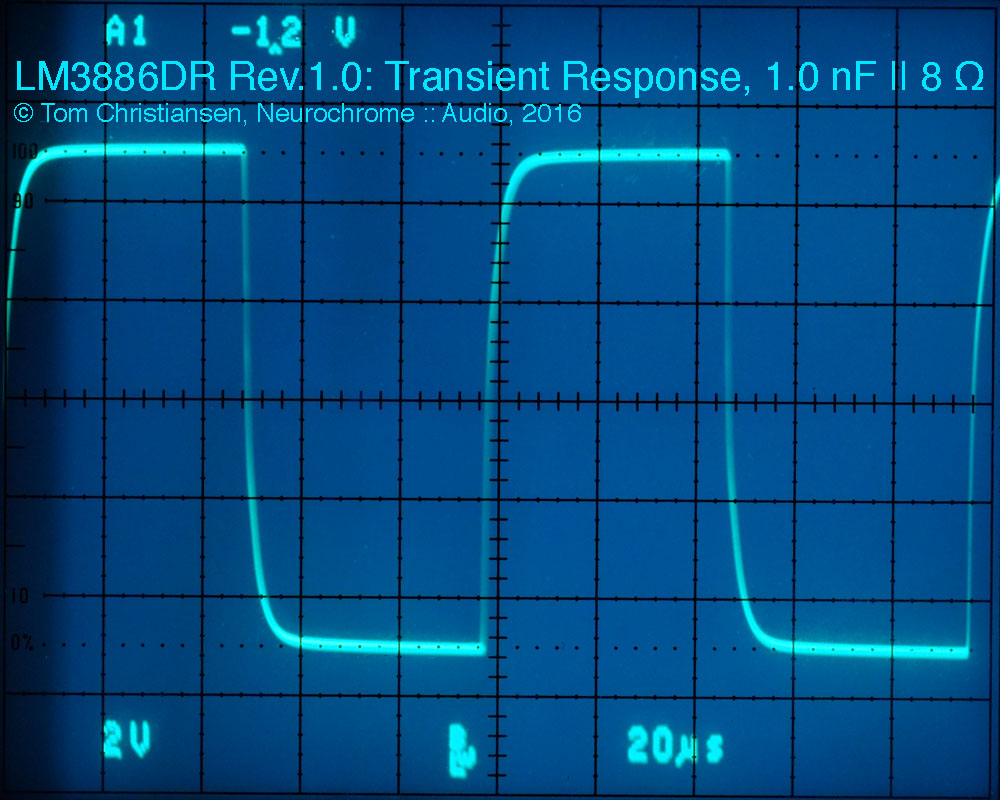

Attached plots shows the THD+N performance of the LM3886DR with a 4 Ω load.

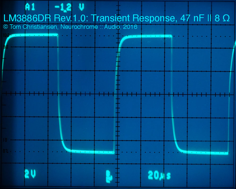

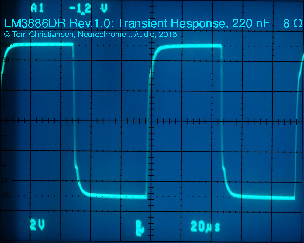

Also shown is the transient (step) response for various load capacitances. The ringing you see in the 1.0 µF || 8 Ω step response is actually the resonance between the output inductor and its dampening resistor. You can barely make out the onset of this resonance in the 220 nF || 8 Ω scope shot as well. As you can see, the LM3886DR is rock solid and completely stable, even with a large capacitive load.
Tom
Tom
LM3886DR Rev. 1.0_ THD+N vs Output Power (1 kHz, 4 ohm, 22 kHz BW).PNG42.9 KB · Views: 266
LM3886DR Rev. 1.0_ THD+N vs Frequency (80 W, 4 ohm, 80 kHz BW).PNG28.4 KB · Views: 397

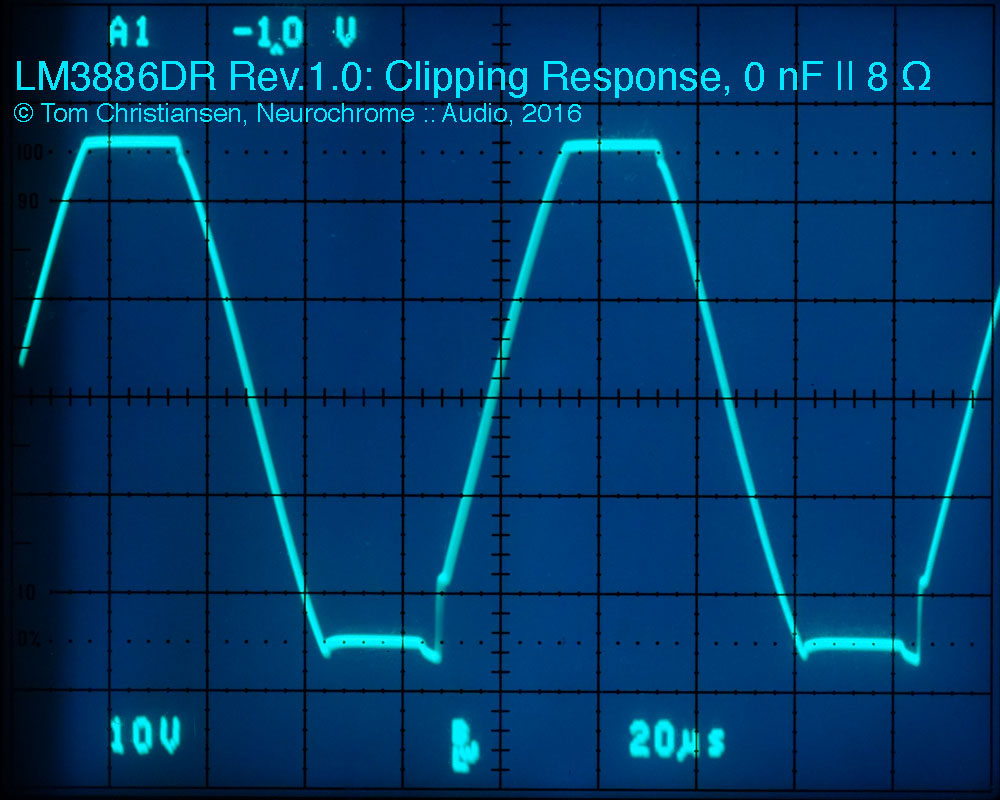

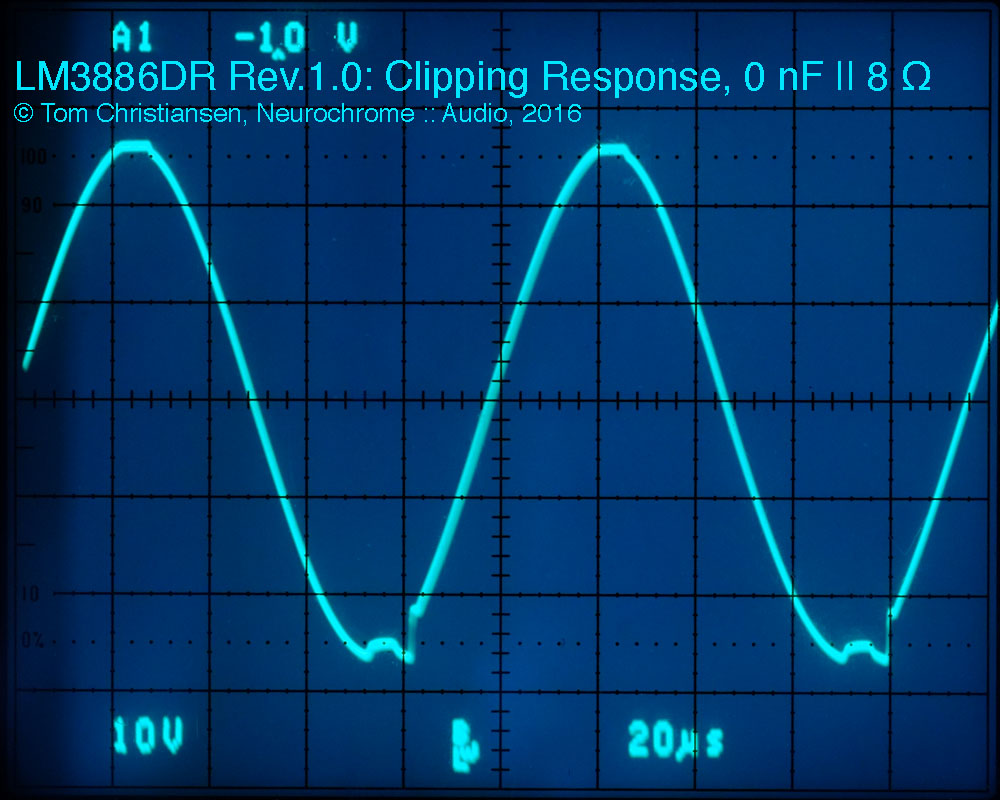

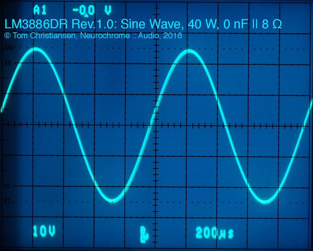

And finally the clipping response, both at the onset of clipping and hard into clipping. The scope shot shows the classic LM3886 rail sticking on the negative rail. Note that the LM3886DR shows no tendency to parasitic oscillation or buzz on overload and overload recovery.

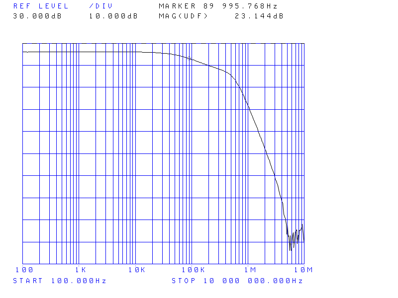

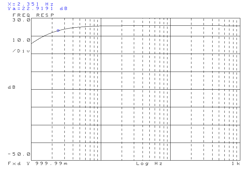

In addition to the frequency response plot shown in Post #1, I performed a frequency response measurement from 1 Hz to 1 kHz using an HP 3563A Dynamic Signal analyzer to determine the lower -3 dB frequency. I used an HP 3577A Network Analyzer to measure the frequency response from 100 Hz to 10 MHz for the upper -3 dB frequency and to characterize the performance of the RF input filter. The results are shown in the last two plots. The markers are placed at the -3 dB frequency (i.e. 3 dB down from the gain at 1 kHz).

The LM3886DR was done a few years after I wrote the stability pages. What's in the LM3886DR and its design doc is correct and the best practice. Please follow the LM3886DR design doc.
What is in the stability pages needs an update. The information is incomplete and I need to do a better job at putting it into context. Pardon the confusion.
The bandwidth of the LM3886DR is 2.4 Hz to 90 kHz. The 90 kHz is set by Cc and Cf combined. That corner is driven pretty hard by the LM3886 and the desire to keep its quasi-oscillation under control. The 2.4 Hz is set by the input cap. It causes a degree or two of phase shift at 20 Hz. That's not a concern as far as I know.
Tom
Tom

You may want to check the design documentation. Specifically, items 9 and 30 on the BOM on page 27. You'll find that the values I specify for the LM3886DR are different from the 22nF/15Ω you mention above. I'm not sure where you got those values from.
I use a different resistor in the Thiele (L||R) network than shown in the data sheet to give better transient response.
I'm not sure what your concern is. The LM3886DR will perform according to its specifications when assembled according to the BOM on page 27 in the design documentation that you will receive when order my boards.
Tom
Tom

The LM3886 P2P vs PCB thread is from March 2014. It was part of the grounding investigations for the Modulus-86. The LM3886DR is from July 2016. It should be pretty obvious that a few things have settled in the meantime. Just because I used one value in a prototype circuit to investigate grounding in 2014 doesn't mean I use the same values in my production level circuit in 2016.
The LM3886DR combine the "Typical Application" and "AC Test #2" schematics from the LM3886 data sheet, applies all the tricks listed in the application section of the data sheet, applies a good layout (resulting in part from the investigations in the P2P vs PCB thread and my subsequent simulations), applies good decoupling, adds an RFI/EMI filter, and boxes all that up in an easy to assemble DIY project. I have run the full performance characterization suite on the LM3886DR. You can find the results on my website and in the first few posts of this thread.
Tom
Tom
