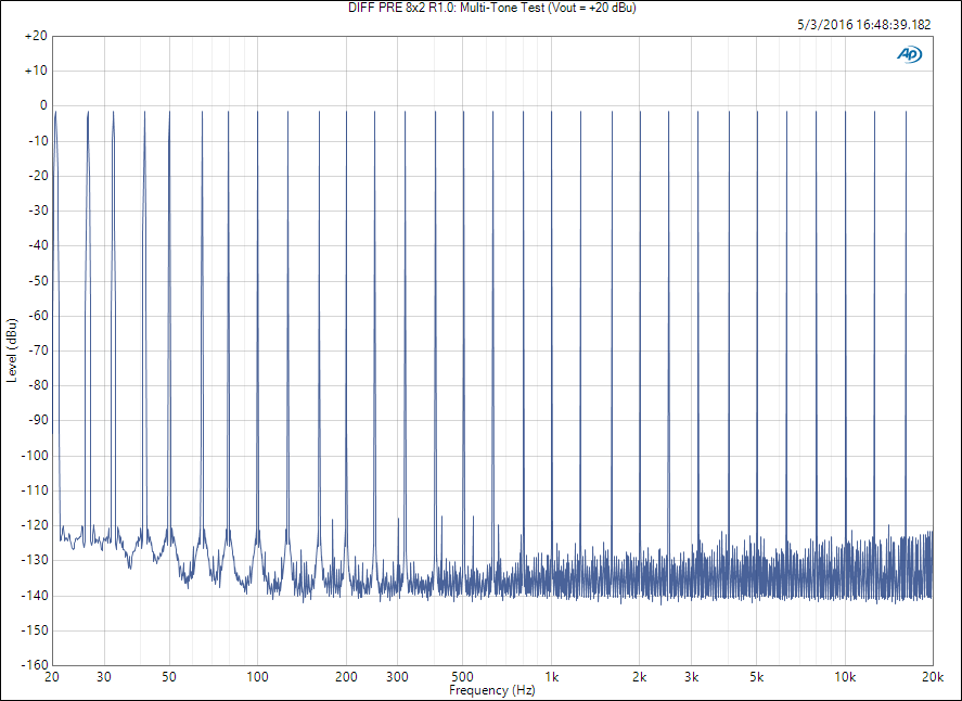

Indeed. I just had an opportunity to measure the IMD. The input is an Audio Precision 32-tone test signal consisting of 32 logarithmically spaced tones from 16 Hz to 20 kHz. The output amplitude is +20 dBu.
The IMD residuals check in at -120 dBu; 140 dB below the output signal amplitude.
