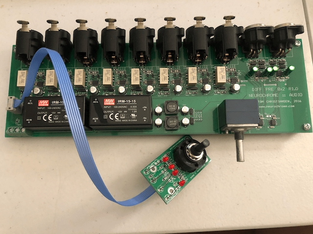

For sale is a fully built Neurochrome Differential Preamp. 4 stereo diff inputs, 1 stereo diff output. Tom calls this the 8x2. Included is the built input selector board. LEDs were purposely kept long in for the right enclosure which I never made. Haven't used it since about 2017 but it worked fine when put away for storage, so last I knew it worked perfectly.
I've been soldering professionally for 30 years so please have confidence that the build quality is good.
$250 plus shipping from 63025.

Just a question regarding why the pot is a 2-gang only for a differential pre-amp?

Likely used as a variable resistor across the lines, with series resistors in each line.Just a question regarding why the pot is a 2-gang only for a differential pre-amp?
A variable H-pad.

Because the DIFF PRE runs single-ended on the board. If the board is competently done there's no technical need for a 4-gang pot. That's not to say someone couldn't invent a marketing need, though... 😉Just a question regarding why the pot is a 2-gang only for a differential pre-amp?

I agree. I have heard some say that a preamp that is totally differential all the way through has some audible advantage, but I cannot see how---I think it is marketing audiophool nonsense.

This clearly means that the amp is not differential but has only differential inputs and outputs.Because the DIFF PRE runs single-ended on the board. If the board is competently done there's no technical need for a 4-gang pot. That's not to say someone couldn't invent a marketing need, though... 😉

So, people like Nelson Pass and others do nonsense, lol.I agree. I have heard some say that a preamp that is totally differential all the way through has some audible advantage, but I cannot see how---I think it is marketing audiophool nonsense.
But to give you an idea about benefits, signal doesn‘t touch ground (*) in a differential (also called balanced) design and you have double the voltage swing at the output and increased slew rate.
(*) A loudspeaker do not have ground, it only has hot and cold. Best is to take those from a differential amp. Of course you can connect minus to ground and safe half of the cost with a single ended amp.
Same with balanced vs. single ended headphones (where both channel cold is jointly connected to ground in order to keep cost down; and that‘s the only benefit)…
Having only the IO differential on a single ended amp, has an advantage only on the cabling length and signal transmission, which with short cable runs in a typical home environment is pretty much 0, but adds more electronics (thus noise and distortion) to the signal path.
I like the marketing term „differential pre running single ended“, thats award winning.Because the DIFF PRE runs single-ended on the board. If the board is competently done there's no technical need for a 4-gang pot. That's not to say someone couldn't invent a marketing need, though... 😉
The proper technical description would have been single ended amp featuring balanced IO. Nice one 👍🏻
Proper according to who?
The DIFF PRE had fully balanced inputs, fully balanced outputs, CMRR over 95 dB, multi-tone IMD exceeding 140 dBr, and mains hum below what my APx525 could measure. You want to argue marketing babble? I'd rather talk about performance. That's what I deliver. Performance.
