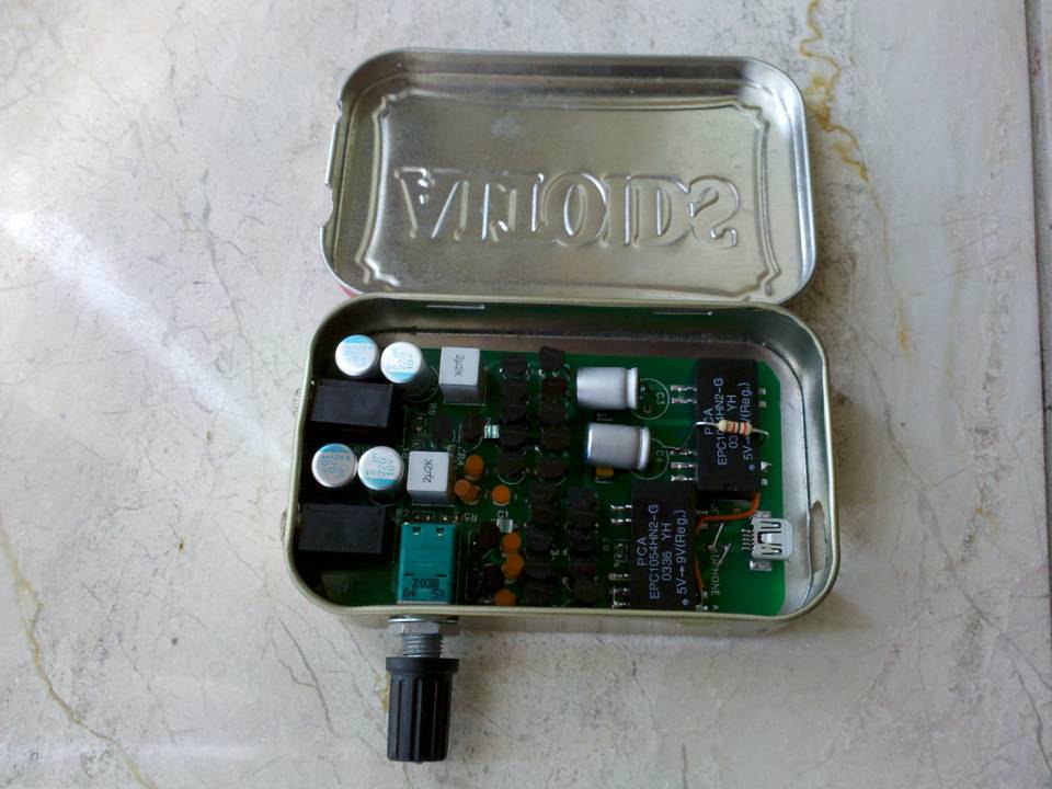

I just finished a headphone amp inspired by many of Nelson Pass's designs. It's basically a JFET son of Zen front end with a paralleled B1 buffer like the Beast with 1000 JFETs, but with only 5. It runs class A with global feedback and a total gain of 2. It's targeted for use with 32 ohm headphones which don't need alot of voltage gain, but can use the current. It's running at about 50ma per channel, so it dissipates about 2 to three watts. The JFETS do get a bit toasty - about 65 degrees C (155 degrees F). It does sound very nice however - I'm hearing details I've never heard before and now I think I'm held back by my source.
I used two 5v to 9v DC-DC converters to provide power. They operate at 1MHz, so it's well above audibility. The 5v is input through a mini USB port, so the power source can be a wall wart or computer. Electrolytic caps are 270uf OSCONs on the power supply and on the output. There are also 2.2uf film caps on the output and 4.7uF tants on the power supply. All JFETs are matched 2SK170.

Looks good.
Are your diodes the right way around though in your circuit?
They're LEDs and I may have drawn them the wrong way around in the circuit, I'm always forgetting which direction they go in schematics. They are the right way in the physical circuit. They're old 3mm low brightness LEDs, those seem to have the lowest AC impedance. Plus they provide a nice visual indicator that the power is on.
I thought about other devices for the CCS, but the JFETS just seemed the most logical. A single TO-92 device of any sort may have dissipated too much on its own - spreading it across 5 devices increases surface area and reliability. The heat dissipation will always be the same since it's running Class A. Putting some space between the devices might be nice for air movement, but 65 C is still a fairly good temperature by discrete component standards. Plus it seemed more in line with the whole "bunch of JFETS" theme.
You are right - that eventually hit me later on. 😛 Total dissipation would be the same. And probably no practical way to mount the TO-220 versions on the back of the board to heat sink out to the can.

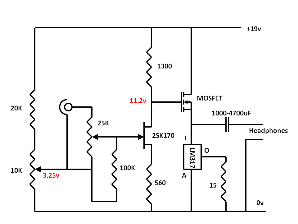

I decided to do a minimalist version of this schematic with the idea of a low cost, easy to source design for the first-timer. Here's the design I came up with. It has a JFET configured for a gain of 2. The design assumes an Idss of the JFET of approximately 10ma. It is designed to be run at approximately 60% of that in order to stay in the most linear region. That would be 6ma which would equate to 3.35v across the 560 ohm resistor. The adjustable pot that defines the virtual ground is adjusted so that the output at the virtual ground is .1v lower (this is the Vgs drop in the datasheet). The output of the JFET feeds a directly coupled MOSFET (IRF610) source follower with a 80ma constant current source. The output is capacitively coupled. I built a prototype this week using "bugsplat" construction in an old external hard drive case. It's powered by a laptop power supply. I've still got some white noise and humming issues to solve, but the power output is perfect for headphones (very, very loud at maximum with 32 ohm headphones, but power is limited to 0.2 watts).
I've got pictures I'll post in a little while. If anyone has any advice on how to get rid of the hum and static (which may be related to my construction technique or power supply) it would be greatly appreciated.

I would guess it's the power supply being noisy and the amplifier having low PSRR. If so, put something between the supply and the amp to clean up the power rail. Something like CRC filtering or common mode choke on both V+ and Gnd.
