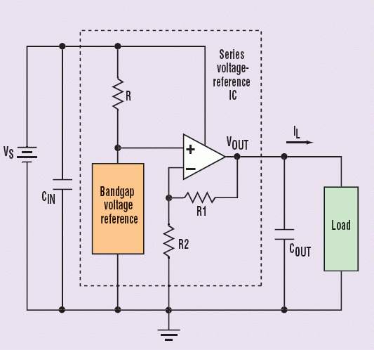

I was unsure if/how the TL431 could be configured for negative output.
I chickened out with the stacked 10V references too as I wasn't sure if the parts could safely be used like that.
For the record, I think both would have worked, especially the latter, which would also have been the simplest.
In the interests of going with what I know, it's the LM337L, LT1009 and OP27.
While I do realize that operating the opamp at higher gains results in a performance penalty, the resulting lower bandwidth should also make it more stable.

The basic schematic (for a positive voltage) is as shown:

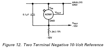

I started from scratch. Ditched the voltage amplifier entirely and will go with stacked references instead.
The circuit starts with 24V secondary and rectifier diodes, capacitor, feeds an LM337L adjusted to -30V, runs through a mild CRC filter to attenuate high frequency noise, and then a 3.3k resistor followed by two AD581 10V references in series, connected as per the datasheet for two terminal "zener" operation.
The AD581 is expensive, the highest grade cost me $35 each, but should do the job admirably.
I there any issue with stacking multiple references in series? I guess I'll find out...

You are correct, AD581LH-ND is only $20 at digikey. Its a locality thing: RS gives me next day service, no minimum order, and very cheap shipping. Digikey sends everything from the states, there's additional paperwork, and shipping is a lot more, even if I avoid the minimum order fee.
Anyway, built the circuit this afternoon and it works as specified, up to my ability to measure it anyway.
Still not sure whether having 220uF of output capacitance is a good or a bad thing, but its perfectly stable with it there so I am tempted to leave it.
Attached Eagle sch and brd files. I did the board point-to-point, so the board layout is just as a guide for me when soldering.
