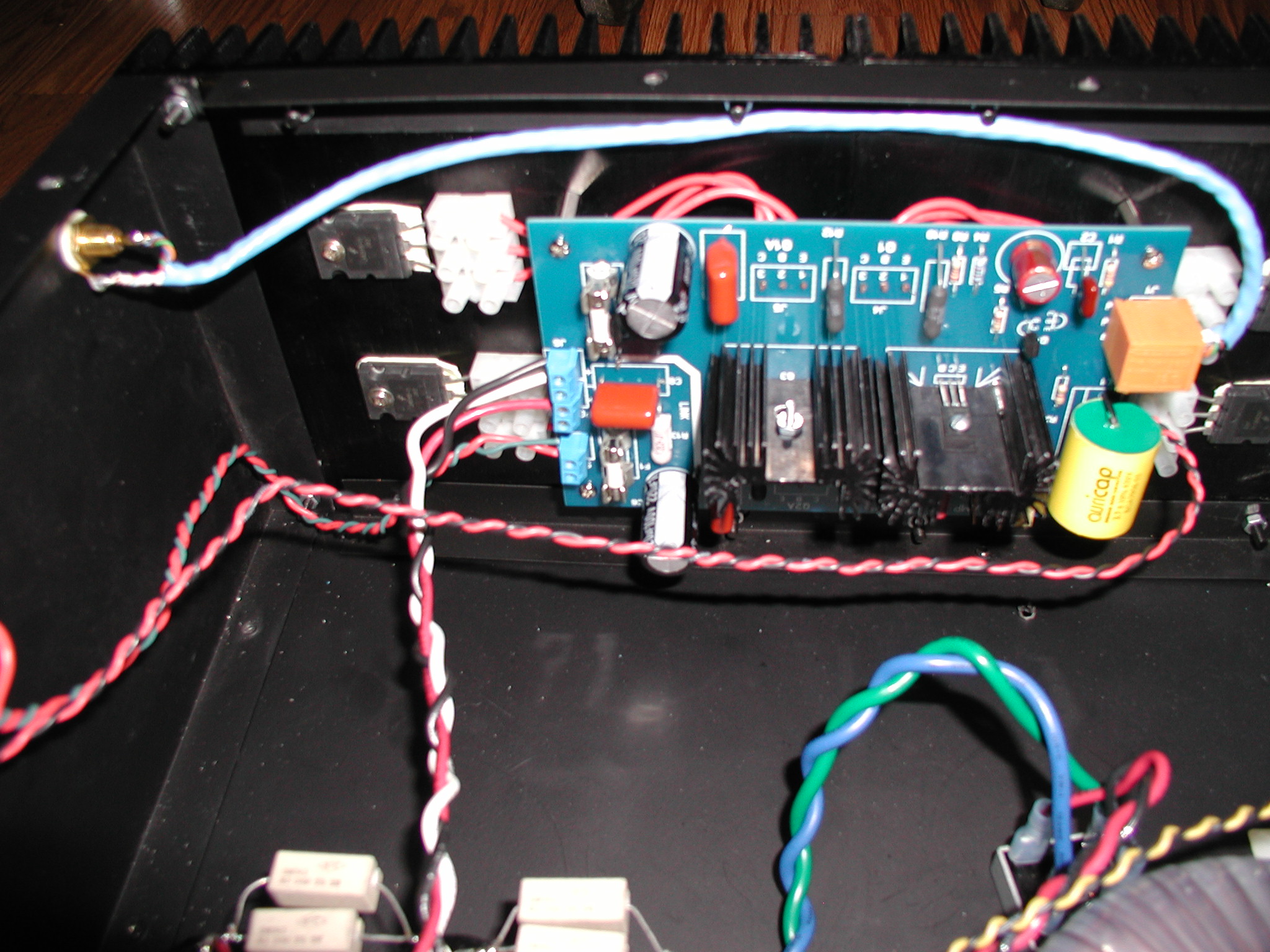

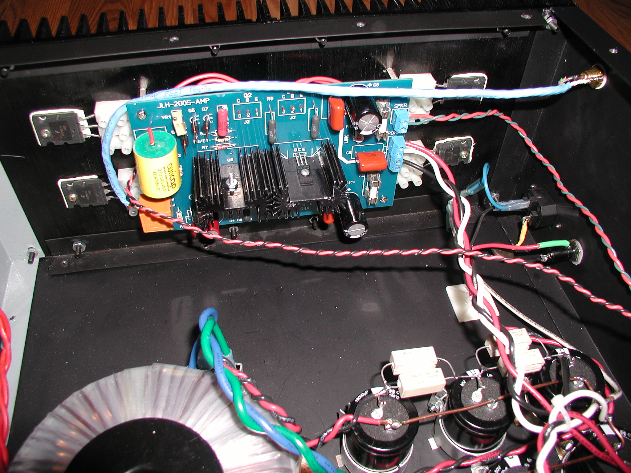

I have been checking the components on this amp for a couple days now and cannot figure why I have -20 volts on the outputs. I have the JLH Amp from Geoff's design from Skycoral
JLH-2005 – NOTES
Only different thing is I am using the FJL4315 (2SC5200 equiv) for output devices.
I have rails at +/-20V. The two pots (50 ohm and 2K) for Iq bias and DC offset adjustments do nothing. Not current through teh emitter resistors.
I bought these boards from someone here a long while ago and I think I remember them saying there is a fixed trace some where...
Tried 2SA970 / BC559 for Q5 Q6, Q7, and have 2SA970 for Q4 (in correct spot). Q3 is 2SC3421, and Q8 is 2SA1358
Any one?

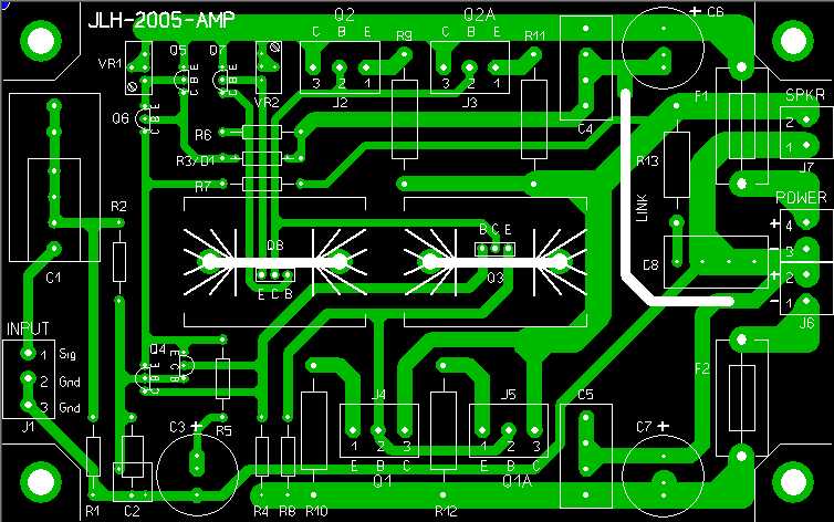

2SC5200/FJL4315 BCE pinout...
Your board pic shows EBC
If emitter junction reverse avalanched
possible that HFE has been degraded.
Yes, I had the FJL4315 wired correctly - Board showed different pinout of EBC - I managed to catch that at the beginning.
OK, so the 2SA1358 was toast - shorted on all pins. Still checking the C3421
EDIT - the SC3421 is also toast.
Bingo. Replaced the 1358 and 3421 and all is good. Sounds nice so far.

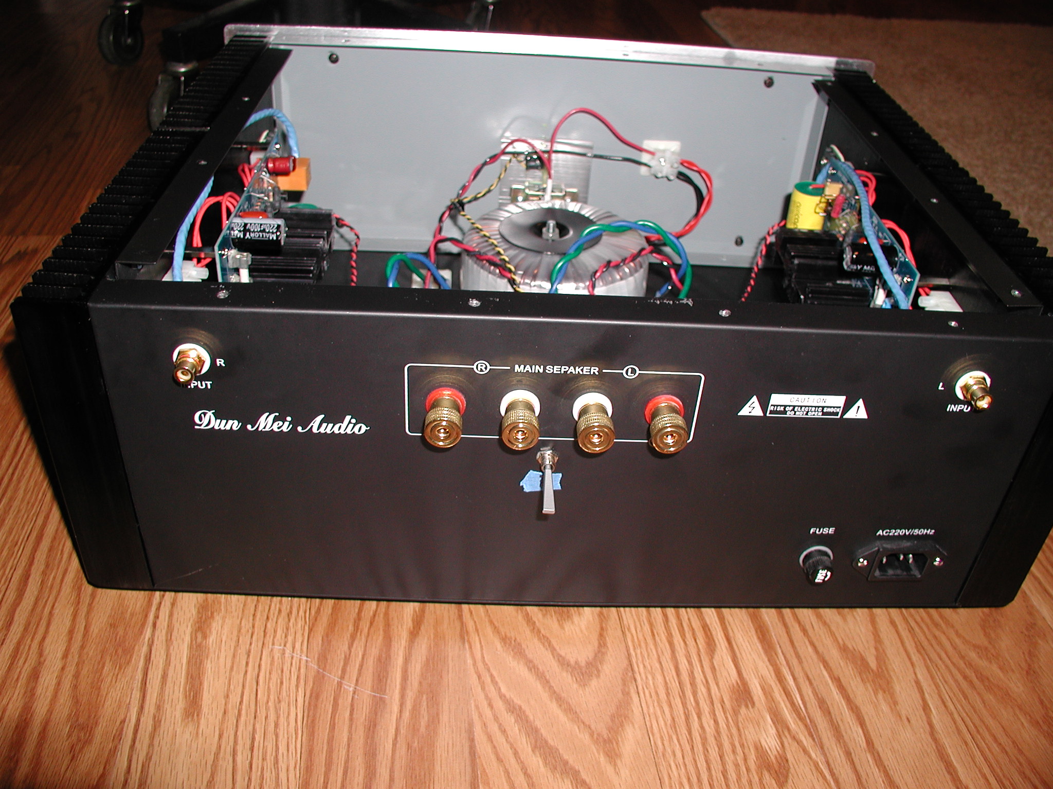

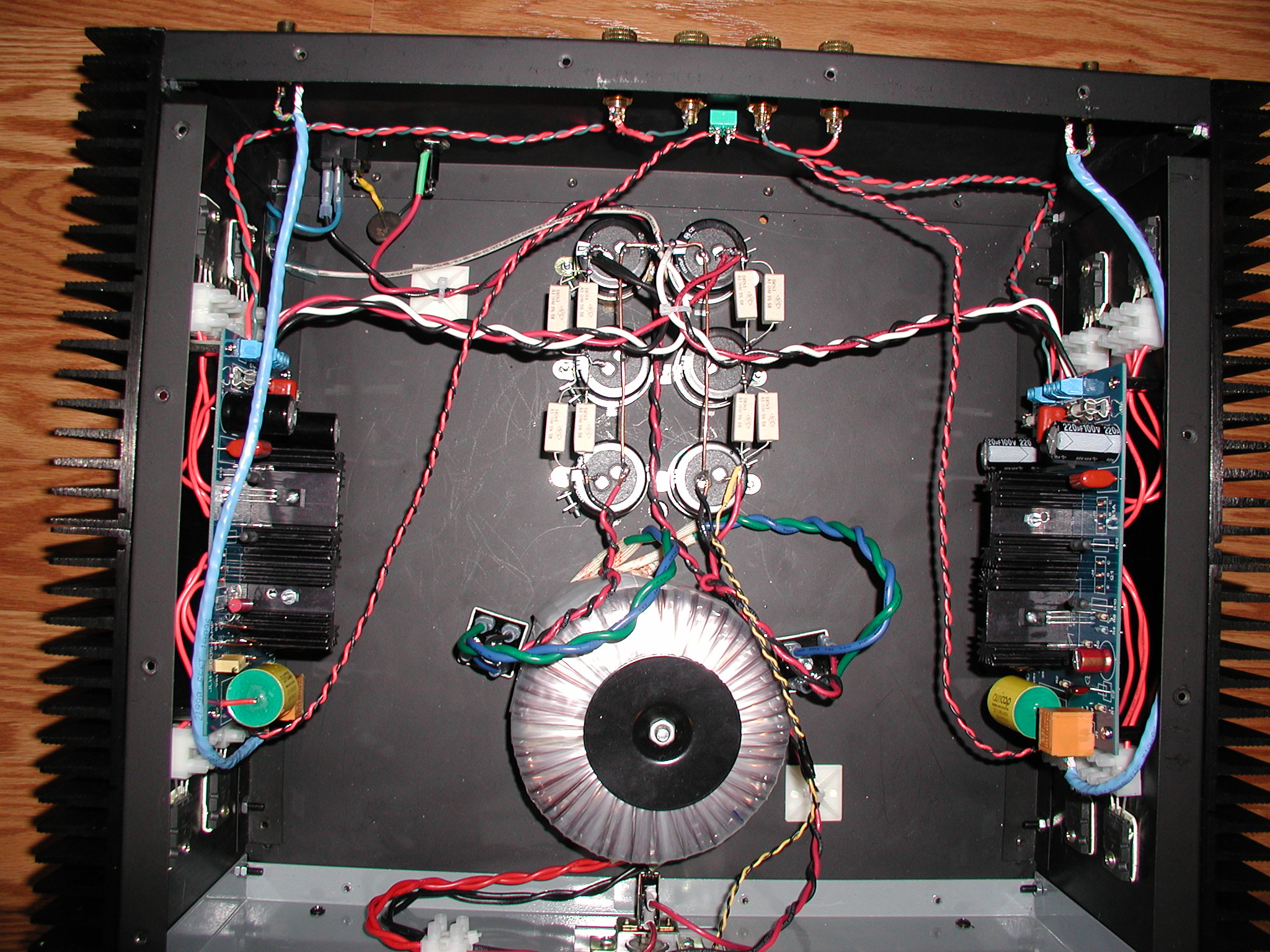

Here she is...like I said, I need to do some critical listening, as I installed a switch to bypass the input cap...don't know yet if the JLH will unseat the Krell KSA-50 Clone....
Turned out quite nice...
Nice job John. Pitty about the Dun Mei Audio silk screened on it. I think that acetone/paint remover will get rid from the faceplate, but don't use it on the back, it will remove the black paint as well.
I tried. Don't care much on the back, but Acetone won't get it off the front...
