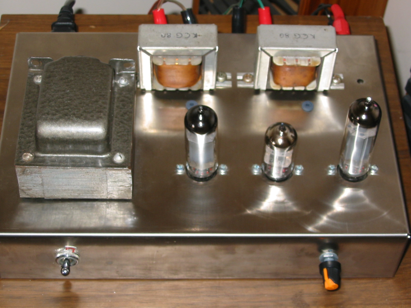

Here's my little amp (still not fully finished but running well.
