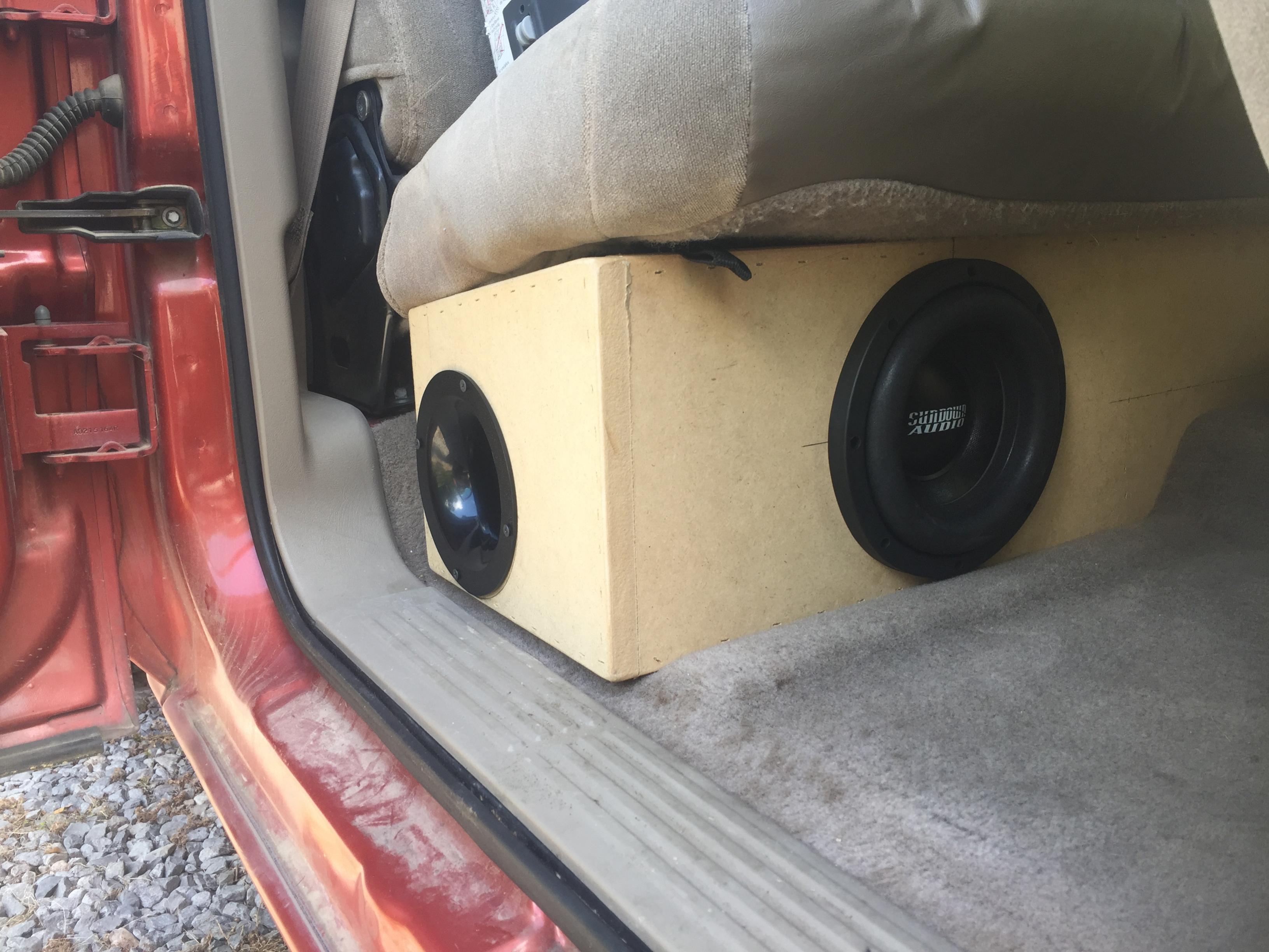

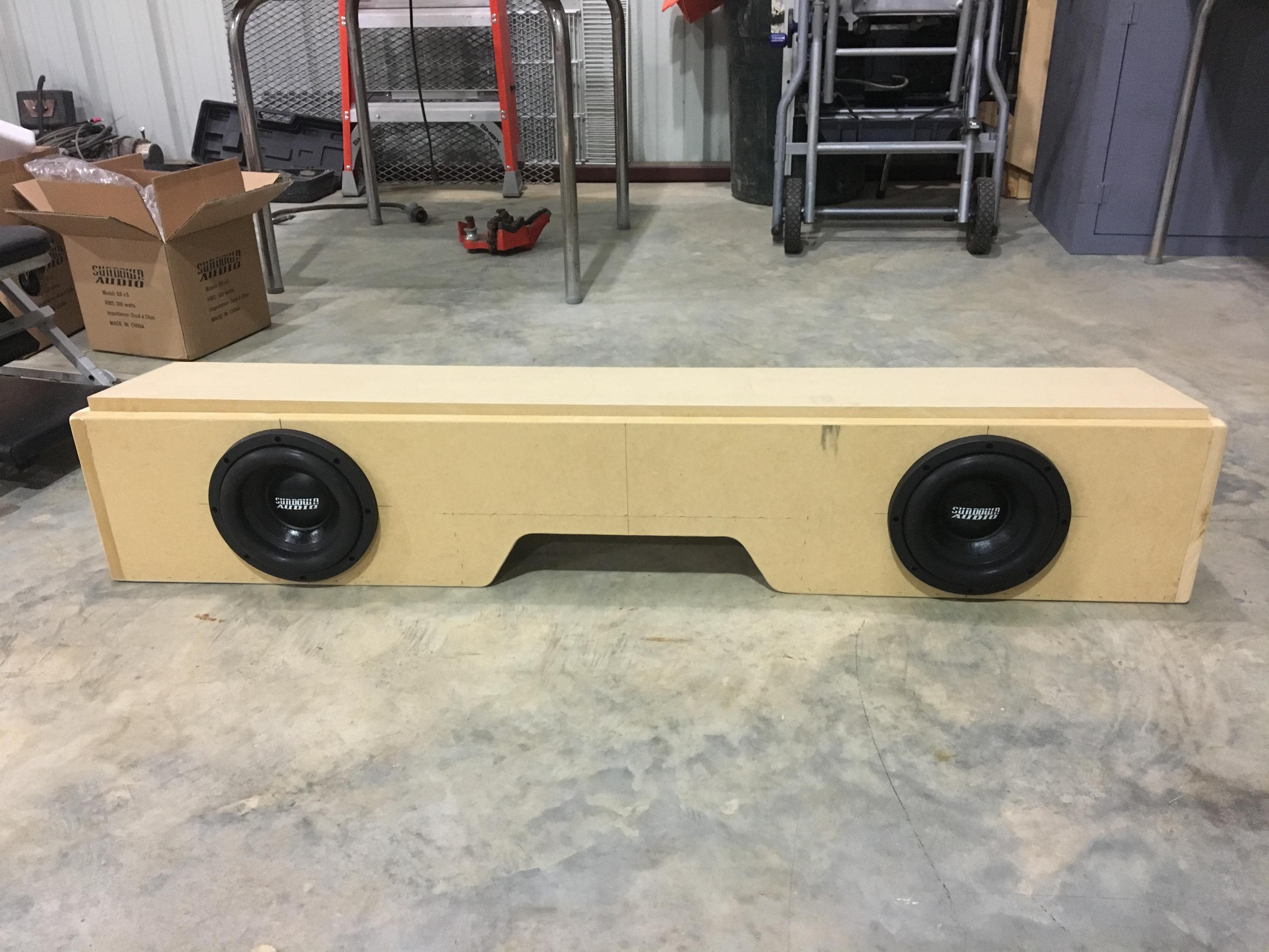

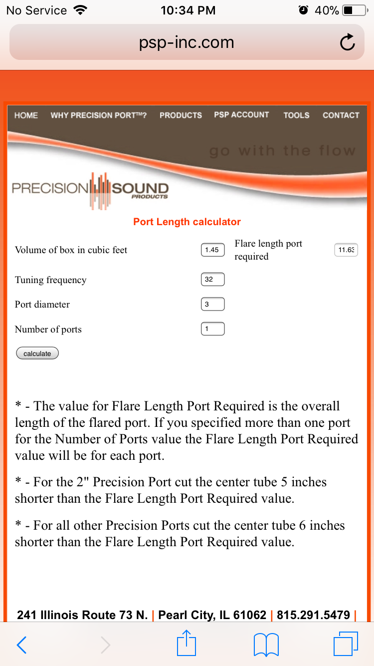

I am needing some help with my port size. I built the box and figured the port on specs of one sub, so i realize its not correct. Also i am locked into a 3” port at roughly 18” max length.
I had conversation with a fella that recommended to go with 2 3” ports at 14” length each to tune to around 40hz, so i have 2 brand new 3” port kits sitting waiting to be installed. The box before displacement is 1.65ft^3. Im lost when it comes to porting as this is my first serup being ported.
So any help that can be given is greatly appreciated before i screw up anything else.

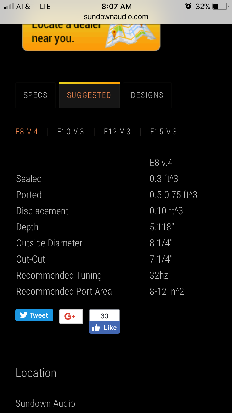

As a rule of thumb you'll need a port with at least 1/5th the area of the drivers Sd. So in your case that comes down to 1 x 3" port per 1 x 8" as a minimum. It looks like you have 2 x 8" drivers, so you will need 2 x 3" ports as a minimum as well.
In a (free) program such as WinISD Pro you could see the exact number of ports needed. In that case be sure to use the nett internal volume (and nett internal port area), so the internal volume of the cabinet, minus the volume occupied by the drivers and ports (about 1/14th ft^3 per 3" port in your case).

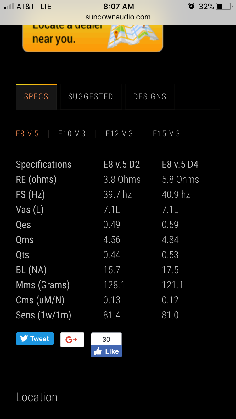

Who knows what Driver you are using? Dual 2 or Dual 4? From what Year? Do you have measured TS Data? In which Car are you installing your Sub? Do you have Cabin Gain Information* based on the suggested location of your Sub?

I have herd of that program so i will take a look at it.

I can give some of those questions answers but some of them im lost.
From one of those pictures, it looks like the vents are going to be pretty close to the doors, which is going to lower their tuning a little. To be honest I'd just use the two 3" vents as suggested, and make them as long as possible, making sure that there's at least 4" clearance between the internal entrance to the vent and any internal walls.

I am building the vents out to 14”, which is 15” per precision paperwork. This will give me 3.5” from the step in the middle of the box thats about half the depth of the box.
Its very hard working with minimal space and keeping everything tucked so the kids dont stick their foot in them.
WOW, what a difference the extra port made! Pulled the single 3” x 11.63” and installed two 3” x 14”...!!
