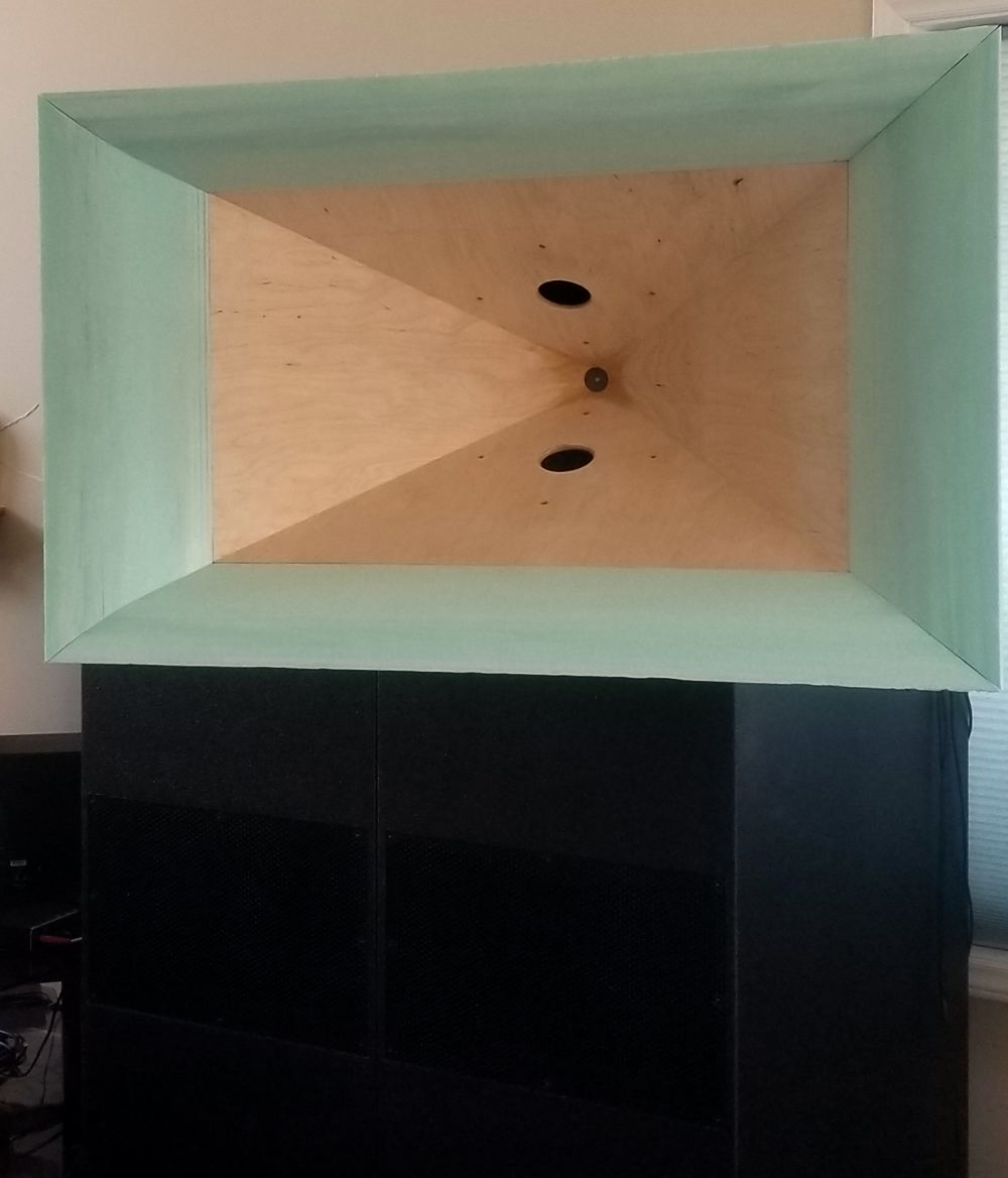

I'm in process of making some secondary flares for a synergy project out of Lowes XPS foamboard.
All web searching leaves me confused how to best harden and strengthen it.
Ideally I'd like something that brushes on thin per coat (less than 1/16th) and is sand-able, and of course paint-able with nothing special.

Epoxy would give you a hard shell, with a thin coating, which will readily accept primers and paints after a sanding. If you plan on more than one coat, you will need to apply the second coat before the epoxy cures, or wash off the amine blush from the cured epoxy, and sand to create adhesion. ( warm water, soap and a scuff pad will suffice for washing the amine blush off )
Epoxy is best used with a woven glass cloth, but can be difficult to wet out. A 6oz cloth would be sufficient for most needs. Best method is to brush the surface before laying the cloth down, then squeegee the cloth. Without a glass reinforcement cloth, epoxy coated foam would be like an M&M, a hard shell with a soft foam inside, less damage resistant.
If you could tolerate a thicker application: titebond II glue with a thin cotton fabric reinforcement and paint over with an acrylic latex paint, also known as 'poor man's fiberglass'

If you just want to have a hard shell with decent sandability, epoxy with a thickener like cabosil would be a good option.
Thank guys,
I think potential banging around of the flare, merits the epoxy with glass cloth technique.
But it sure would be nice to be able to get away with just epoxy and cabosil.
So I'll get some epoxy, cloth, and a thickener to do some testing. I'm so new to this.......argh..

I've used Duratex on the foam, and it adheres fine and toughens it up some.
But I'm sure I'm gonna need much stronger reinforcement to keep from breaking this flare.
Just ordered some epoxy resin and 6 oz fabric.
