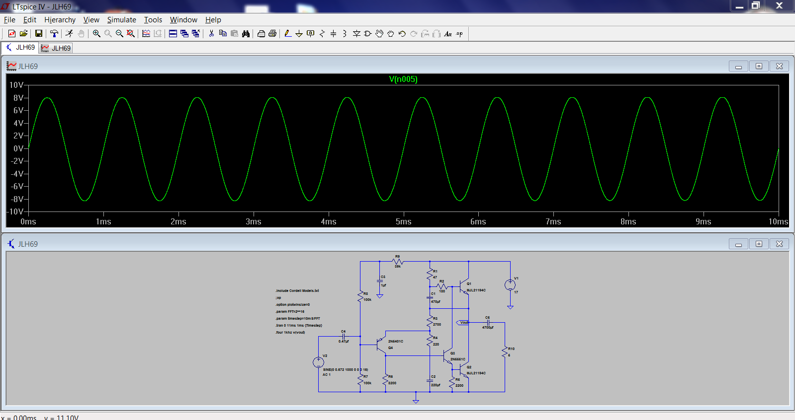

Look at these two pictures and look at the voltage scale. The first picture shows the amplifier running at absolute max output before clipping. Look at the sinewave and read of the voltage against time and imagine the power dissipated in the load (which could be a tweeter). The voltage doesn't spend very long at the maximum values.

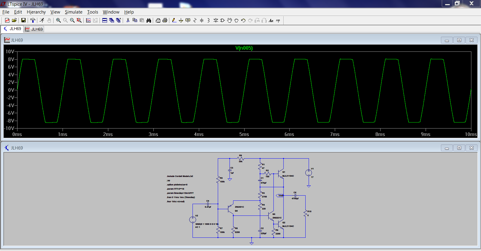

Now look at the amplifier when clipping. The max voltage is essentially the same but the load "sees" that voltage last much much longer. It's almost like applying DC. Tweeters seem to suffer the most from this effect because the voice coils have very limited power handling ability.
Yes since the Xmax of many tweeters is only .1mm-.3mm.
This long "Excursion" heats the tweeter and can stress the voice coil too much.
