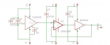

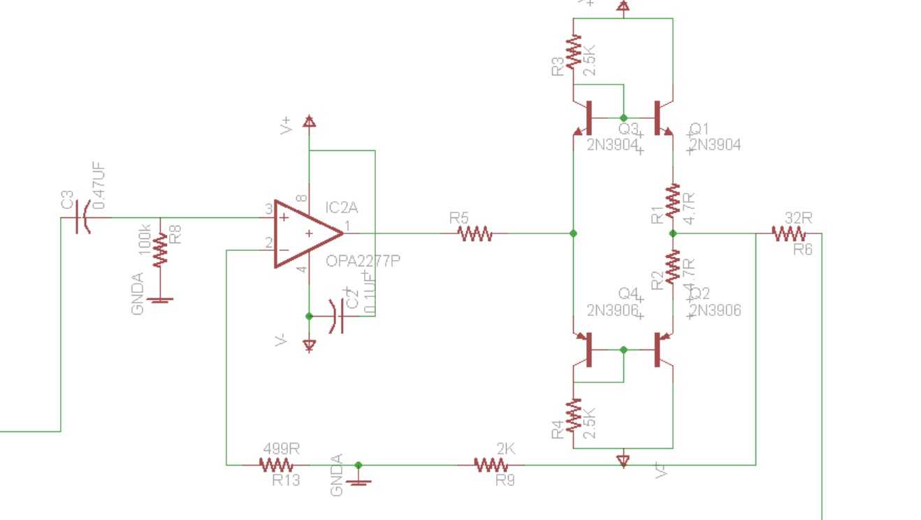

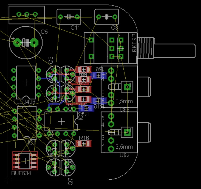

Need suggestions on my pocket amp design
I haven't finished the PCB layout yet but the components are pretty much stay where I put them
