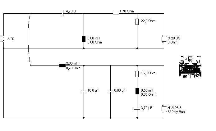

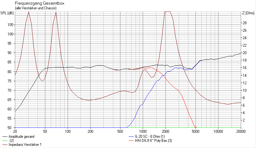

This driver HiVi D6.8 6" Poly Bass does not a very high SPL, more close to 82/83dB. With a different alignment you can get maybe more peaks, that's all, and have to adjust for living room. The ext. size is similar to the "Totem", with BR/Port on the same side as drivers, 38L/38Hz alignment. I did not check Xmax on this config. but should not be that bad.
You can use a L1 Air Core Coil (Erse type #EAC34-18-2000) on the woofer and a RLC circuit to smooth the woofer peak in parallel with L2 Laminated Core Coil (Erse type #ELC54-18-8500) and in place of C3 cap (3.70uF) you can use a (smaller only) 3.6uF cap that you can find.
This speaker X-over is using a Visaton (G 20 SC 8 OHM) tweeter with nominal impedance Z=8 Ohm (Rdc=4.8 Ohm). This his very important when changing your xover for your speakers because it all changes when using different drivers.

2-WAY X-over for HiVi D6.8 6in Poly Bass+Visaton G20SC-08

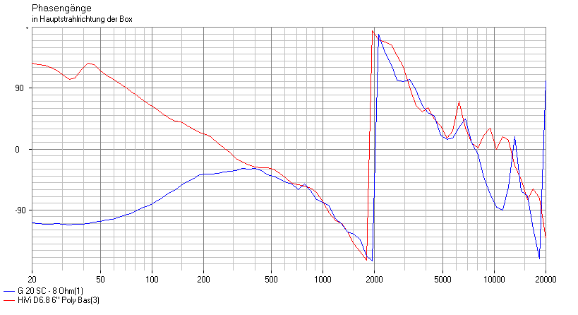

Woofer is at ~64cm from bottom of the baffle and tweeter at ~79cm, port at ~25cm all aligned in the middle of the front baffle. The drivers are also in phase from ~400Hz to 8000Hz, as you can see from graph#2, important for a good response and imaging (less nulls).

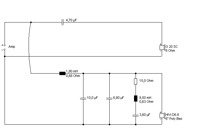

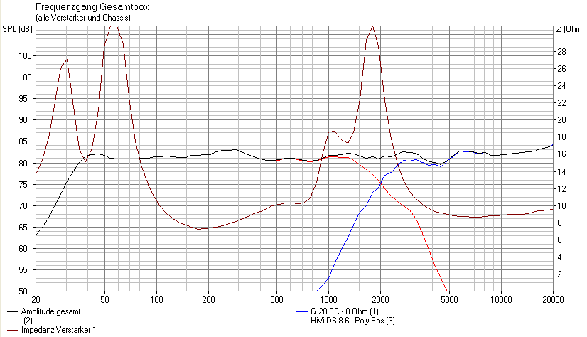

That's all very important information that people usually don't bother writing. The box with 14L can change everything. I initially was trying to have a 1.order xover but it doesn't seem to work very well. I will look at it. Same X-over with 14L/47Hz

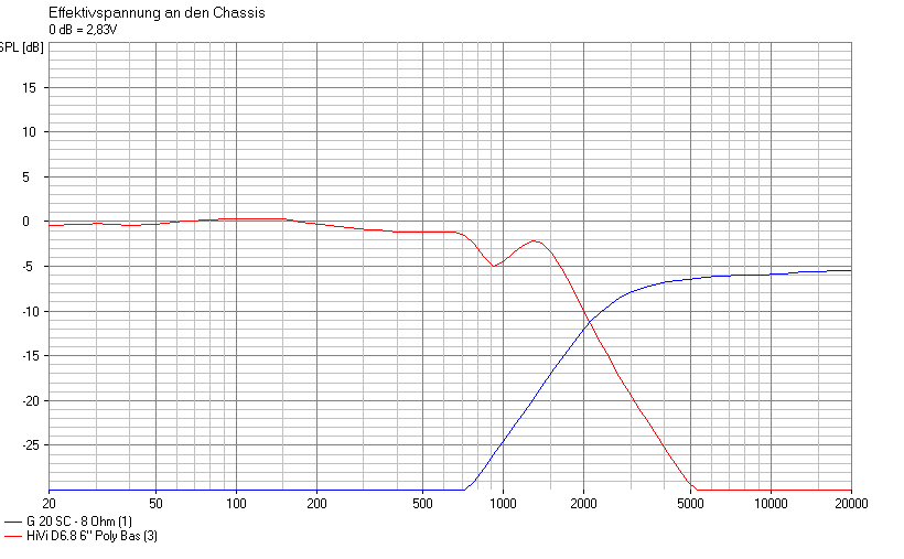

Same 14L/47Hz with different X-over with 1.order on tweeter (I'm using the Visaton tweeter). You can use the RLC (in parallel with the woofer) or not, but because this woofer is nasty, if you don't, you will have a peak of ~4dB@1kHz. Use a 15R power resistor, a L2 Laminated Core Coil type 8.5mH (type Erse #ELC54-18-8500) and a C3 cap=3.60uF for the RLC

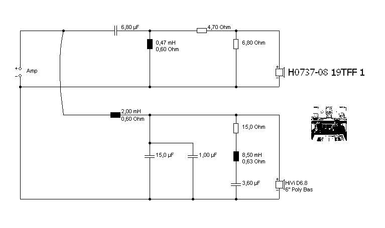

sivrat sent me a PM saying he's using:
HiVi D6.8 Bass-Midrange with tweeter SEAS H0737-08 19TFF 1 and needs a xover. (1.order/passive).
First I would not do that because of issues with phase on the tweeter. (nasty inversions of phase/nulls through the xover band with a 1.order on tweeter and a second order on the mid-woofer). So for a 2.order xover (passive), I would start with/from this (safer) simulation with the appropriate Lpad R1/R2 atten.(-7,5 dB) on the tweeter.
