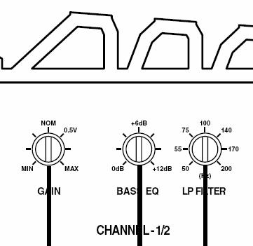

Little update on the settings...It seems the little gain adjustment on the amp this morning after I got into the parking lot at work made a world of difference. It seems to be hitting as hard as it was with my old Kenwood now but I think I still need to tweak the bass setup on it as I believe I have the gain right now. Adjustment some setting on the HU but not much and the SW volume can go up to 15 so I'm still doing great at 9 (Different HU, different adjustment on that as my Kenwood was at 3 out of 15 but then again I was cranking the volume at 28-29 out of 35)...
SW Vol: 9
Bass: 4
Treble: 0 (Was originally 0, screwed up in my post)
Treble Center Freq: 15.0 (Was originall 15.0, screwed up in post)
I have to go to the doctor this afternoon to get some stitches out of my elbow so I can see how much better it sounds and will let you know how that works 😉 Gonna read over yalls suggestions as well 😀
Yep, a lot of mp3's...I do that with all my CD's now...I burn them to my hard drive and then create a disc with the songs on it. That way if something happens to the CD's, I have my originals at home to make another back up of 😉 I noticed a lot in the way the different rates give you different sound. Why I like 320kbps compared to 192 😉 It's all working out though...
It goes up to 15 but I turned it down 1 and the bass up 1. Might see what I can do with the bass EQ on the amp. Turn it up a little more to compensate but it sounds pretty dern good right now.

If you have a bass eq on the amp you might be able to turn it up a little and gain down a little, problem is if its a fixed at 45 like most it will not help 30Hz. But it will make it roll off more above 50 that way so you can run the crossover higher without overloading the midbass but just helping it. If its adjustable set it to 40 or lower and try above.
