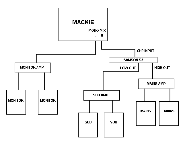

Like conanski said, it'll be easier if you do a mono mix.

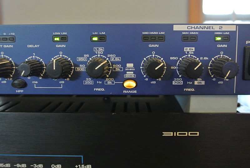

I've attached my S3 showing it in 2-way setup. For you, the RANGE light should be OFF. Then you have 35Hz to 800Hz. The LOW goes to your SUBS. The 2 knobs under the MIDS are inactive. The HIGH goes to your MAINS.
The next attachment is your system setup. The L and R Out from your Mackie are the same signals in a Mono Mix.
Hope it helps.
Hope it helps.
