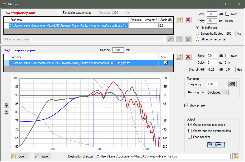

This case with VituixCAD Merger. Levels were already equal, but -28 µs (-10 mm) time offset was needed for near field response to match phase. Sharp transition (without blending) is okay at 470 Hz.
Almost the simplest possible task for this app.
