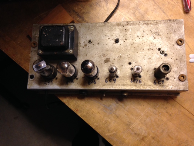

I'm looking for a schematic for this amp. It doesn't use the normal tubes except for output stage. It uses 6C4(2), 6AT6, 6V6(2), 6X5. Sound familiar to anyone? I'll send pics if needed.
I have no idea, I just know a lot of the gretsch schematics I have access to are for model numbers of that format.
Yes I agree. Most of schematics I have seen do not use the tubes i see in this chassis. I will try and post pics.

I have some other resources I will explore at the shop, but in the mean time, this is not a complex amp. You could sit down with paper and pencil and draw up a schematic from the circuit.
Judging from the tubes, the power supply will hold no surprises. The pair of outputs suggests push pull, but you can easily determine if it is single ended parallel tubes. Either way, the circuit will be conventional. I'd wager the triode next to them is a split load phase inverter.
That leaves a couple triodes for preamp stages.
I do this all the time for old amps I cannot find documents for. it isn't hard.

Ok so I have been playing around with this on the bench some more. This is what I think I know. I'm not sure that it is the original amp in this unit. When I power it up there is just alot of noise. Hissing, popping but not low frequency like ground issues. I have replaced all the resisters and the frontend tubes but none of that made a difference. If I short the input to ground noise reduces just barely not much difference. If I pull the 1st stage tube all the noise goes away. If I keep it in and ground the out from 1st stage to 2nd stage amp is very quiet. Again this is with new tubes. I will post the schematic of 1st and 2nd stage. It uses some resister values that seem very high to me. Also wondering why they use a low mu for 1st stage and then High mu for 2nd. Anyway seems like issues are in the 1st stage to me. Appreciate any opinions.
So apply a signal to the input, and see if it appears on the plate of the first tube. If so, then does it appear on the plate of the second tube? Do both plates have B+ on them? Your 15 meg grid resistors and grounded cathode tell us the two stages are "grid leak" biased. it may be difficult for your meter, but check that they are not open.
430k is a non-standard value these days. But noisy plate resistors can make a stage noisy. And check their value.
All of the resistors are brand new and were replaced by me. The tubes are new also. I will check the Plate voltages and look at them with a scope. I do believe that signal is at the plates. You can play a guitar through the amp but it is distorted and very noisy. Does the fact that I pull the 1st stage tube and the amp gets very quiet mean that is the problem with that stage. I was thinking about pulling 1st tube and injecting signal into grid of second stage and see if sounds quiet but still hear the signal amplified. Anyway i'll get measurements and post.
