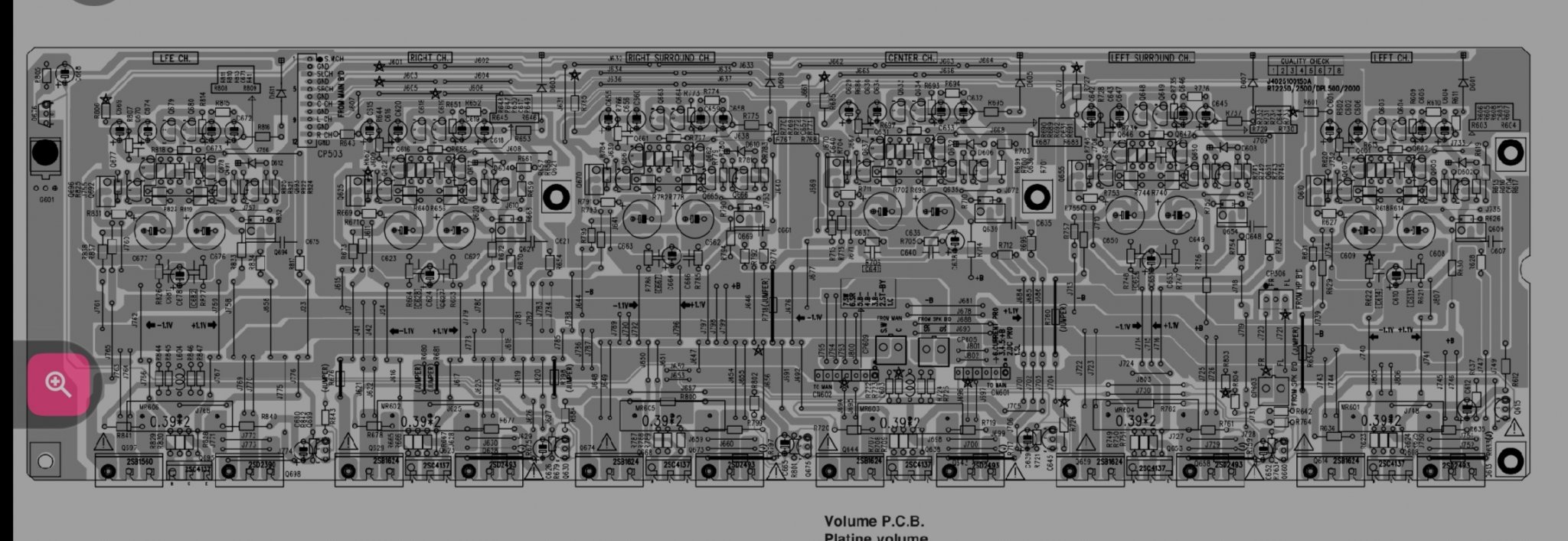

FWIW I found the Service Manual (which YOU should have included and where you pulled the PCB image) and it´s a VERY VERY complex receiver, where even plain servicing is scary.
And that, talking as an experienced Tech.

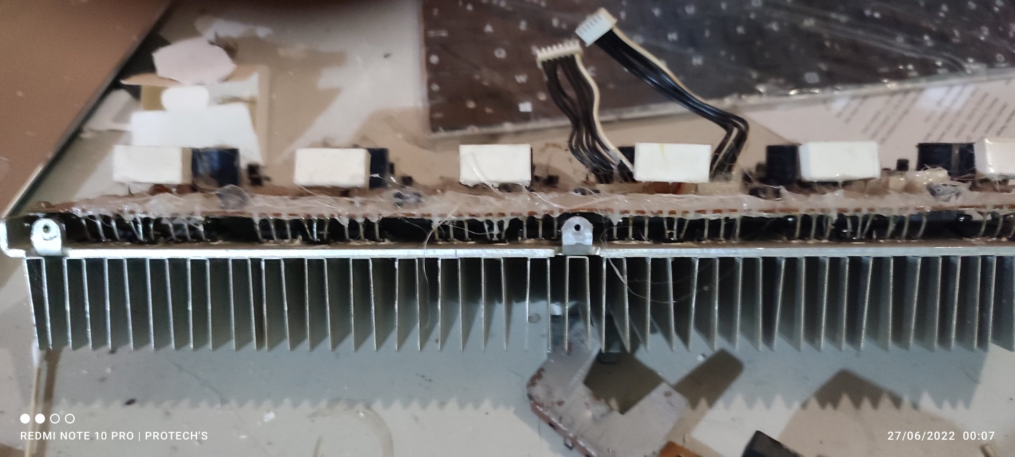

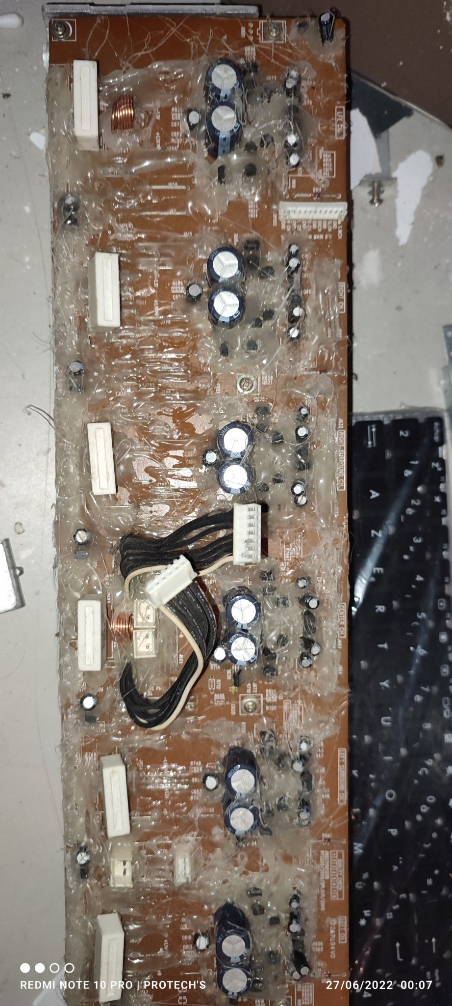

here i will join all the pictures of what i have and what i want to do, you already know i guess thanks to all of you ..
i have a lot off electronic material here actually i ve been studying this stuff for a time now let's say i'm entering action ..
i have many amps this pictures are from an Thomson dpl 550ht receiver and normally i have all the components needed just need some pcb's or advices.. thanks .
and please i have posted to question's about amps one is already ready and the other is about the STK's whom I'm shure they are originals cause i pulled them out a sony mini hi fi and an receiver 5.1 Hitachi from who i still have the parts laying around. i want to make an great amp with all of this piece's STK's. ic's ..... etc and add some thing's like a dvd motherboard i mean with out the cd player and front panel with the screen and memory card and USB... also thinking to add Bluetooth and a dac all this in one pretty box that gave designed specific for my first electronics work. p.s already done some reparations in the past but not like this where i want to go a step further very far..

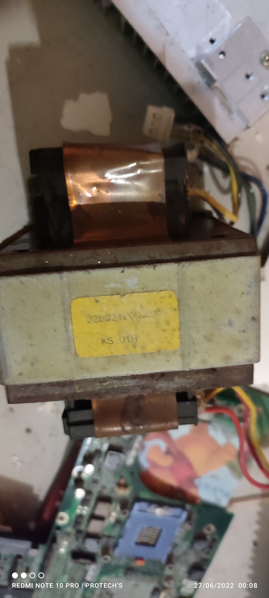

Ok, so far you have a power amp board with 6 of them, already mounted on a heat sink.
That´s the core.
You also show a power transformer, which should be connected to a PSU (which I can´t see).
I´d start by connecting that transformer to Mains, and read voltages available.
pleas post what you measure.
For safety use a lamp bulb current limiter,a 100W bulb should be fine.
A real glass and hot metal bulb, not a LED one.
IF it works then you can connect it to power board.
Measure rail voltages at each board and check you have Zero DCV at speaker outs (all 6 of them). up to 100mV DC is acceptable.
IF all work, try connecting a speaker at each one in turn, and feed some Audio at the proper input.
IF all work, you can wire all inputs to a set of RCA connectors and use that 6 channel amp as you wish.
Don´t even dream of DIY building a decoder but you will probably find one at EBay or AliBaba or equivalent.
PRAY everything works, I would HATE to work on that hot glue covered PCB and so will most Techs (except masochist ones, of course).
