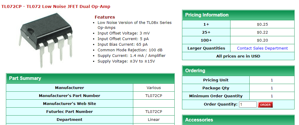

I need a standard pinout dual 8pin DIP OPAMP that can reproduce a 100khz square wave at 2.5vpp with reasonable fidelity. An LM318 would be a good choice but it's a single package only. My application is a distribution amplifier. Using the 5x rule of thumb, the OPAMP should go out to 500mhz at -3db. Gain is unity using +/- 12v rails.
This is not a quality audio application. The signal is called Time Code and is normally a 1200hz/2400hz data stream that represents time as hrs/min/sec/frames. Quite common in the recording and broadcast industry. It was designed to be recorded on standard analog audio tracks or better yet optimized electronics for high frequency. As the signal is Manchester encoded, as long as the zero crossings can be detected, it will read properly. So again a perfect square wave is not necessary.

If you allow a 1 µs transition time, 5 V/µs is the bare minimum required slew rate. It sounds to me like a TL072 should do, if it can handle the unspecified load. An NE5532 is also fast enough and better at driving relatively low impedance loads, but the antiparallel diodes between its inputs might be a problem.

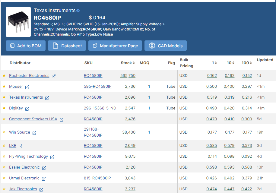

TL072 is pretty cheap; RC4580 and RC4560 are cheaper still.

If the RC4580 (12 MHz / dual / PDIP8 / $0.09@100pcs) is too expensive, you could do the job with three 2N3904/6 discretes and some resistors. Their fTs are guaranteed 300 megahertz, and their saturated switching delays are waaaaay quicker than what is required for 0.1 MHz clock and data rates. Instead of building a nonsaturated (ECL) logic gate, turn back the clock to 1962 and build a boring old saturated (RTL) logic gate using today's thru hole jellybean transistors.
