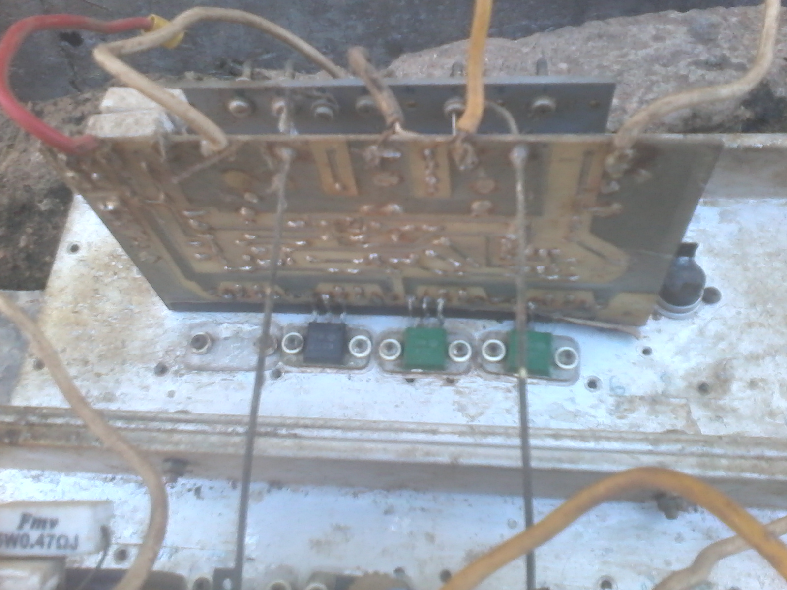

need of serious help k227 & j83 mosfets
To substitute transistors, we need to know the application. i.e. the brand and model number of your amplifier, receiver etc. If it's a hobby magazine design, the year of publication and title would make it possible to identify. So if you can provide this information, perhaps with the power supply voltages to the amplifier and the specified 8 ohm output power rating, someone may be able suggest what is possible with some assurance that it will work properly.
🙂Thank you for your fast response, the amp chassis i think is a project one no details at all ,the boards only marking is ( sc500 ) and i could just make out letters SA.1 _huttle , (Shuttle) i think ? transformer out put is 80-0-80v , PS caps are 100v 4700uf x4

Apparently, they are early plastic versions of 2SK135 and 2SJ50. They have a wide backplate with 2 mounting bolts, something like MT200 width, rather than current TO3P, TO256 and TO247 style components that use only 1 bolt mounting.
Possibly, and if they are still available, 2SK1058/2SJ162 or ECX10N20/ECX10P20 could be substituted by drilling new mounting holes but higher rated parts may be necessary in this application. I just checked Profusion PLC's website and their Audio Mosfets section has a speed error (6019) message...hmm.
OK, I tried another route and all is OK at Profusion......The price however, is ₤5.17 each + postage, so this isn't going to be cheap. No, don't try cheap fakes in the hope of repairing something - it doesn't work either when you find there is a Hexfet type instead of a Lateral type mosfet inside the package :bigeyes: Renesas 2SK, 2SJ types are from other sources like Digi-Key or Ampslab in the US, in my experience.
ok,cool on my side of the earth, the k1058 were no longer in the catalog in Profusion.
after, I repeat but it is also easy to buy a C-audio amp st 600 or st 1000 with a broken down or even perfectly functional, to have a safe source of k1058 and j162
