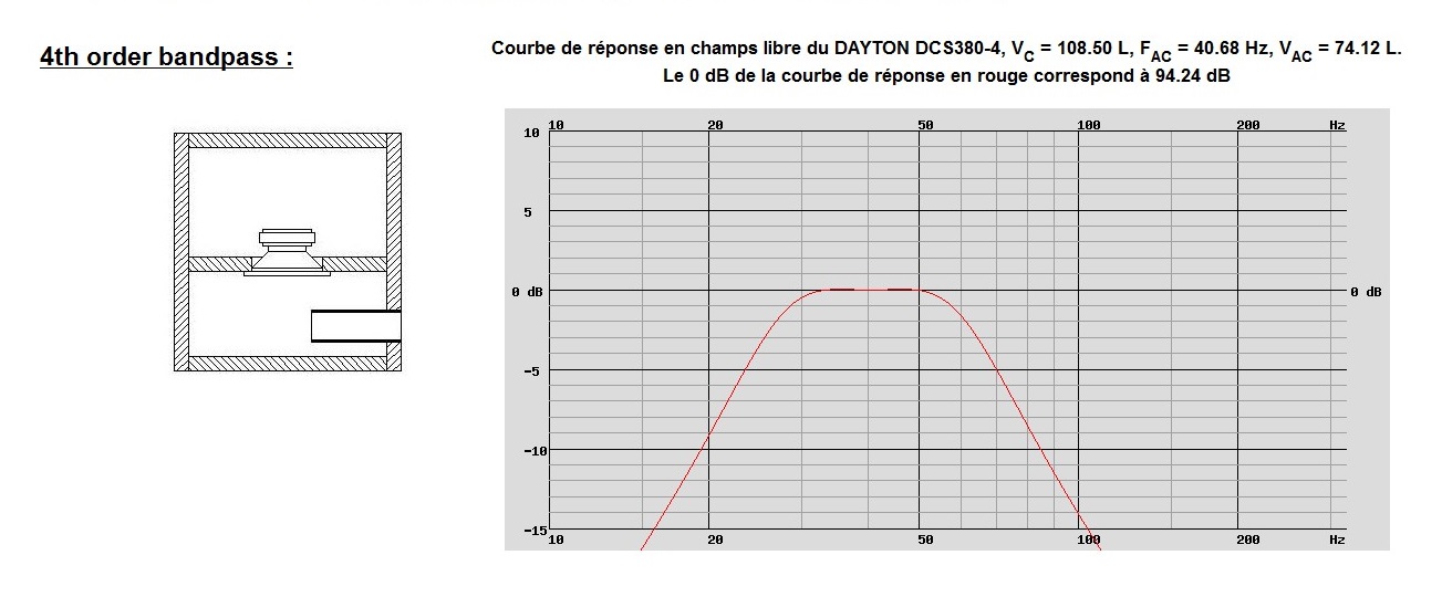

My fraternity needs new speakers. These will be used in the basement (big room) so they will need to fill a large area with loud sound. The main goal of this project is to create loud chest pounding and hair moving speakers. While still keeping it cheap. I was thinking of going with either the dayton 15 PA's https://www.parts-express.com/dayton-audio-pa380-8-15-pro-woofer--295-034 in a 2-way or dayton 15 subs in a 3-way https://www.parts-express.com/dayton-audio-dcs380-4-15-classic-subwoofer-4-ohm--295-470. So which one would be the best for this application. Thanks
Dayton Audio DCS380-4 15" Classic Subwoofer (2 sub drivers)
Dayton Audio DCS380-4 15" Classic Subwoofer 4 Ohm
4th order bandpass
-3 dB 26 - 65 Hz
-6 dB 23 - 73 Hz
VC = 108.50 L internal sealed, FAC = 40.68 Hz tuning, VAC = 74.12 L second reflex (BR), 94.24 dB/2.83V/m (each)
Port (2x) = Diam: 4" (10.2cm)/L: 11.90" (30.2cm)
L1 = 2.5 mH (power) use one inductor in series with each driver if needed (not active or EQ).
6 db Crossover Table
Dayton Audio PA380-8 15" Pro Woofer (1 main driver)
BR type
F-3 dB - 56 Hz
F-6 dB - 47 Hz
VB = 50 L, FB = 44 Hz, ~97 dB/2.83V/m
Port (3x) = 3" (7.6cm)/L: 13.6" (34.5cm)
