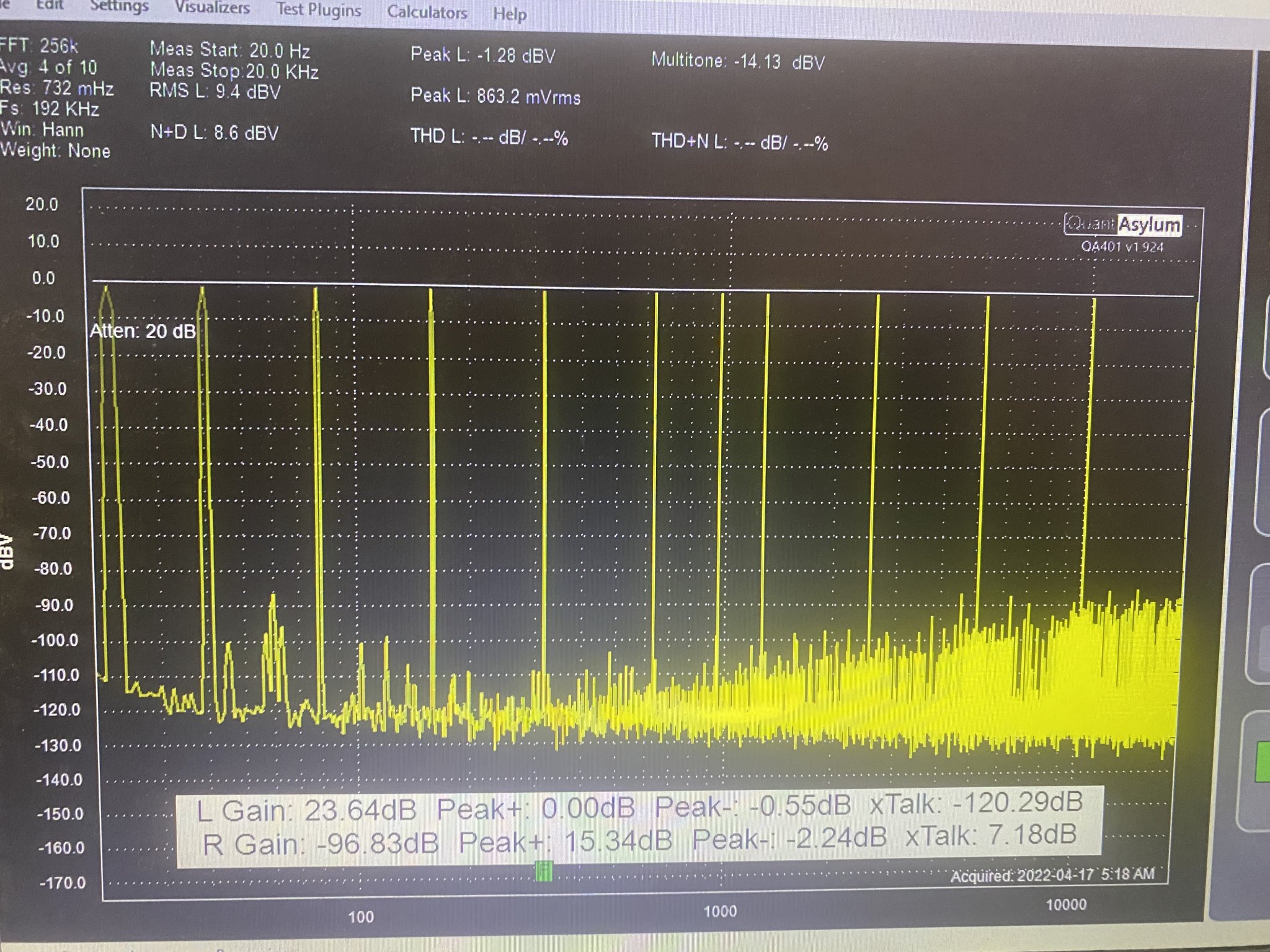

Hi guys. I'm trying to modify an amplifier. I'm definitely a beginner. So, I started by increasing the bias to 10mv across the emitter resistor. But, It doesn't make any noticeable difference in the FFT measurement. I bypassed the entire preamp board. Sending the signal to pins 5/6/8/9 on page 9. It will be actively powering 4" mids and tweeters. So, I don't need much more than 10-20w.
I've tried lowering the value of R145 as well as R121. It does seem to have excessive gain. It's a car audio amplifier and the DSP has up to 4v of output. So, I'd like to make use of it and have a low noise floor. I've also replaced the sanken 2sa1303/2sc3284 with MJL0302/MJL0281 because they were out of spec. I matched the Beta of the devices within 1 or 2. I also replaced the rail caps with MKP Nichicon and all small value caps with WIMA and all through hole resistors with 1% or less low PPM value. All electrolytic caps with polymer. Emitters with Ohmite etc.
I'm trying to reduce the high-frequency distortion. Attached a multiband measurement. It measures nearly exactly the same with 0mv across the emitter and 10mv and 15mv.
Should I experiment with local feedback? I've been told that it probably has too much gain in the front stages.
Any tips where to go from here?

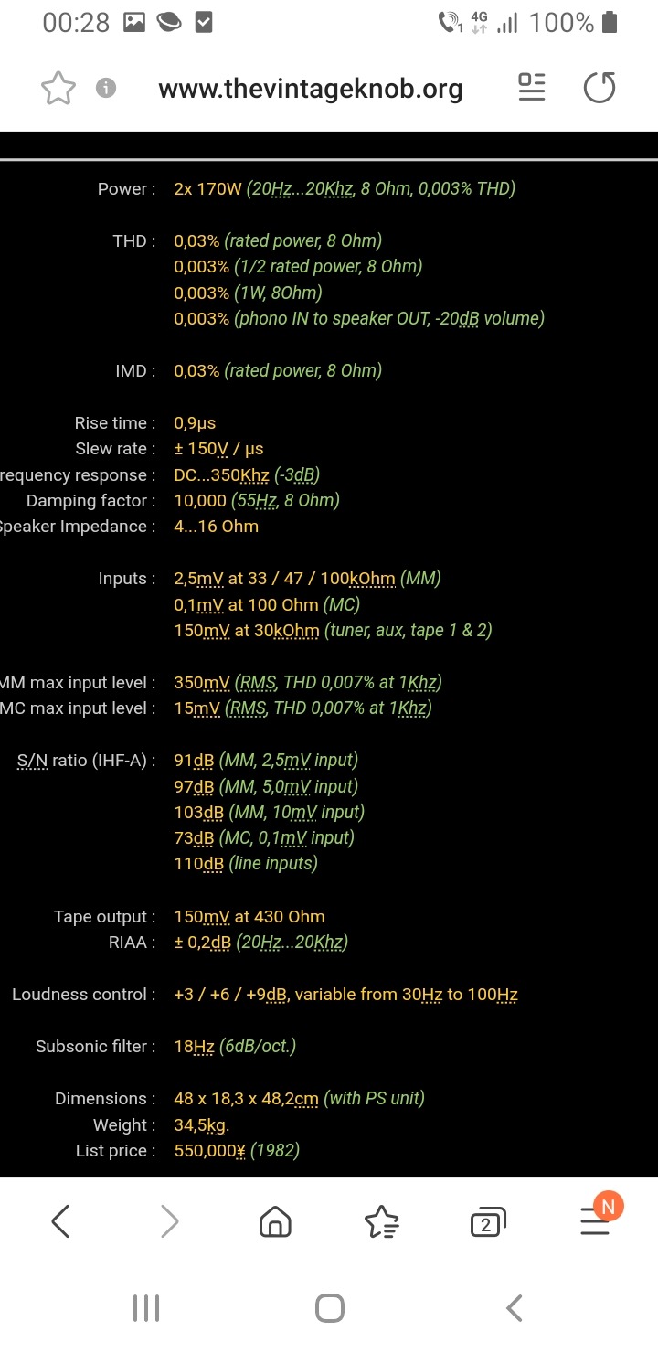

If you look at the provided multiband measurement. Distortion is near -110db in the midrange. 1k fundamental third harmonic is 0.009%. This measures really well compared to most other car amplifiers.
My home Emotiva Class D monoblocks are only -80db throughout the entire spectrum.
I'm simply asking for advice on how to reduce the high-frequency distortion. If I can experiment with adding feedback in different stages of the amplifier to lower the gain in the front end of the amplifier. How do I do that? I've been reading about simply adding a resistor to loop the output back into the input. Can I try this without harming anything?
Why does it measure the same with zero bias and alot of bias and everywhere in between?
This does have a huge heat sink and 3 fans and it measured better before I even started on it than new $1000+ amps.

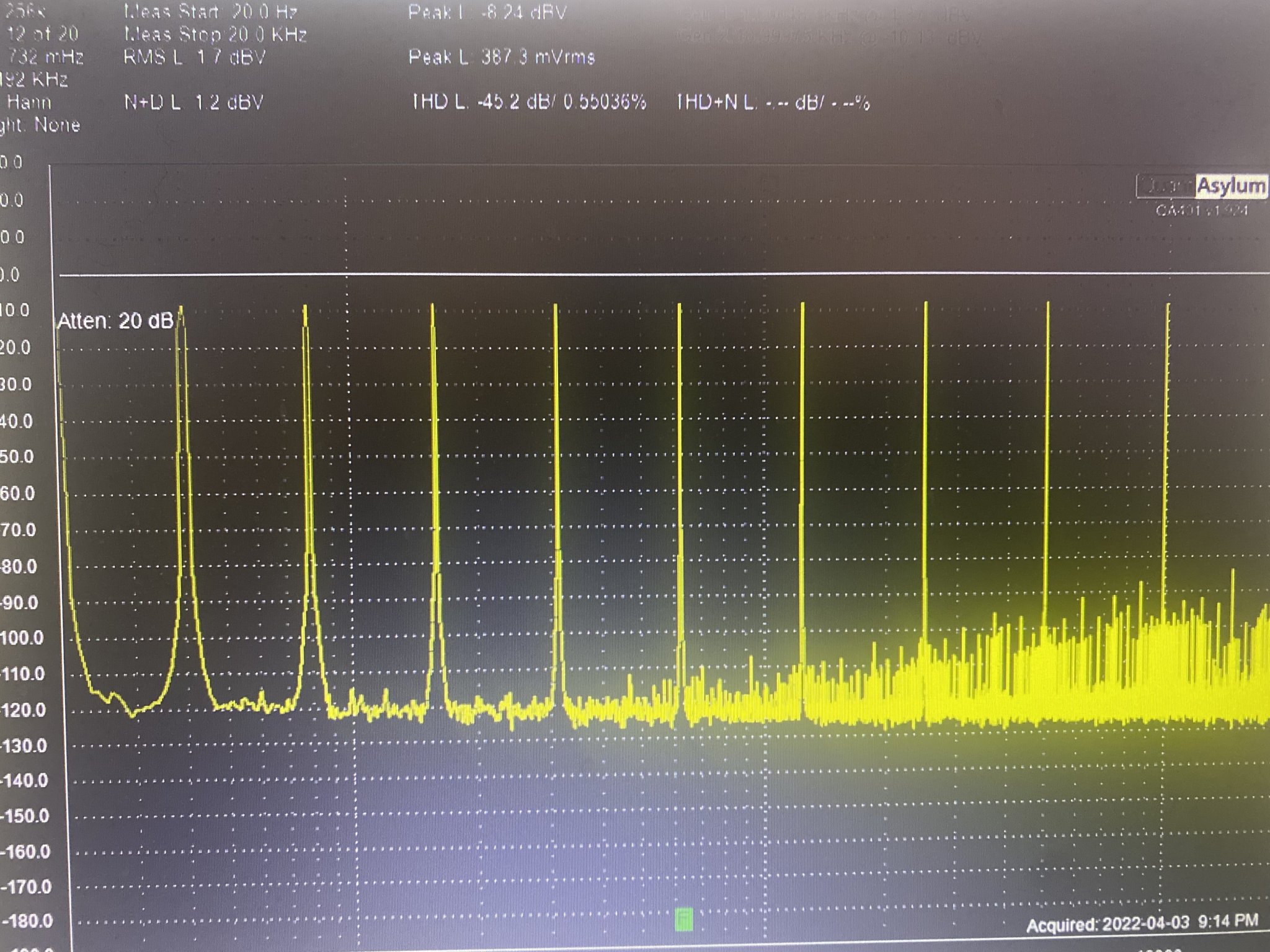

Initially I posted the wrong measurement.
Even with the preamp board completely removed. It still has significant gain.
On two channels I’ve changed the R145/R146 feedback resistor from 43k to 10k and gain is a little more manageable.
That's with a 4 ohm resistive load. I can increase the bias enough to max out my 10A current limited supply.How about putting some signal before you measure let's say a 1kHz sine?
If I use a 1k stimulus. Increasing the bias will help slightly with high-order harmonics. But they barely appear at all.
But, Any other amplifier I've worked on. 0 bias is super bad. 10mv makes an insanely huge difference (Most car amplifiers use a 0.1ohm emitter with single pair)
I'm wondering how I can try decreasing the amount of gain at different stages of the amplifier and how to try local feedback at each stage.
It has very low distortion in the low frequencies. So, I'm wondering if because feedback comes from the main output and it has a few stages. That the feedback is too slow to be completely inverse phase from the main output. So maybe local feedback might help?
