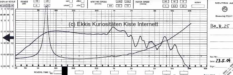

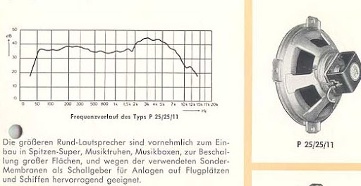

I need some help with any info or specs on a few drivers. I got all of these in a single (AWESOME!!) deal from a local dealer (along with a pair of Peerless HE tweeters). [Thanks again, Andre. You are the BEST! :happy1:] I intend using them in a pair of 3-way, OB speakers. :smash:
I need some info on the following drivers:
1. Isophon B25A full-range drivers,
2. Sansui W100 10" woofers (from the Sansui SP100), and,
3. Pioneer PW302a 12" woofers (8-ohm versions, from the Pioneer CS-A31A speakers)
All these units are alnico. From the info I have found it seems that the Isophon B25A are full-range drivers. The only manufacturer's frequency response graph I could get was for the older Isophon P25/25/11, and they have a response plateau between 2kHz and 7kHz (see pic below). The other frequency response graph I have is from a German site (cannot remember the address). That graph is the 2nd pic below.

IMO the Isophon looks more like a wideband midbass than a fullrange.
The Sansui and Pioneer drivers are probably more like ~90-93dB/W/m. Sensitivity was not measured the same in the Kabuki-speaker era. My guess is they have somewhat high Qt and the 12" should do OK on a large OB, but probably will run out of excursion fast. The best might be to use it in an enclosure similar to the one it is originally from.
With a miniDSP or other active Xo, it would be easy to set-up an EQ'ed sealed box for either the 10" or 12" driver, low Xover, say ~100-200Hz, use the Isophon from there up to ~3-6kHz in dipole config and passively bring in a helper tweeter above this, preferably a small horn with restricted dispersion to match the Isophon cone. Roll-off the Isophon with a single coild if it's natural top-end response is not smooth. An active Xo will also mitigate sensitivity differences between the drivers, assuming correct amplifier power is provided to each. Not 100% OB as you intended, but you'll get better performance out of these given drivers IMO. The best would be to measure the TS parameters to know where you're headed.

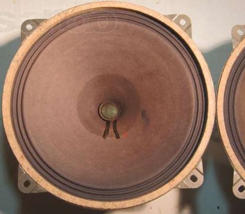

Oh wait. Is this what the 10" Isophon looks like? I don't see many options there for modifying. Looks like they've added varnish or something to the centre of the cone to raise the HF response.

I have received my drivers!
Today I picked up the box with my drivers.
Now the fun can really start.
They are one pair of 10" Isophon P 25 A wide-range drivers:
A pair of 10" Sansui W100 woofers from the Sansui SP100 speakers. The last pic of the hefty ALNICO magnet:
A pair of 12" Pioneer PW302a woofers from the Pioneer CS-A31A speakers (sorry for the out-of-focus images):
And a pair of 2" Peerless cone tweeters (last pic in comparison with Isophon P 25 A driver):
