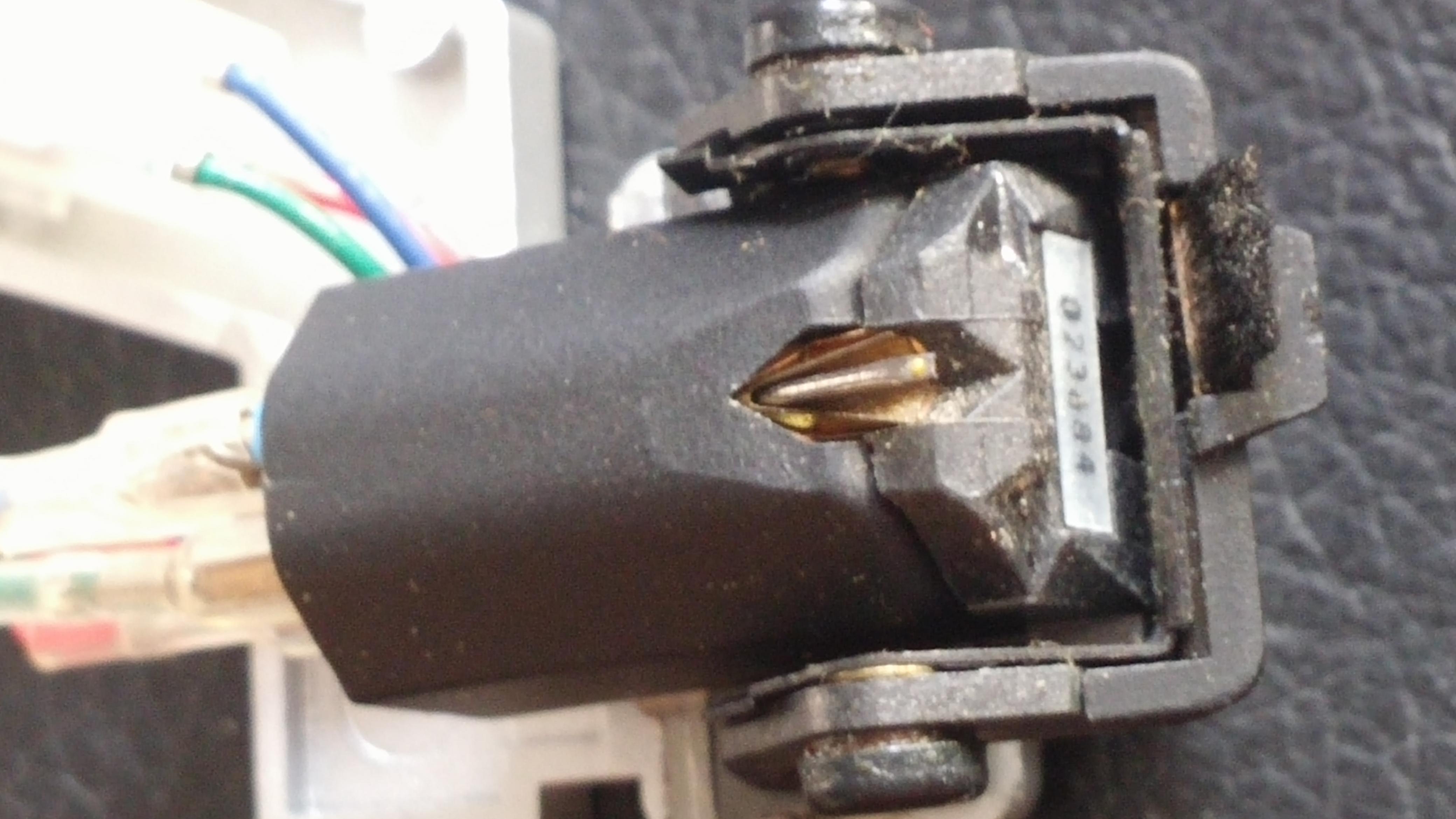

It has a low numbered serial number, black on silver label. No lettering on body.

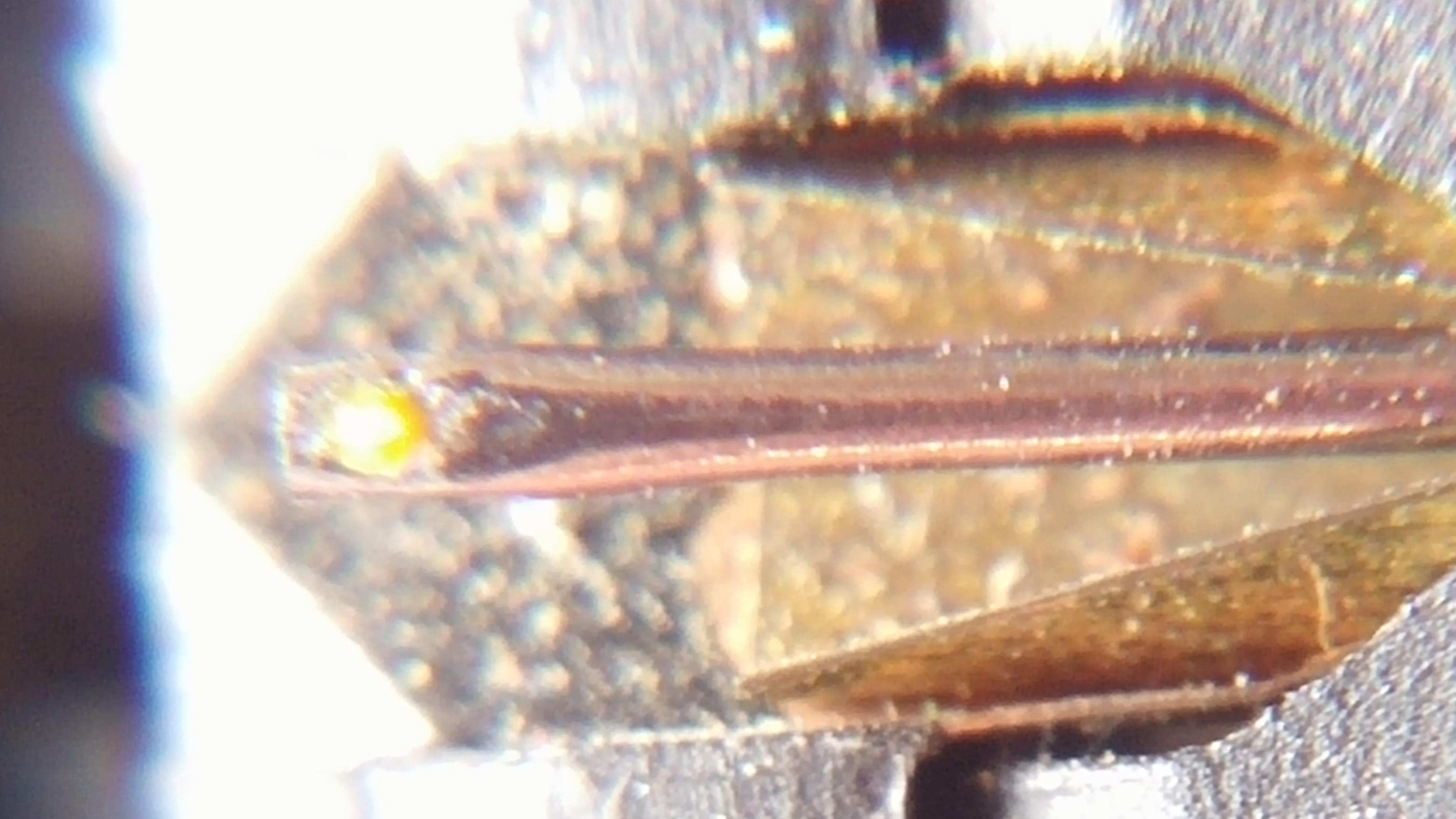

Any idea what this looks like (besides dirty)? HE tip or MR or what? I stuck a loupe on my LG G3 to get this. I can retake to show something more identifiable if need be.
Try reposting the photo directly.
It's a good picture, unless I am mistaken that cantilever looks like boron/be or similar. (Not AL)

How is this?
Oddly, the closest description is for the VN-5P, but that can't be right.
Maybe Shure can look it up from the serial number.
just to clarify:
all the V15V with HE (hyper-elliptical - VN5HE stylus) diamonds also had beryllium cantilevers (V15V - V15V B - V15V P). And the "silver SHURE on black background" refers to the colour of the "black" stabiliser - (not the colour of the serial number on it's label).
the VN5MR stylus - has a bronze stabiliser - (silver SHURE on bronze background/stabliser)
So the stylus in Nunthewiser's pictures is a Hyper Elliptical VN5HE stylus (silver SHURE on black background/stabiliser) and his cart body is a V15V.
