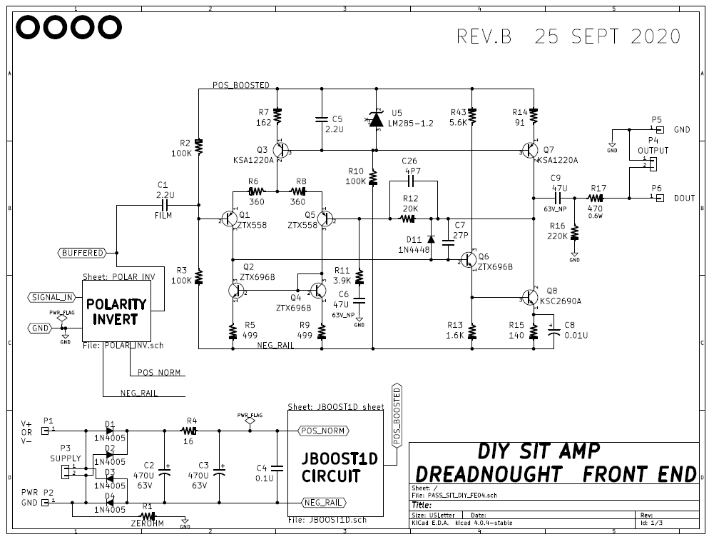

Hi, I need some advice on what transistors you guys would advise for the input stage of an amp running +-45V DC rails.
Also need giudance on a good selection for the smaller transistor to pair with the C3503 VAS transistor.

It would help if you posted the schematic .
"input stage of an amp running +/- 45 DC " is too general as is "VAS transistor " .
If you are designing it you could at least post a penned drawing of what you want to achieve .

Sorry I don't understand RS Components South Africa as well as I should. It appears to me that they do have the Zetex PNP/NPN pair 558/696B in stock, if I interpret the green box correctly
PNP sales page
NPN sales page
These are 400V (PNP) , 180V (NPN) rated transistors. I used them in the "Dreadnought" front end of the VFET DIY amp sold through the diyAudio Store, and I'm very happy with them.
Other Zetex devices to consider: ZTX457 , ZTX458, ZTX857 (NPN)
ZTX795A, ZTX957 , ZTX958 (PNP)

The reason I didn't attach the circuit, is because its just the standard blameless we all have seen here a million times.
I made a couple of these boards as part of me learning kicad. Sounds good though.

Interesting, after your reply the other day I bought a few hundred ztx558 and 560, as well as 458, not to mention about 1000 bc557c/547c.
After that, I ran out of ideas! (Once upon a time a I had a small stash of thr Zetex versions of BC107c which were very good, I wish I had saved those!
As you are duplicating Self's Blameless design, perhaps you are aware that when faced with the same availability problem some years ago, he simply altered the small signal semis (all of them) to MPSA42/92 types. It's evidently non-critical to his design and test purposes, as long as the source is original On-semi and not cheapo copies.
