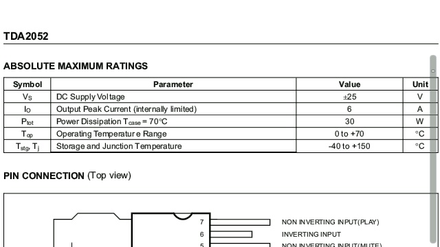

Im building an stereo amp with 2 TDA2052 IC. The Datasheet says it will need 25V(max) DC power supply to provide 60 watts in 4 n 8 Ohms. Now i just need a power supply diagram with full details that will provide max 25V DC.

For that output power I can imagine +/-25V. In my experience the TDA2052 will trip the SOA protection with more than +/-20V into 4R loads and +/-26V (or less) into 8R. With some professional 10" 8R speakers they trip with +/-22V. So is good to limit to +/-20V in dual supply or +40V in single supply (some good dual 14-15Vac/3A/ch trafo here) and in my personal preference I attach the IC directly to heatsink and I isolated the heatsink from case since the TDA2052 case is connected to -V because is made with classic NPN technology like most chips so die substrate is connected to -V.
These protection trip disables the IC so "mute" the output for some time, so is annoying.
The TDA2052 is not too fast (less than 7V/µs) so is very good to experimenters.

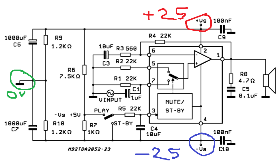

-/+25 volts means it is a 50 volt supply in total with a centre zero point. This is the most common arrangement for amplifiers and allows direct coupling of the speaker with no capacitor.
A single 25 volt supply means that the amplifier is capacitor coupled to the speaker.
The transformer would need to be a single 15 volt AC type for a single 25 volt DC rail. For a -/+ supply you need a 15-0-15 volt AC type (a dual secondary) of around 160va rating.
The capacitors need to be around 3300uf to 6800uf and 35 volts DC working voltage (or higher).
If you show us the circuit then we can advise better.
This is the typical circuit for the TDA2052 and this uses a dual supply.
(I think you need to make sure you understand how this all works before building the amp)

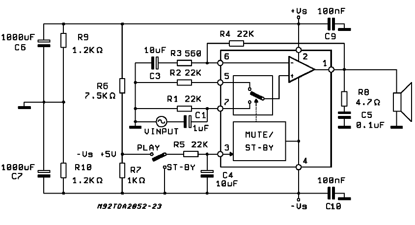

here all details 😀 and 1 question, to an audio amplifier which is more important, supply voltage or more current???

You need both the correct voltage and also to have enough current available for when the amplifier needs it.
I was thinking of 18-0-18vAC 160VA transformer. is it will be too much??
That's to much. The voltage will always be higher when lightly loaded anyway. A 15-0-15 is perfect.

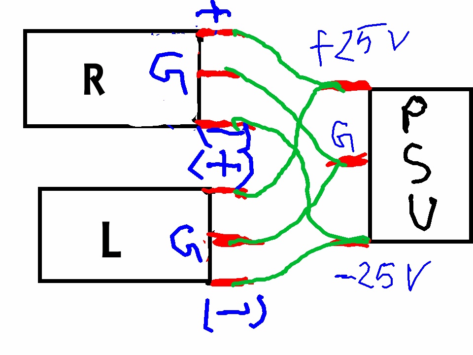

i want stereo!! should i connect them with PSU like this???
Get each channel working on its own first and then think about wiring it for stereo. Getting the grounds correct is important to stop any hum.
