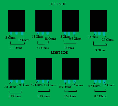

hmm..
I went ahead and tested all of the output transisters as well as the FETS, whats a Bad ohm rating? cause they all seem to be reading at the very least 10's. But i do have a question, the inner leg of the FETS all read 0 Ohms... Thats Normal Correct?

Ok, well its apparent that i am useing my ohmeter wrong... or something. I am connecting the Positive Lead one of the legs and the Negative/Ground to another... Should i be placeing one of the leads in the Ground or Battery Connectors for the Amp itself? because when i connect one of the leads to say 2-3 i get a Solid Ground.
I firstly need to appologize for all the double posting im doing. unfourtunately im under the assumption that this forum does not posses the Edit Button. So that being said, let me go ahead and clearify a few things. I'm kinda learning as i go 😉 hehe. Well, I am connecting the Negative lead through the Battery+ and using the Positive Lead to test the Legs of the Trans. and FETS, I am almost positive the FETS are all good. The Trans. on the other hand have me a bit confused... Still connecting the Negative Lead through the Battery+ connector, and when i connect the Positive Lead to all three of the Legs of the Trans' i get readings around 10 Ohms. i am currently working on determining whats going on with the Ohm readings when i connect the Leads to the Trans. itself... When i connect the Positive to Any of the Middle Legs and use the negative lead on any outter leg i get a ground. Not suprised with that, if im not mistaken thats correct right? Now as i am testing here at my desk, i am finding that when i ground leg 2 and measure 1 i get a ground, on All of the Trans. and when i ground Leg 3 and test Legs 1 and 2 i get about half an ohm as a rating... This is all getting so confuseing as i am getting MANY diffrent readings now. So for now i shall stop and wait for an answer. Thank You Perry!

Touch and hold one meter lead to the center leg of a transistor. Then touch the other lead to first the left leg of the same transistor, notice the reading. Then take the lead off of the left leg and move it to the right leg of the same transistor, notice the reading. Check all 8 of the outputs in the manner stated above.
The test procedure suggested above will work. If you want to understand more about the testing procedure, go to the 'Checking Bipolar Transistors' section of the basic repair page (link below).

Pull the 2 rightmost transistors on both sides and check them out of the circuit.

By yank you mean desolder and then check?
Yuck... I dont have a desoldering braid handy so its gonna be a day or so...
Are those ohm ratings bad or do you think it could be a diffrent component possibly?

You do not need desoldering braid to remove the transistors, actually you need to add extra solder to each connection of the transistors. You will need the desoldering braid tomorrow before reinserting the transistors. Perry will give you instructions.
so, heres my question before i dive into this project. So there really Might be Hope for this amplifier? Sorry, but im confused what technique are you refering to when you say add solder to the connections? And the biggest thing about repairing this amp, is that i realllly dont want to have to purchase a bunch of components off of a site like Mouser. Their Shipping Is Ridiculos. Otherwise ive got no complaints. I just want this thing to work =]
If you apply additional solder to the solder pads of the transistor and lay your iron down across all three terminals, you can heat the solder on all of the terminals at once and pull the transistor without desoldering braid.

If you pull the 4 transistors and you find that only one of each part number is defective, reinstall the two that are not defective/shorted, clamp the transistors to the heatsink (VERY important) and power the amp up via a 10 amp fuse. If it works properly, order 2 of each of the defective transistors (so you can replace all 4 in the defective channel).
So let me take a stab at clearifying what you said..
Ok, so you want me to remove the 4 Transisters that you mentioned in your previous post (two on far right, on both sides of amp) Test them to see what ohm rating they give, reinstall the ones that are O.K. Clamp them to the Heatsink, which i have a question why is that extremely important.. I only ask because i kinda sorta tried to power on the amplifier with them unclamped, just so i could test... 10 Amp fuse, and heres my other question.. You want me to power on the amplifier with the Faulty Transisters Removed? and if it Powers On it means i need to replace the ones that are faulty? Which would mean i need to replace them all on both sides? or are the transisters identical on both sides? Im sorry for all this confusion and such, as i stated before im a newb at this kinda thing...

Without being clamped to the heatsink, the transistors can fail within seconds. They can fail before you know that anything is wrong.
There are two parallel transistors per rail per channel. The amplifier can operate with only one transistor per rail per channel. Since it's rare for more than one audio output transistor to fail in each parallel group in an amp like this, it's likely that you will have one transistor of each part number that are in good working order. To determine if there are other problems, you'll reinstall the good transistors to see if the amplifier will power up and produce audio. If the amp powers up and both channels produce clean audio, you'll only need to order the 4 output transistors. If the amp has other problems, you'll continue to troubleshoot until you find the rest of the problems. This can save you from having to place multiple orders for parts.
