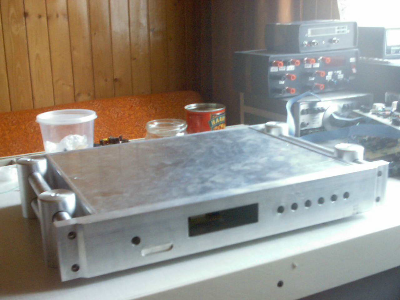

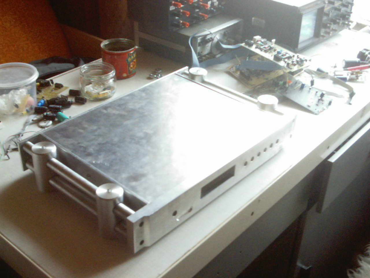

I have almost finished my code. Meanwhile I did my casing for DAC.
I designed my DAC in CAD and brought it to craftsman. I post you how he did it for me. I think , I will finish all in month.

Really nice.
Is it standing on the four cylinders and if so do you have any kind of feet for them?
That's looking really good. And rather large too. What are it's dimensions? And how is it finished? Anodised, or polished? Will we see it with the lid off?

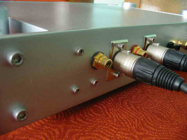

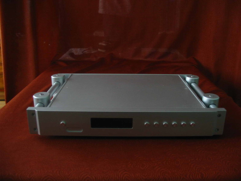

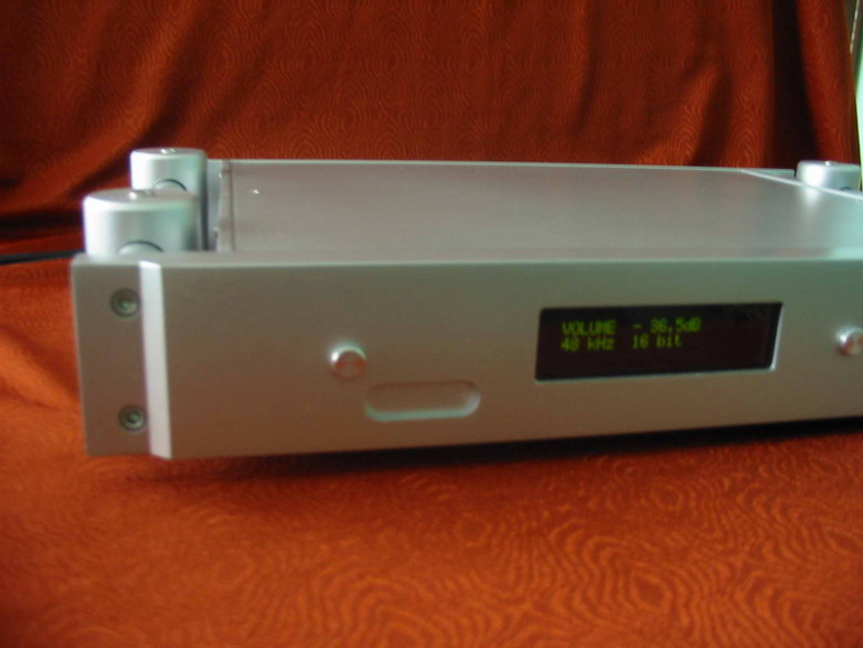

I have finished my dac at last. There is only inscription to do on my chassis. I think that silk-screen printing will be a good idea.I post you some photo. Tell me what do you think about it.
