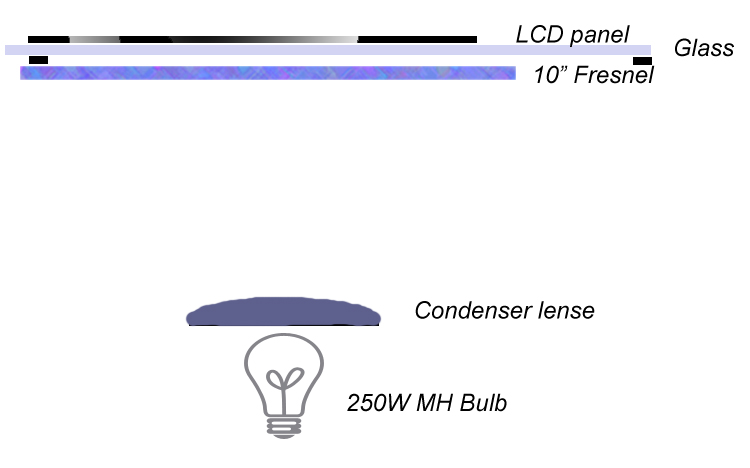

OK, today, after a month of waiting, I finally got my 250W MH kit, and triplett lense from Alan @ DIYlabs.org. He was cool, and threw in a condenser lense with my order. I'm not too sure where to, or how to put this lense in the light path. It should go somewhere between the lamp and the fresnel correct? As far as the order of my components, this is correct, right? (Minus the triplett lense) P.S. the ribbon extension isn't going as well as planned. i'm trying my third attempt at it tomorrow morning.
