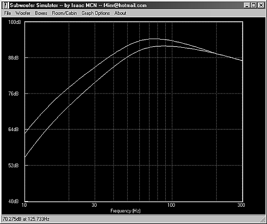

How about a Peerless CC 260, or 831727 in a 28 liter, (1 cu ft) box, tuned to 30 Hz?
The box is only a little bigger than your planned box, the 10 inch has a pretty long throw. I will explain later, but it has a symmetrical magnetic system that in a ported box, will give much less distortion than a non-symmetrical system-and the TangBand does not mention a symmetrical system, which means it probably does not have one.
The Peerless is more efficient.
The simulation is by Subwoofer Simulator, written by our own F4ier.
The lower line is the response not counting the room, like most modeling programs do it.
The upper line includes standard room response-actual room response may vary.
The room response was an option added by our own member, Serow.
As you can see, at 30 Hz, even without room response, you are down to around 80 dB.
With room response, you are up to around 86 dB-more efficient than your TangBand even in the midband!
Price isn't much more than the TangBand.
http://www.partsexpress.com/pe/pshowdetl.cfm?&PartNumber=297-616&DID=7
You can always make the box bigger if you want, for even better response.
To tune it so low, you might get some port noise, but not too outrageous. This is a computer system, right? And a slight increase in box size leads to less port noise, if you want to get bigger.
Nice deal, I think.

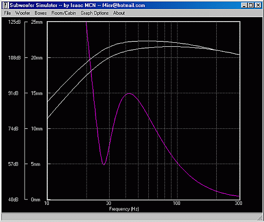

Isaac,
I've been messing around with your program some more and now that I know the parameters it's easier to use. I did still have some questions though.
First, under vented box details, I didn't understand the terms ql, qa and vb; I'm assuming the latter is box volume?
Under vents, is Av vent area or diameter? And I am assuming lv is vent length...what is qp?
Also, I couldn't get the optimize tab to work at all, is it functional?
It was interesting to note that, using the sub sim software, I couldn't get the port velocity to rise above 4ms or so, so I must be doing something wrong.
I was also unsure about how to factor in the amp wattage.
All in all, I felt your interface was fine, I just don't really know what I'm doing. Thank you for devoting your time to providing such a free and useful resource.

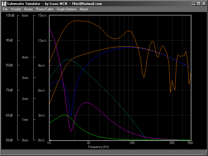

All,
Concerning the peerless 10", I modeled it up and here is what I came up with.
I'm trying to get this to work with the 5dB boost at 30hz, so it will be flat to 30. Since I couldn't figure out how to factor in power with this sim though, I'm not sure if my amp will still work with this driver. I appreciate your suggestions. Thanks,
George
PS. Any good way to add a little bit of boost to the 45hz region? I suspect my friend, who isn't yet into hi-fi, might not like the response as flat as I would.

Wright,
For Q values, have a look at this thread and yes, Vb is the net box volume.
Av is the vent radius while Lv is the vent length. The optimize routine is functional, but only in my personal prototype version -- not yet in the public version. The default input voltage is 2.83Vrms, which is probably/partly why port speed is so low. Increase this input voltage to see if the port is good enough to keep vent noise to a negligible level.
At the time of development, I did not include the option to input amplifier power for educational purposes. 99.999% of audio amplifiers are almost perfect voltage sources; meaning amplifier output voltage is constant regardless of load impedance. Since power = voltage^2 / impedance, and a speaker's impedance varries with frequency, actual applied power is not constant. Despite what a majority of hobbyists think, amplifier power is far from constant across the passband. Therefore, it would have been a bit misleading to let the user specify a constant amplifier power output. While other programs such as LspCAD let the user specify amplifier power, one can notice that the value is merely used to solve for amplifier voltage (prior to calculating system frequency response).
Thanks for the suggestion, you'll be pleased to know that amp EQ (as well as a lot of other features) is already on the features list. T-S parameters measurement is all that's left before I piece everything together.

Votage? Your amp is rated 170 watts into 8 ohms. The Peerless is rated 8 ohms. Under the formula Watts = V²¸R, we find that voltage should equal 37 Volts. That should be our drive voltage.
Below is a graph, at 37 Volts, of the Peerless CC 10", tuned to 27 Hz. The lower right line is the SPL without room gain, the upper white line is the SPL with room gain, and the purple line is the cone excursion.
As we can see, under full power we are living somewhat dangerously with cone excursion, (purple line), in the 42 Hz range. Max linear excursion is 9 mm. There should be extra in the non-linear range-but 15 mm might be coming fairly close to the limit, if it doesn't exceed it.
But take a look at the output, even without room gain. 108 dB @ 30 Hz. 112 dB with room gain. Pretty good for a single $54 woofer and a 2 Ft³ box.
You might want to forget the boost at 30 Hz. And if your friend's system has an equalizer, you might want him to back it off slightly at 40 Hz setting just to give the woofer a little more headroom at 42 Hz, where excursion is highest. You are already up to 112 dB without room gain in that range anyway, so you can afford to reduce things a couple of dB.
