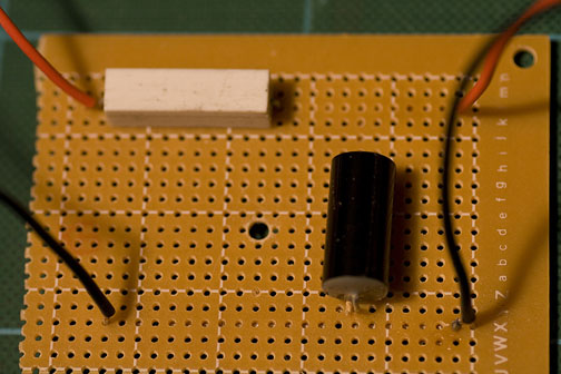

I've just completed a new sub but can't get the low pass filter to work. The filter is made from a 2K7 5W resister and 1uF 250V cap. The drivers are 2 Eastech 7".
Have I got the wrong components or have I done something wrong in soldering it up?

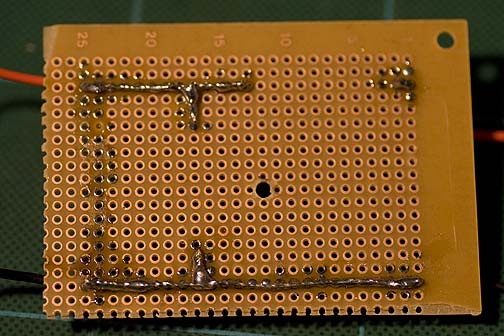

Here's the bottom. The soldering is pretty sloppy. Could that be the problem.
I forgot to add that the speakers work fine without the filters. With the filters there is almost no sound at all.

Do you connect this filter between amp and woofer?
If so, the 2k7 resistor is eating up almost all of the driving voltage, thus no sound.
Such RC 1st order filter should be used in line level circuit. However the combinations of the components are not 'normal', either.
Where did you get this circuit?
what is the source impedance feeding the filter?
What is the load impedance that the filter is feeding?
For a normal filter, Rs is assumed to be zero and Rload is assumed to be infinity.
I'll assume this just for the sake of calculation.
F-3dB = 1/2/Pi/R/C=1/2/3.14159/2700/1/10^-6=59Hz. = a low pass filter.
But, if the load impedance is an 8ohm speaker, F-3dB becomes 20kHz.
Yes, it appears to pass everything but now you have an attenuator to account for 8ohm and 2k7. That is about -50dB. You would have to increase the power amp from 50W to ~17kW to get the same volume out of the speaker. And 16.95kW would be dissipated in the 2k7 resistor.:hot: :hot: :hot:

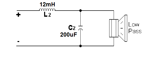

Forget about resistors. You need a big inductor (coil) and a capacitor.
Below is a low pass filter. 100Hz at ~4 ohm load.

Ah! that's why it wasn't working.
I have tried a couple combinations of the inductors and caps I have at hand. Right now I'm liking the combination of a .15mh inductor and 4.7 cap. I'm still trying to understand how these things work.
Should I be using larger inductors and caps?
