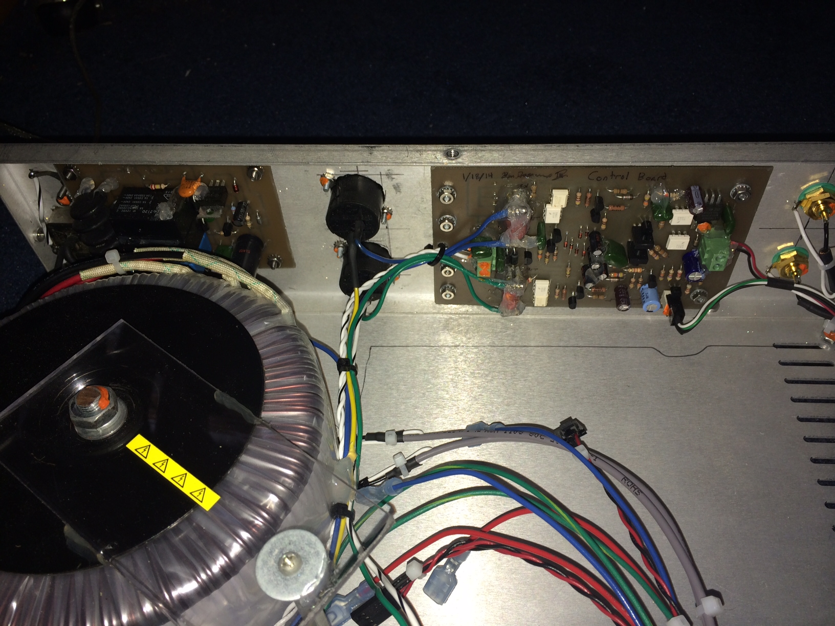

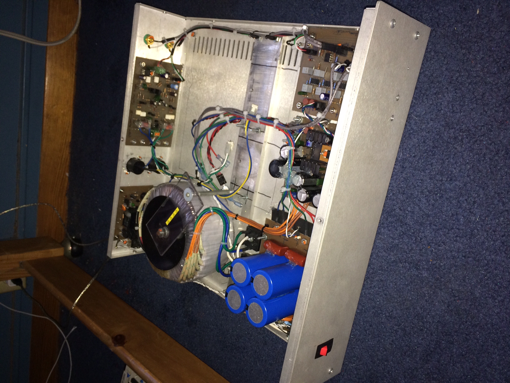

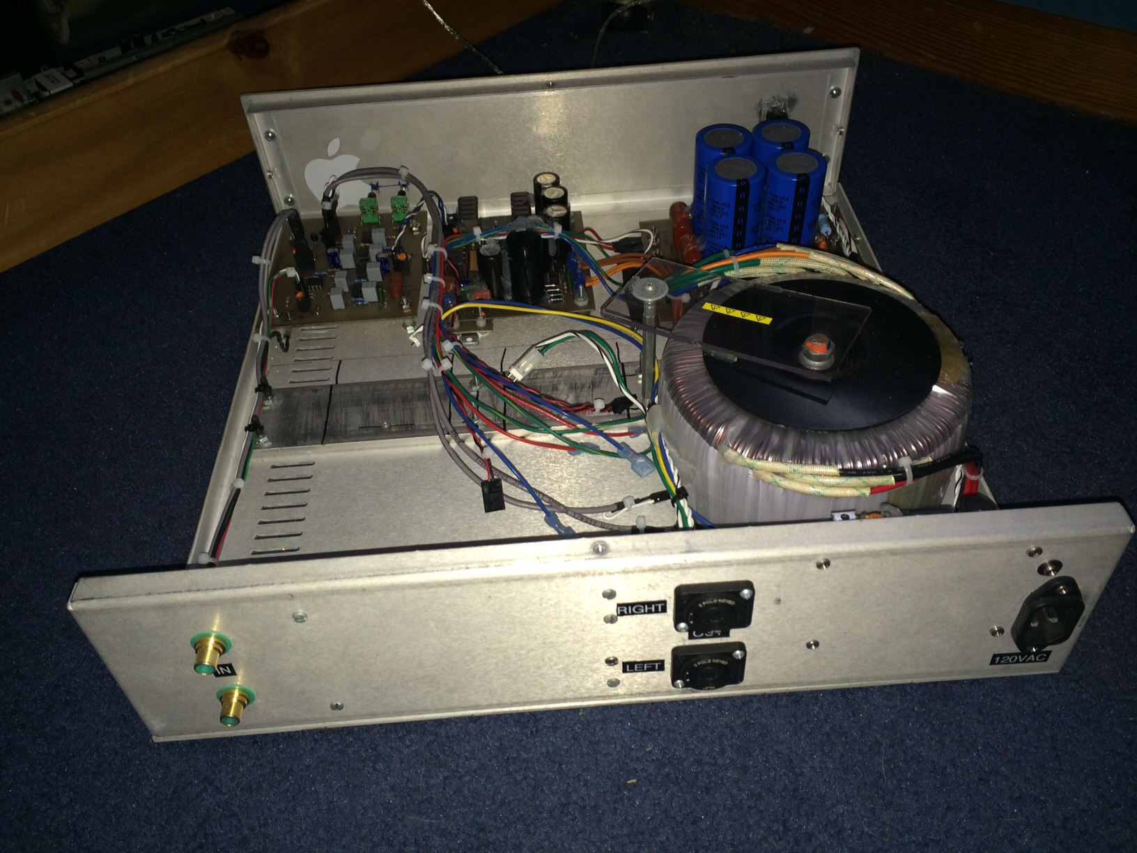

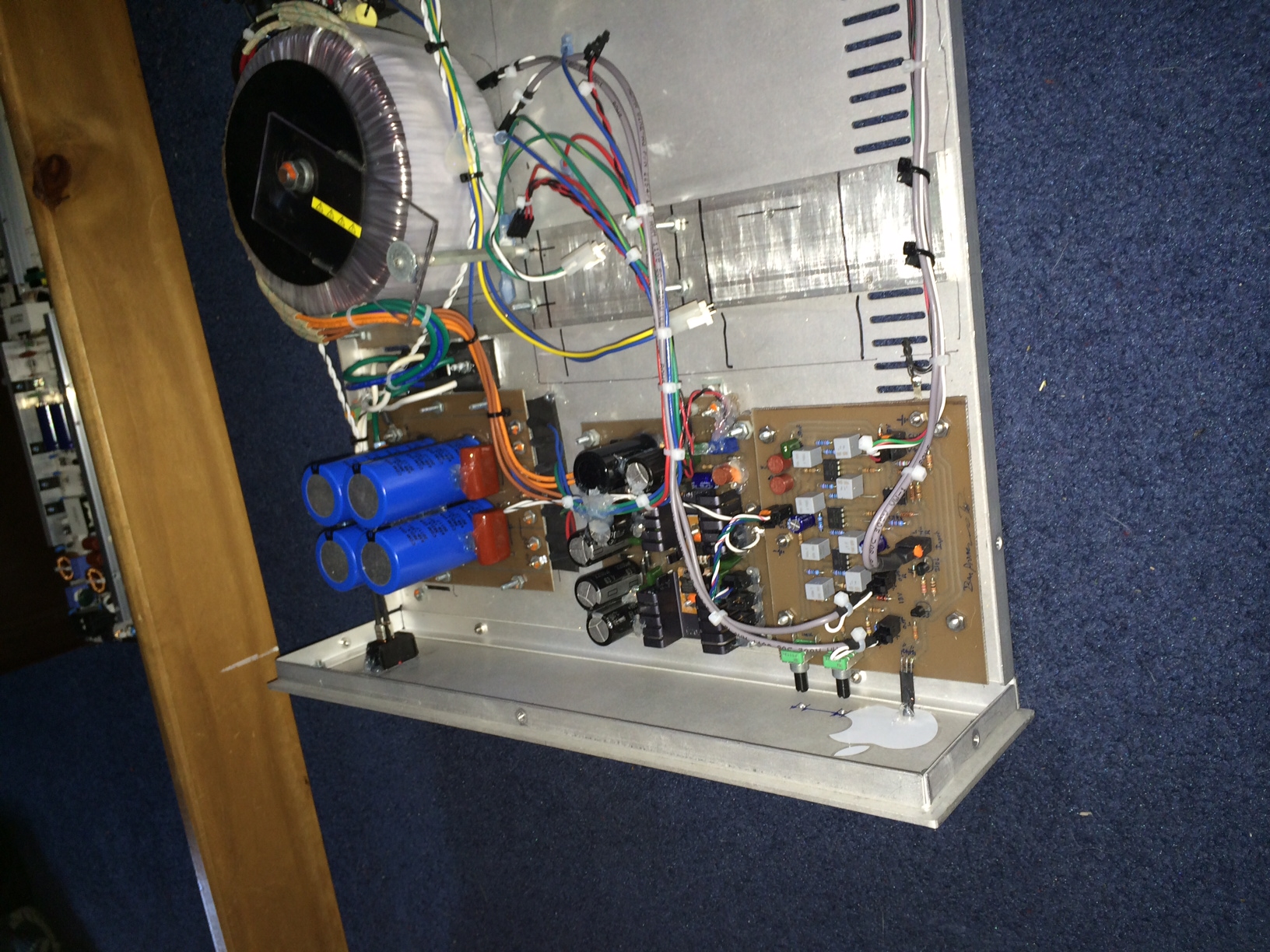

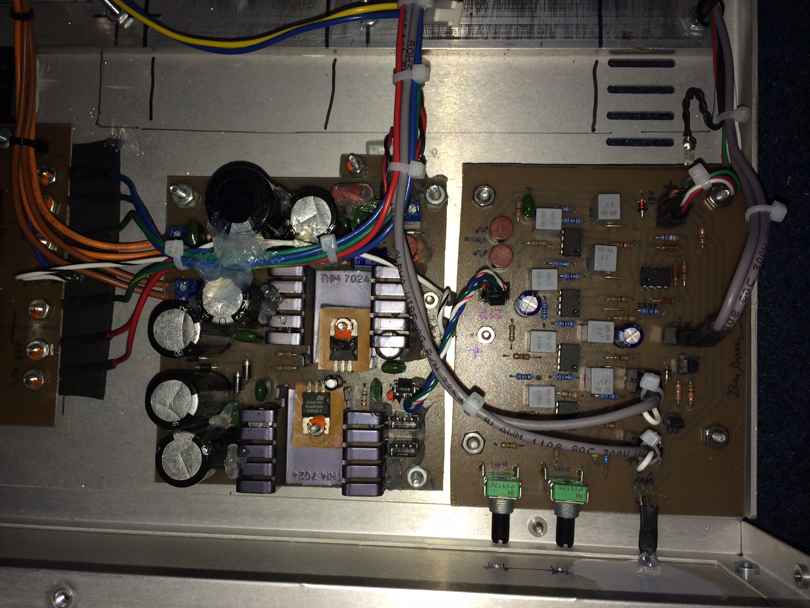

Inside the chassis now is the protection board (mosfet relay based), the soft start using MOV's, the capacitor bank and rectifiers, low current power supply (+/- 15V and 12V for the bias, and the 24db 100Hz low pass filter.
