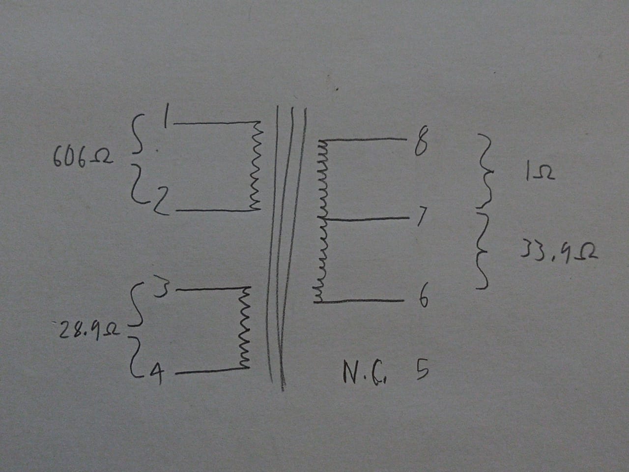

Please see the attached image for the OPT pinout. Please note it is DC resistance that is measured.
The primary (pin 1 & 2) in the image are connected like they are in the circuit diagram.
Pin 8 is connected to loudspeaker positive. Pin 7 is connected to loudspeaker negative and common ground. Pin 6 is connected to the feedback loop.
Apologies for not including this in the circuit diagram.
EDIT: Pins 3 and 4 are currently unused. I'm really not sure what it was used for.

Do you know the type of Philips radiogram the OPT came from?
Big chance that winding 3-4 is an anti-hum provision. Philips used that a lot. You can just leave it unused.

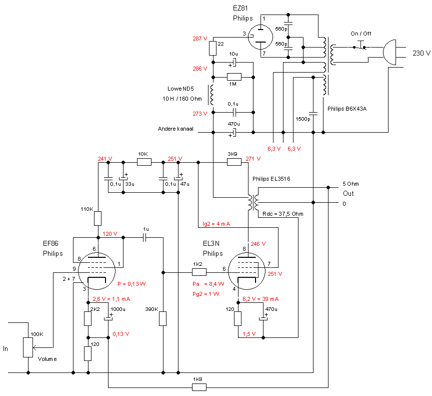

As for the secondary: It could be suited for cathode feedback applied to the power stage, with 7 earthed and 6 going to the cathode resistor of the power stage. The resistance you measured (33.9 Ohm) fits this. I think that in your amplifier it's better to take the negative feedback from 8 and leave 7 earthed (so 6 would be not connected to anything). The speaker still stays connected between 8 and 7. If this arrangement leads to oscillating, then reverse the earthing and the feedback connection (or reverse 1 and 2).
Attached an example of an OPT with cathode feedback and negative feedback over the whole amplifier (I made it some time ago with a Philips OPT; the anti-hum provision is also used in it).
As for the 4K7: Just try it first with the 4K7. If you experience problems (at higher input levels) than maybe it's wise to make some changes.

Reproduce the original circuit with just 4 connections to the output transformer. Primary on 1 and 2 and outputs from 7 and 8. If you keep 7 as the ground, make sure 1 goes to the pentode section anode (pin 6). You will have to 'work out' the feed back resistor values later. That will need to come off 8 of the output transformer eventually.
As has been mentioned, the 3 and 4 winding originally fed the screens and triode section, best left alone for now...

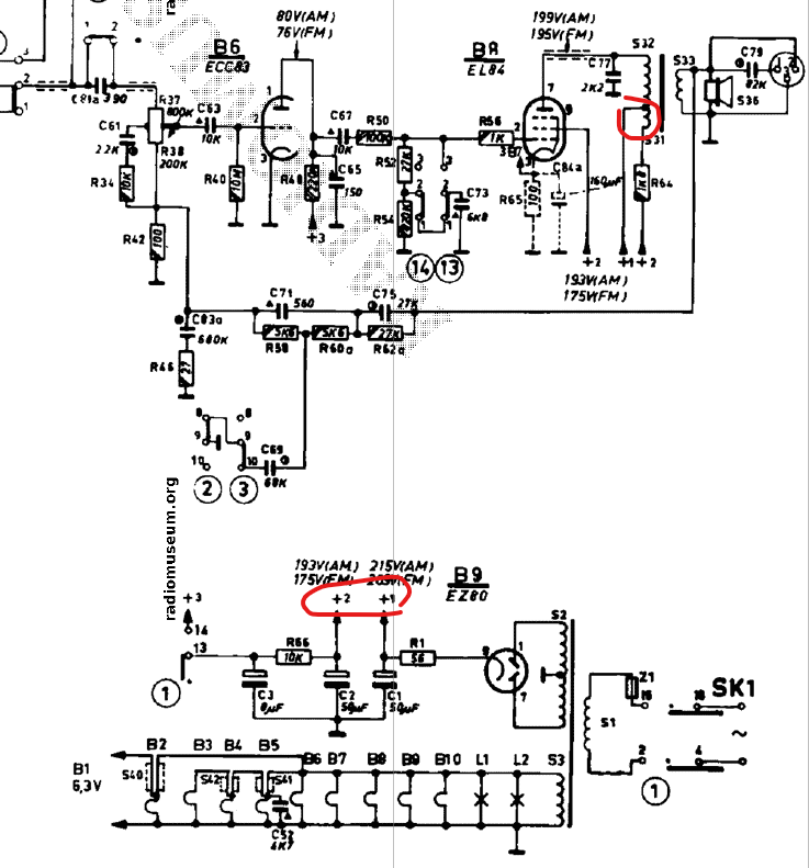

The transformer looks like it is one with a tap which I think made part of the winding into a choke, as in this portion of the schema from a B5X23A.
EDIT: I see that there are comments for that now, but here is a bit if a schematic anyway.
